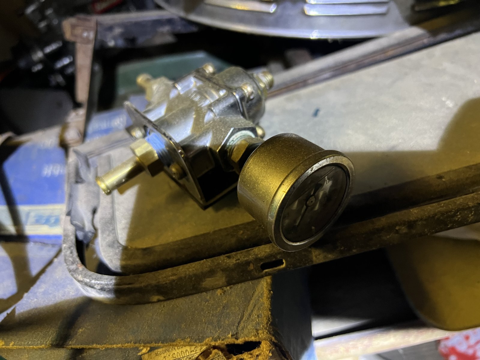

  8. hot4hotrods
    Joined: Apr 13, 2009
    Posts: 220
    hot4hotrods
    from U.K
    Whats the in and out on these? Is the in opposite the adjuster? Or the gauge?
  9. 427 sleeper
    Joined: Mar 8, 2017
    Posts: 3,438
    427 sleeper
    Adjusting screw on top, inlet on the bottom.
  10. hot4hotrods
    Posts: 220
    hot4hotrods
    from U.K
    Aaah thanks..i just bought one. Are they ok to use with a standard mechanical pump? Do they have to be mounted a certain way up?
  11. 427 sleeper
    Joined: Mar 8, 2017
    Posts: 3,438
    427 sleeper
    Yes, they're fine with a mechanical pump or electric pump. Mount with the adjustment screw up and the inlet at the bottom.
  12. hot4hotrods
    Posts: 220
    hot4hotrods
    from U.K
    So installed a Holly 803 pressure regulator, but Still cannot get a reading on the gauge with regards to fuel pressure. Nothing at all. Its an oil filled gauge. The car runs ok.
    I Set the initial timing at 7 degrees, taking the engine up to 2800 rpm and advancing the light to get 0 at TDC, timing light is reading 26 degree of total. I'd put the lighter springs in the distributor to get a bit more total advance but cannot undo the screws holding the rotor arm down. They've been tightened up by The Hulk i think. Unless they have nuts on the underside?
    I had it set at 9 initial and was getting 28 total , this made it run a little on the warm side.
  13. 427 sleeper
    Joined: Mar 8, 2017
    Posts: 3,438
    427 sleeper
    Lighter springs won't give you any more advance, they'll just give you the advance sooner. Still no pressure reading? Sounds like a fuel delivery issue. Have you done a pressure/volume check with the line pumping directly into an empty jug to see how it's pumping?

  14. hot4hotrods
    Posts: 220
    hot4hotrods
    from U.K
    Hi, nope, not tried that. However, when I havent tightened up the fuel hoses properly whilst playing around with it, and I have started it up, it runs ok, but with even the slightest gaps where the connectioms arent quite tight enough, I get m***ive amounts of fuel ******* out. So there is plenty pumping through
