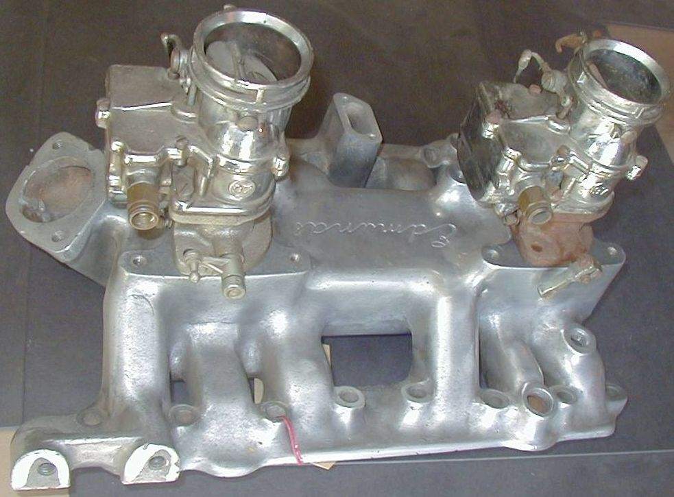

  14. Corn Fed
    Joined: May 16, 2002
    Posts: 3,441
    Corn Fed
    The Edmunds for my Desoto has that base too. I have a pair of orginal carbs, but am more of a '97 guy so will probably use those with some adapters. Here's a pic of my manifold with some 97's just set on there.

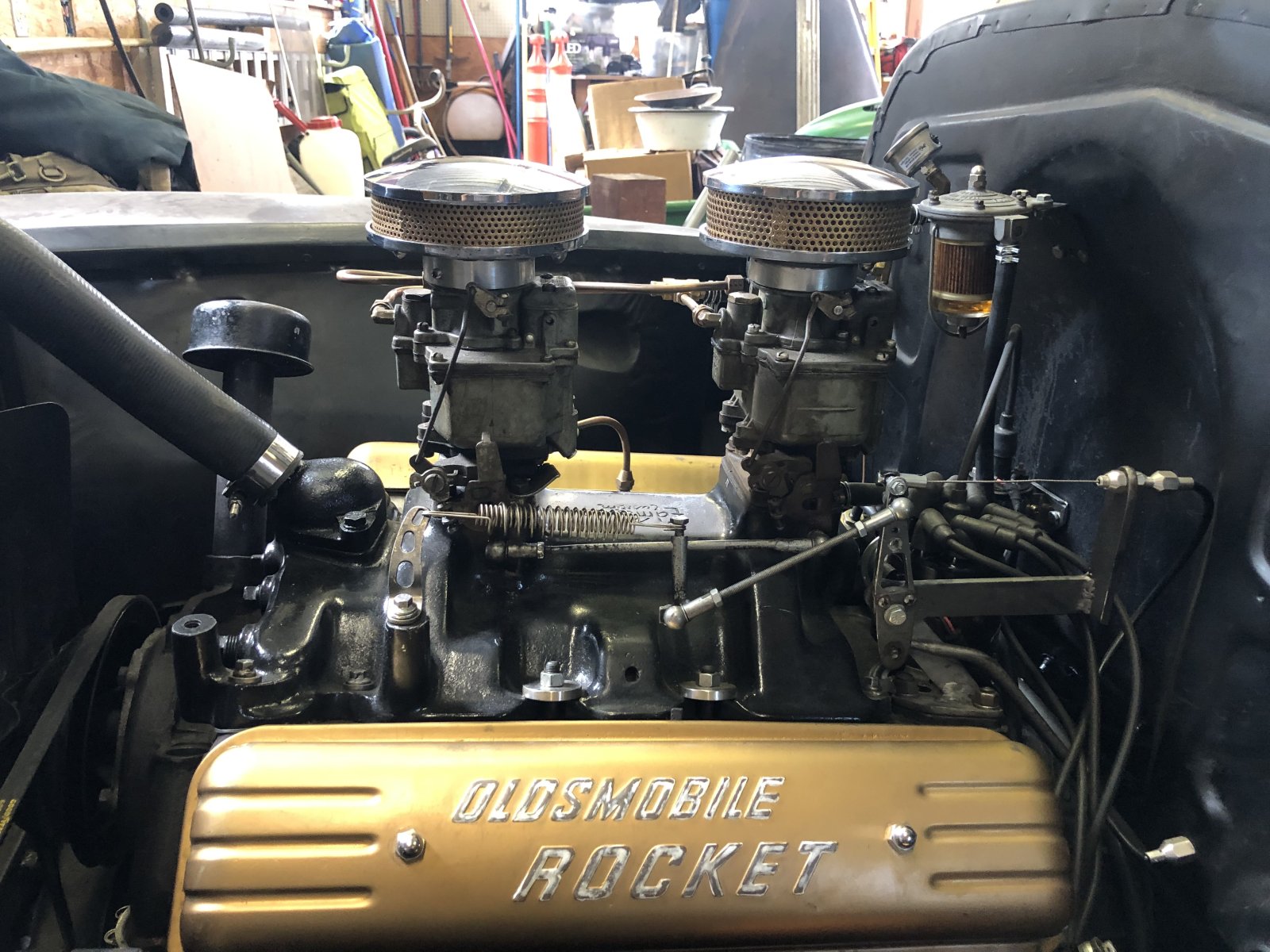

  20. skooch
    Joined: Feb 7, 2007
    Posts: 781
    skooch
    Attached is a pick of my Edmund’s Oldsmobile intake with Carter wcd’s which is what these manifolds were designed for. You can see the difference in the bolt spacing between this and what 36dodgeram posted so be aware when of this when making your purchase.
