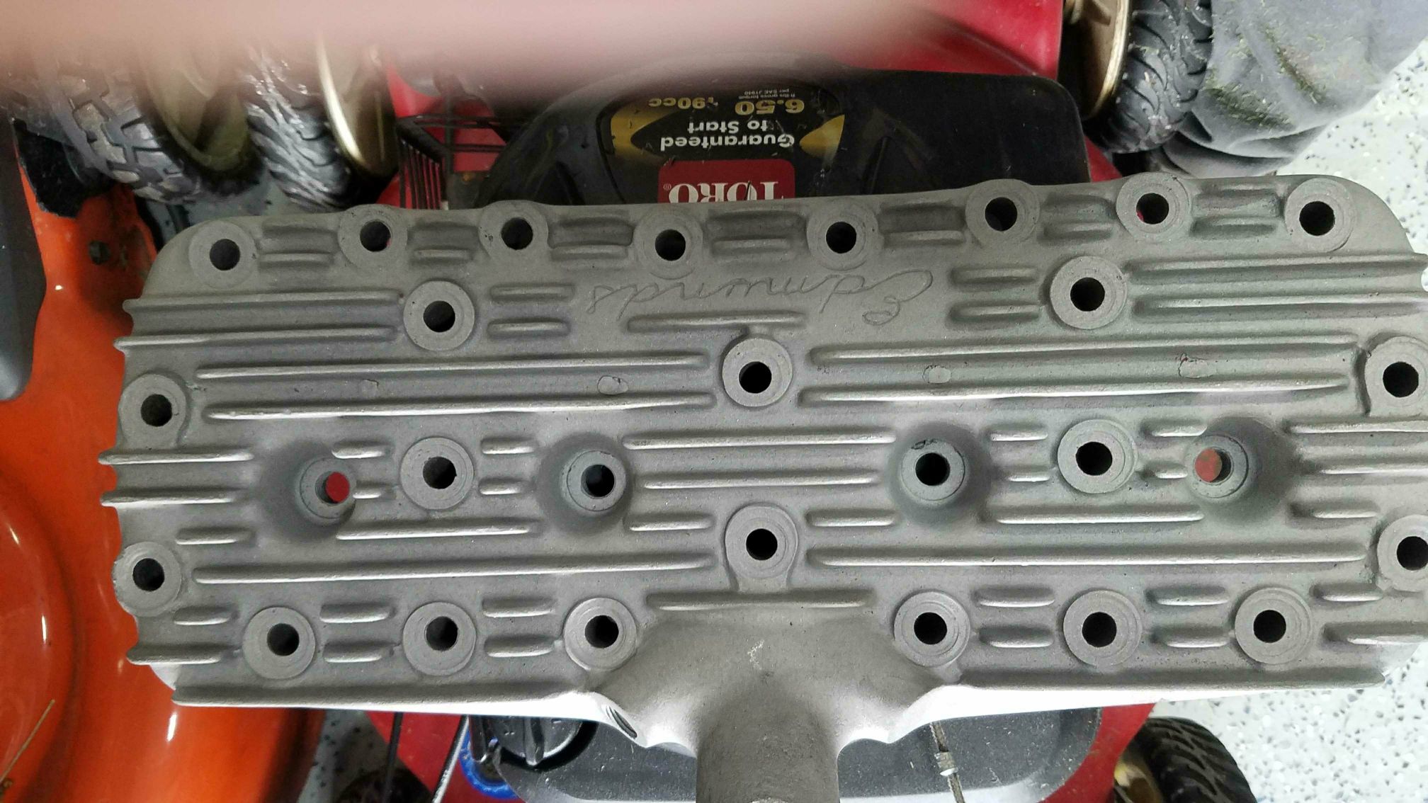

    Can someone tell me some information about these aluminum flathead I got today?[​IMG][​IMG]

    What do you want to know about them?

    Looks like a good score.

    The heads you have are for the early 59A flat heads but you do not have a matching pair of heads. I believe the head with the Edmunds script at the bottom of the head was cast earlier than the head with the Edmunds Custom embossed on it. You have a mismatched pair of heads and the compression ratios could be different on each one. Your heads appear to be in excellent condition.

    I'll add this only because I am an 8BA guy and I have no knowledge of the earlier heads, but it might apply. I really like the Edmunds 8BA heads because the spark plug is relocated just enough so that it is not over the exhaust valves. This allows you to run extended tip plugs in a flathead. I have a set of Edmunds 8BA heads on my '51 Merc engine. I spent a bit of time having the heads milled and the modifying the combustion chambers to ensure that the "squish" was between .040 and .050 to ensure the most power and fuel efficiency. The engine has 180 lbs compression on the gauge and runs great. If you can find a usable set, I believe they are the best heads for an 8BA. (I know, I know that there are some that may be better out there, but I am not into $1200 heads).
    I'd mock up the engine and see if the spark plugs in your heads have a similar relocation. I hope your heads are usable (a lot are not, having corrosion, and milling issues). I hope you got lucky. I know I did, a couple of times.
    Oh, and "Mr48Chev", Charlie Price is not "the guy who built them". He just happens to have gotten possession of the "Edmunds" name. I would advise anyone who has an interest in this to do a search on here for "Vintage Speed".

    Oh, and by the way, after the amount of time I had to put into my heads to get them where I wanted, I wouldn't give up on yours without doing an in depth ****ysis (measuring combustion chamber volume and clearances). They may be able to made to work together fine. Then all you would have to deal with is if you want to run a set of "mismatched" heads. (I kinda like the idea!)
    I do this with all the flathead heads I use, even the new ones.
