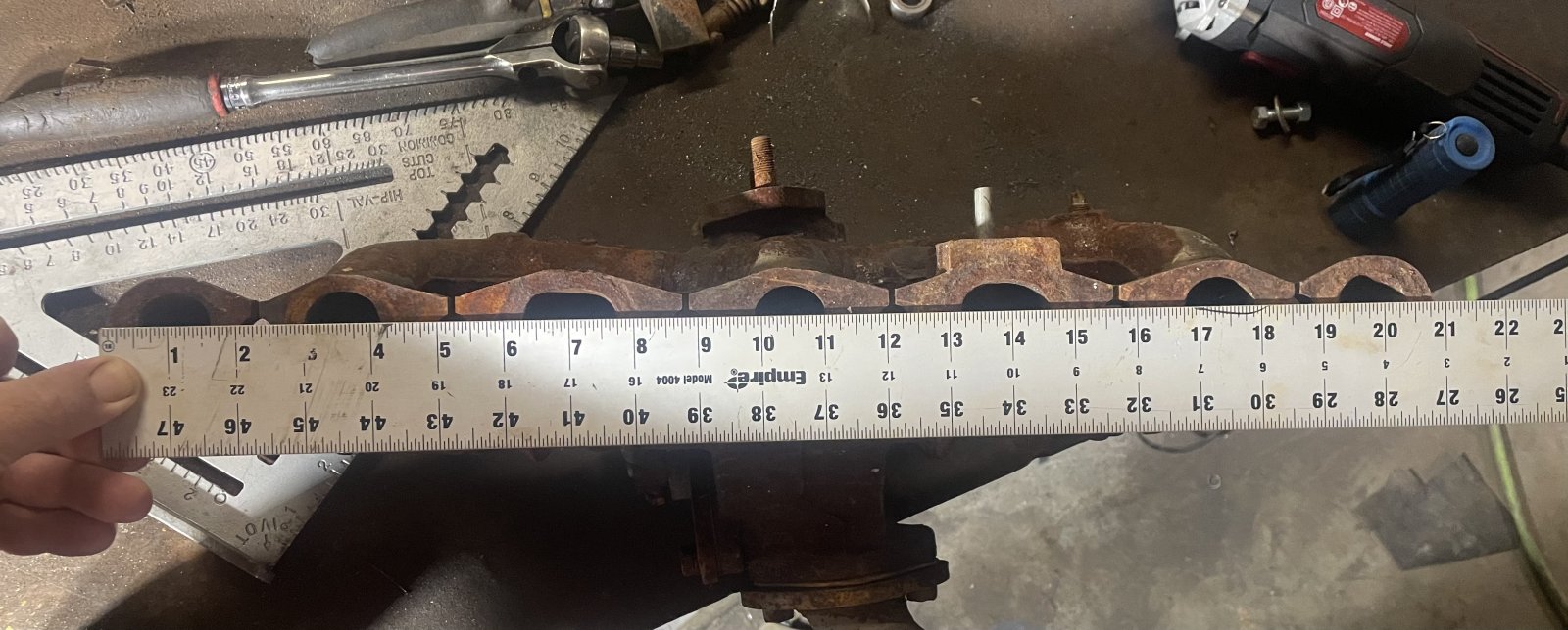

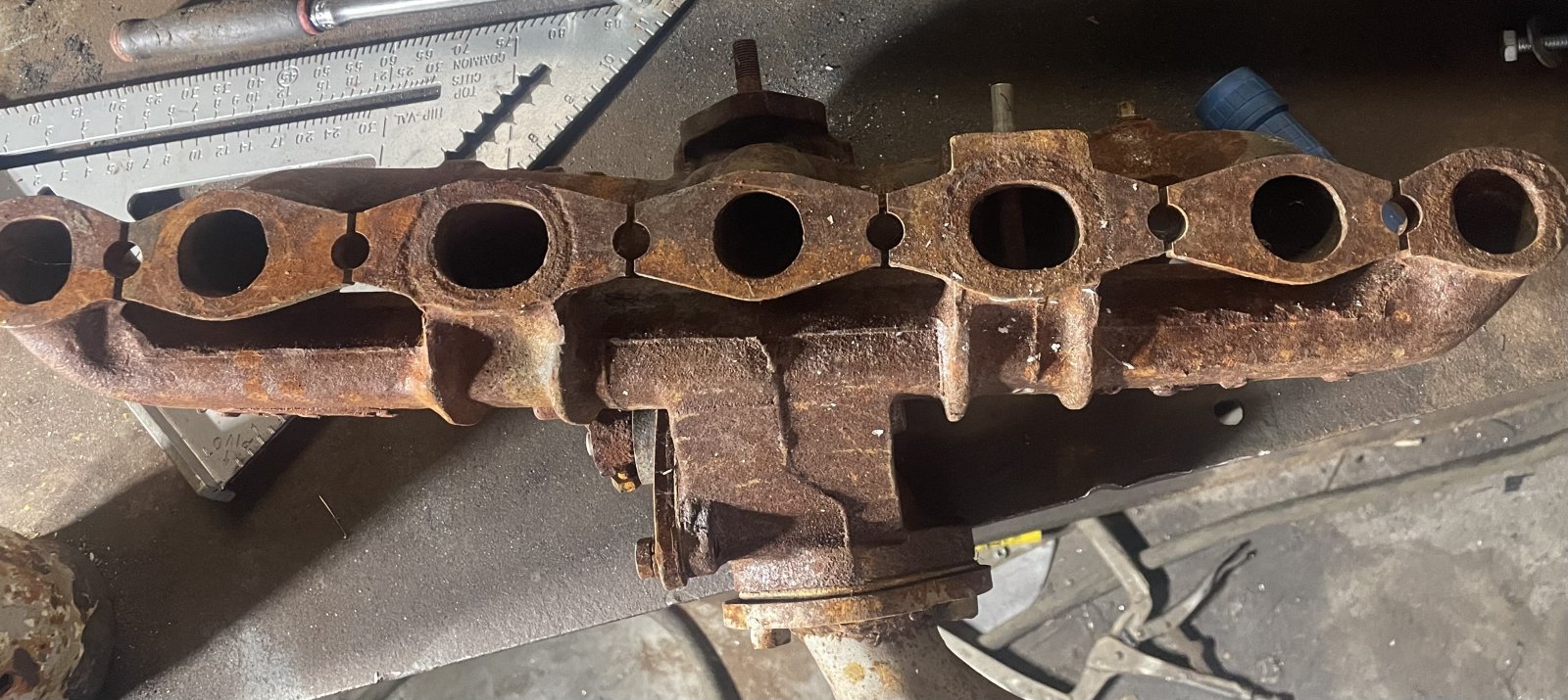

    Looking to identify this intake. The port centers on the end two are 14". The overall spread on the 2 end mounting holes is 16 -1/2", carb centers are 7". Thanks in advance. IMG_9826.JPG IMG_9827.JPG IMG_9828.JPG IMG_9830.JPG
  2. Looks like a 216 Chevy
    Fortunateson and Bob Lowry like this.
  3. MCjim
    Joined: Jun 4, 2006
    Posts: 1,385
    MCjim
    from soCal
    Is that an International Harvester logo on the bottom...?
  4. El Mirage Garage
    Joined: May 26, 2021
    Posts: 144
    El Mirage Garage
    If I were to guess I’d say maybe for an in-line six of British origin. But, did Edmunds make intakes for foreign cars?…I would guess No.
  5. HEATHEN
    Joined: Nov 22, 2005
    Posts: 9,061
    HEATHEN
    from SIDNEY, NY
    Not Chevrolet. Could be for an Oldsmobile flathead six. They had the offset mounting ears like that. As short as it is, another possibility is Studebaker Champion.

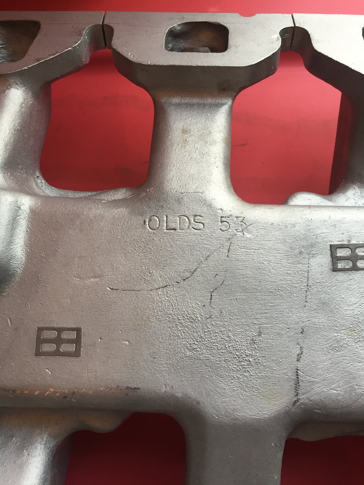

    clean the bottom real well, they are usually stamped with what they fit, may be faint and hard to read though D398C7AE-B3A6-4D31-B95D-B03B19B625D9.jpeg AA04872D-5700-4AED-B2C0-12417E49B15C.jpeg

    Here ya go! Stude Champ flathead six. 1-Edmunds Studebaker Champion FH 6.jpg

  9. OE stude champion intake/exhaust
    1D931A61-F352-433C-8A9C-55187758B22C.jpeg A5367918-8A8F-4B3C-BB9A-28B045F0CF0D.jpeg AE0E8E1D-38D4-4719-9815-E2DBCD39E7C8.jpeg

    Thank You, I will p*** on the info.
