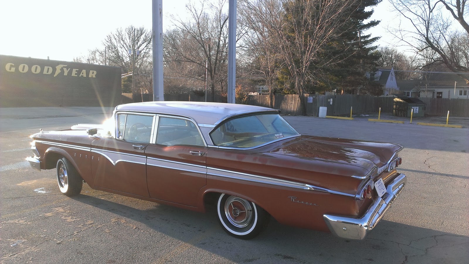

    I'm getting ready to start diagnosing a squeaking sound that's been coming from my front suspension that past couple of months. I've got a '59 Edsel Ranger 4 dr sedan with a 361 and 3 spd auto. The car is all-original, with no modifications whatsoever. I got it from the original owners, but I don't have any info on what suspension work (if any) was done prior to me owning the car. It looks like the tie rods were replaced recently, due to their shininess and fresh rubber that's attached to them, but other than that, the rest of the suspension looks original.
    My question is, where do I start in diagnosing this squeak? The car still floats down the highway and take bumps with ease, but I'd rather do it with no noise. Any help or advice would be appreciated.
    Thanks!

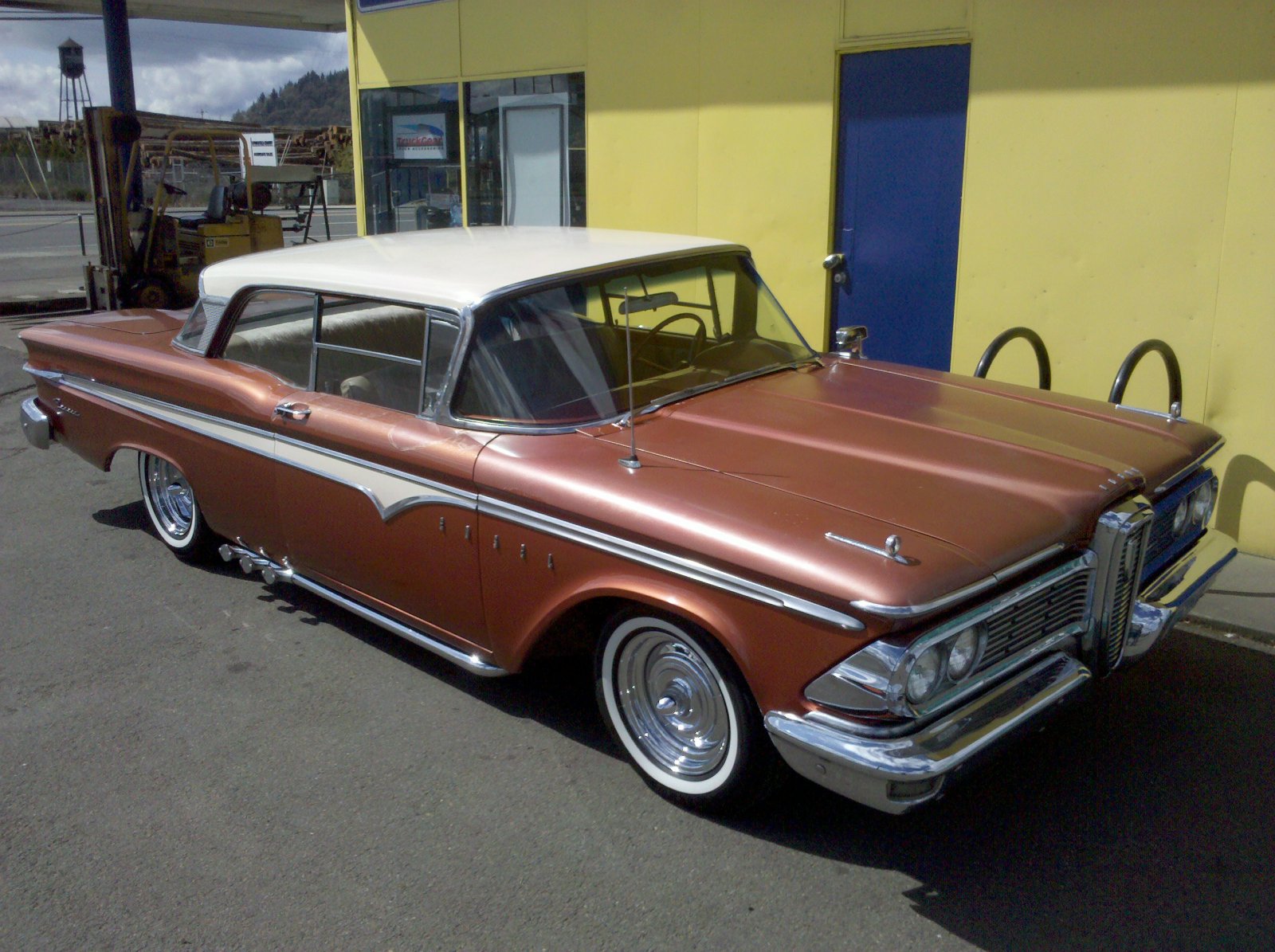

    Beautiful car. I daily drove my 59 Ranger for a good 3 years.

    Nice sidepipes! That's a great looking car. I really enjoy driving her and don't intend on getting rid of her. I'm stuck with her!
