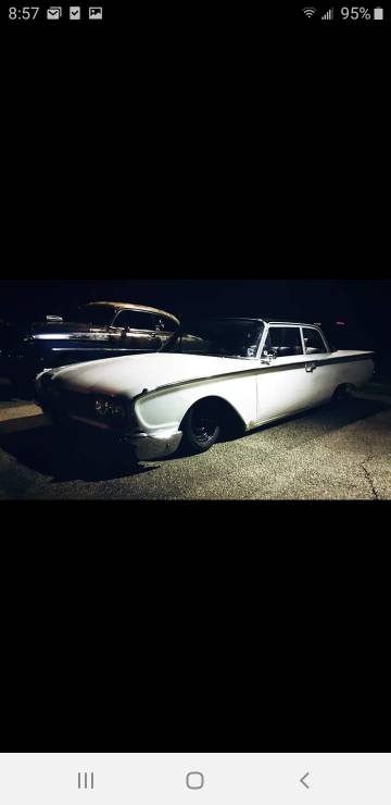

    This is some 60 Ford. It is running 195/65r15 on front and 215/70r15 on back on 15x8 wheels Screenshot_20200405-085722_Facebook.jpeg
