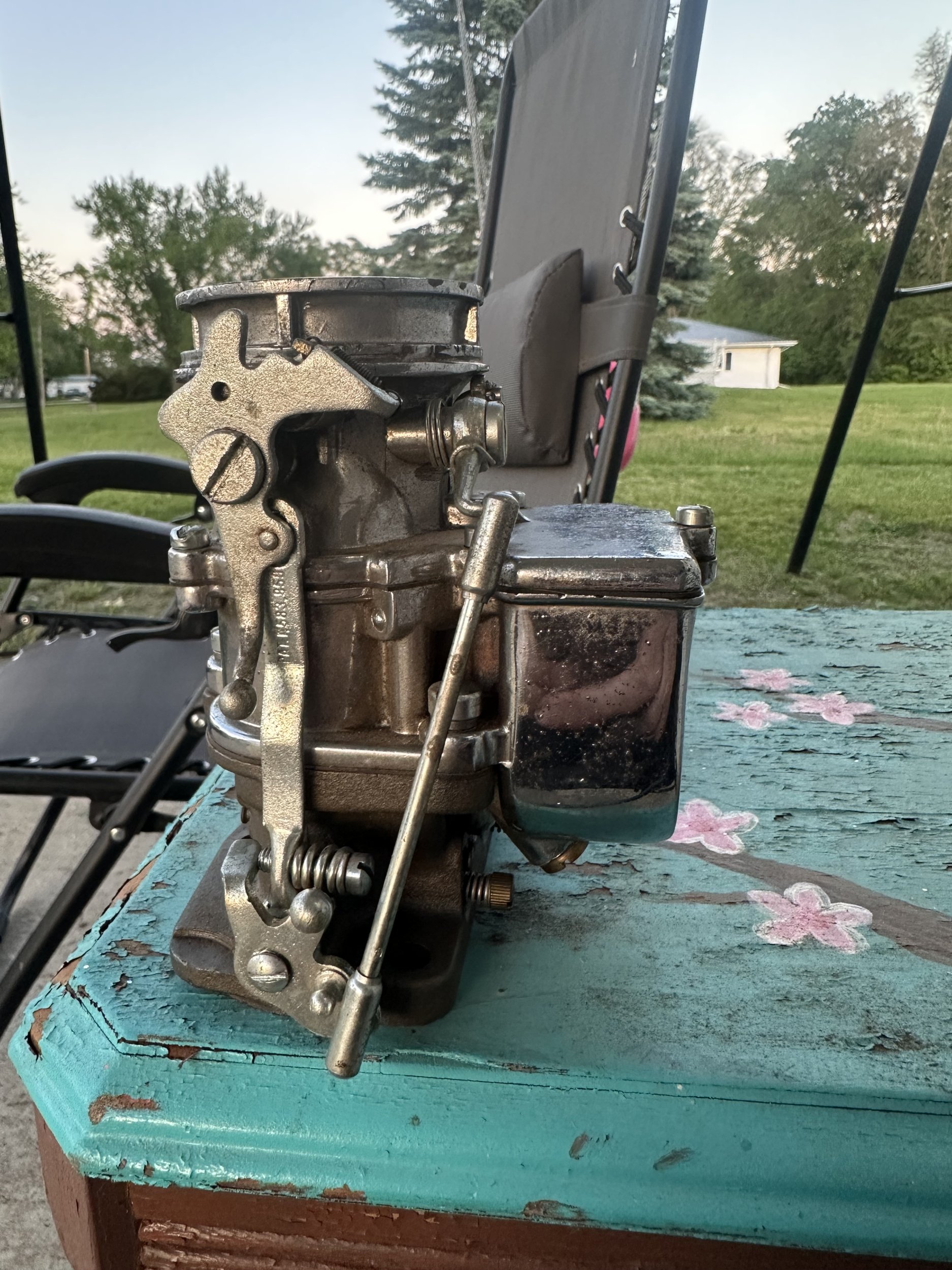

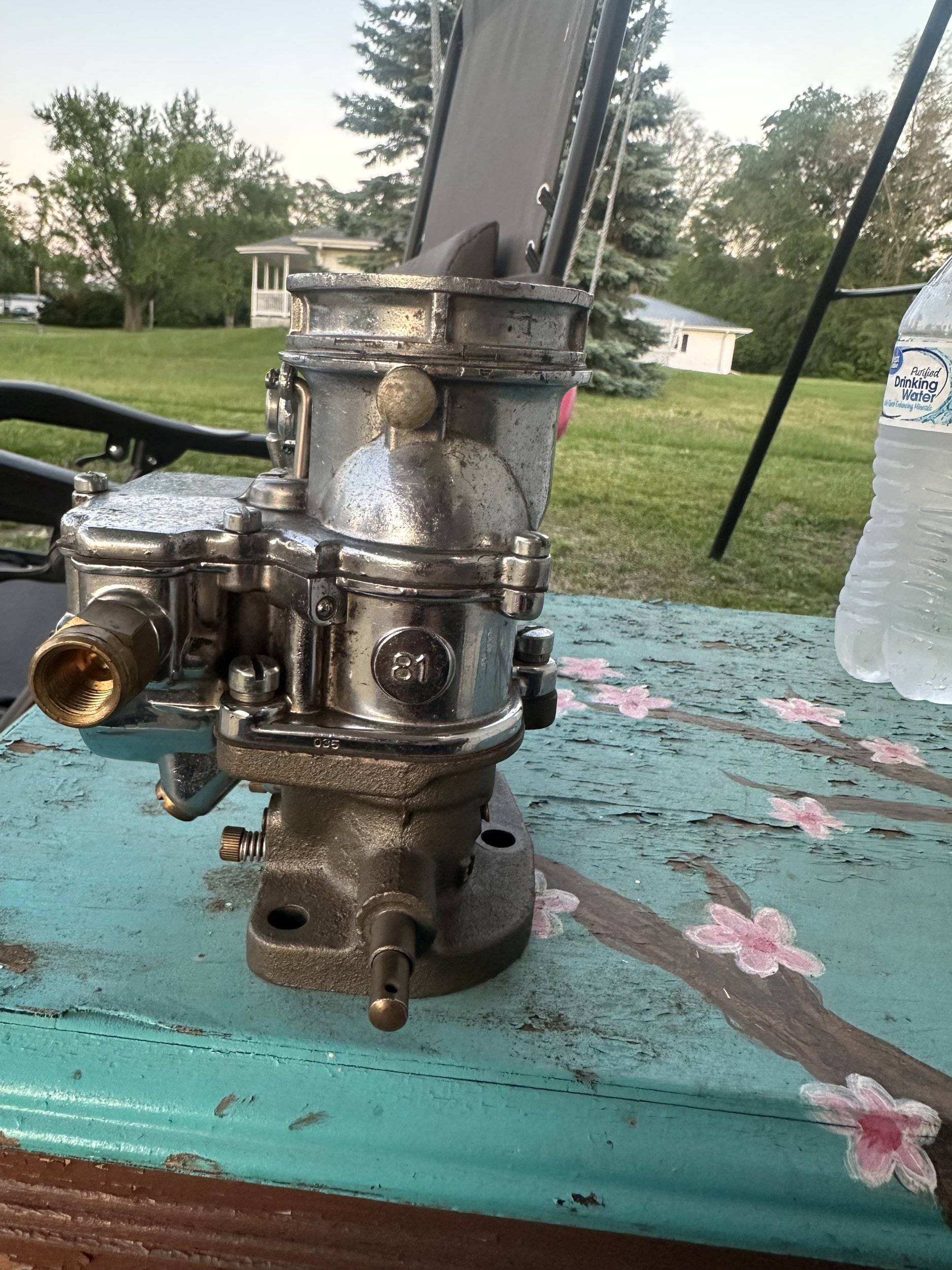

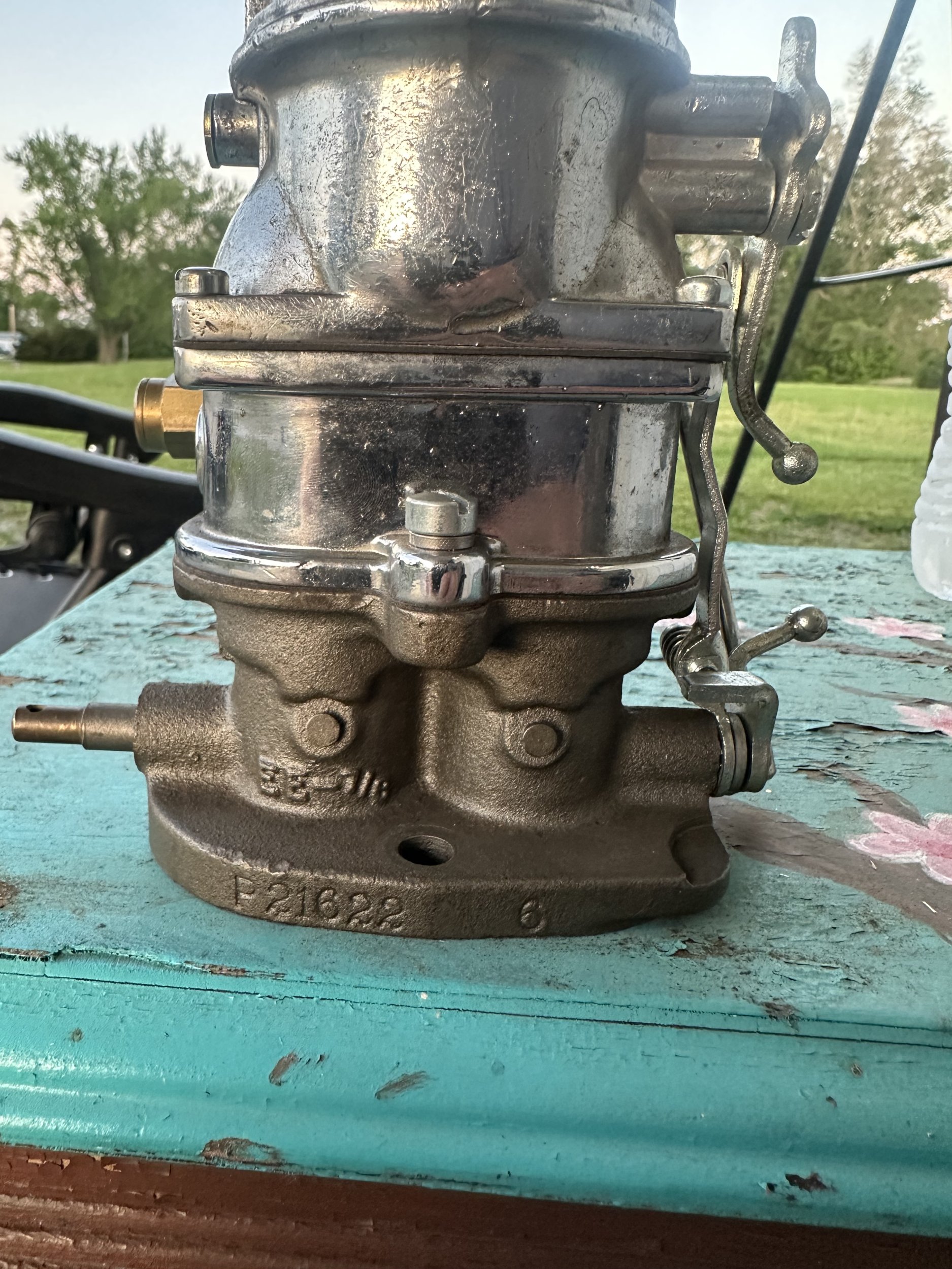

  1. Ok fellas I picked this carb up local to me, but honestly I’m under educated. It appears to be old chrome the only marking on the carb is 81.the base plate says EE-7/8 also marked P21622 and also a 6. I would have thought it would have been marked Stromberg like others I’ve seen. I’m trying to set up and 81 for a Winfield down draft intake I have. Hoping to mate this to a B motor.

    The Stromberg info cast into the side of the bowl on the opposite side of the "81" looks like it was sanded off before chroming.

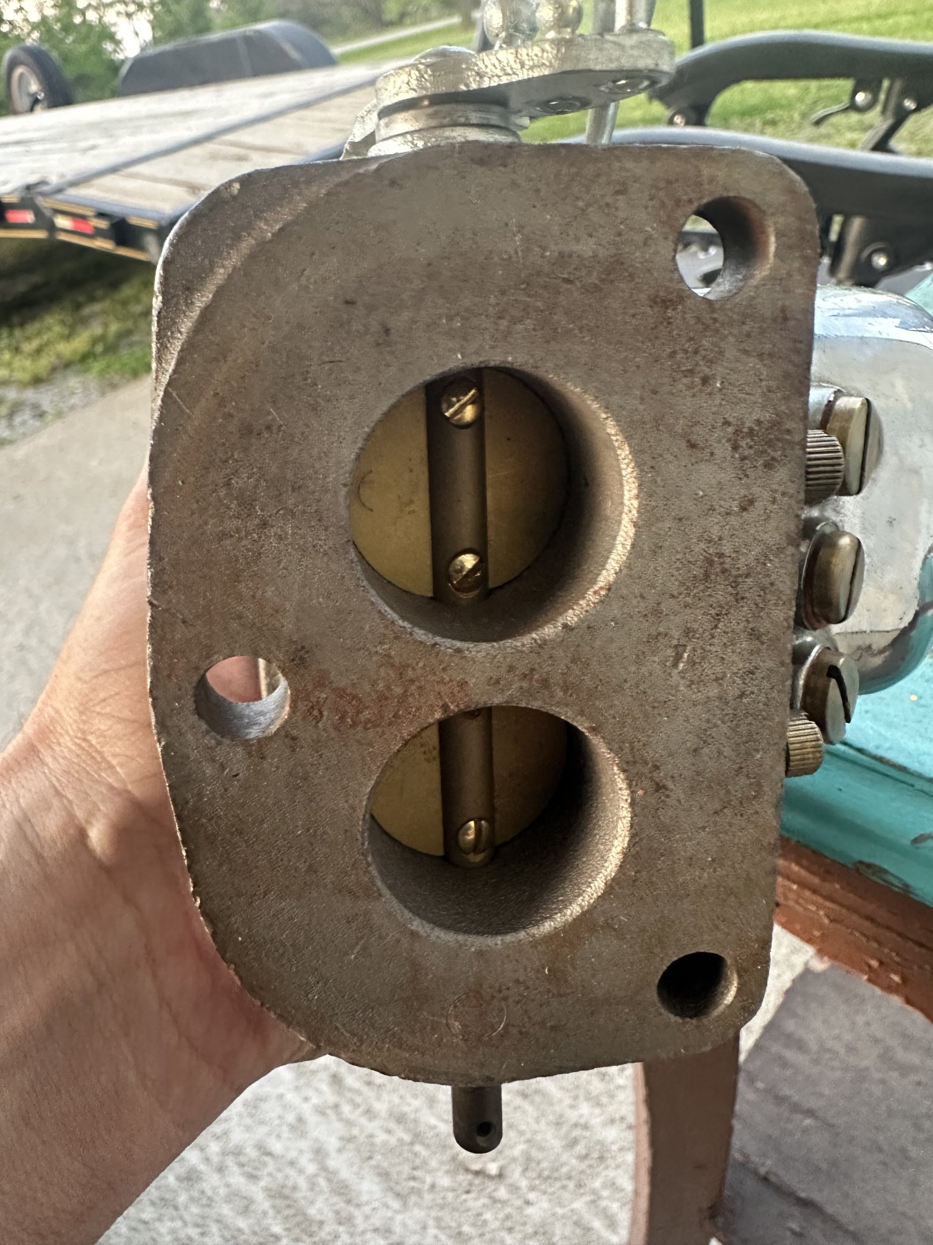

    Your carb has a replacement throttle shaft and looks like new fasteners in the carb base. Someone has gone through it by the looks of it. I would try bolting it on and running it. If you have issues check the jet and power valve sizes first, then learn how, or find someone to pull the emulsion tubes. If the small holes on the top of the emulsion tubes are anything other than perfectly round replace them. That's about all there is to it. Several good how-to's on YouTube if you like to fiddle with your own stuff.

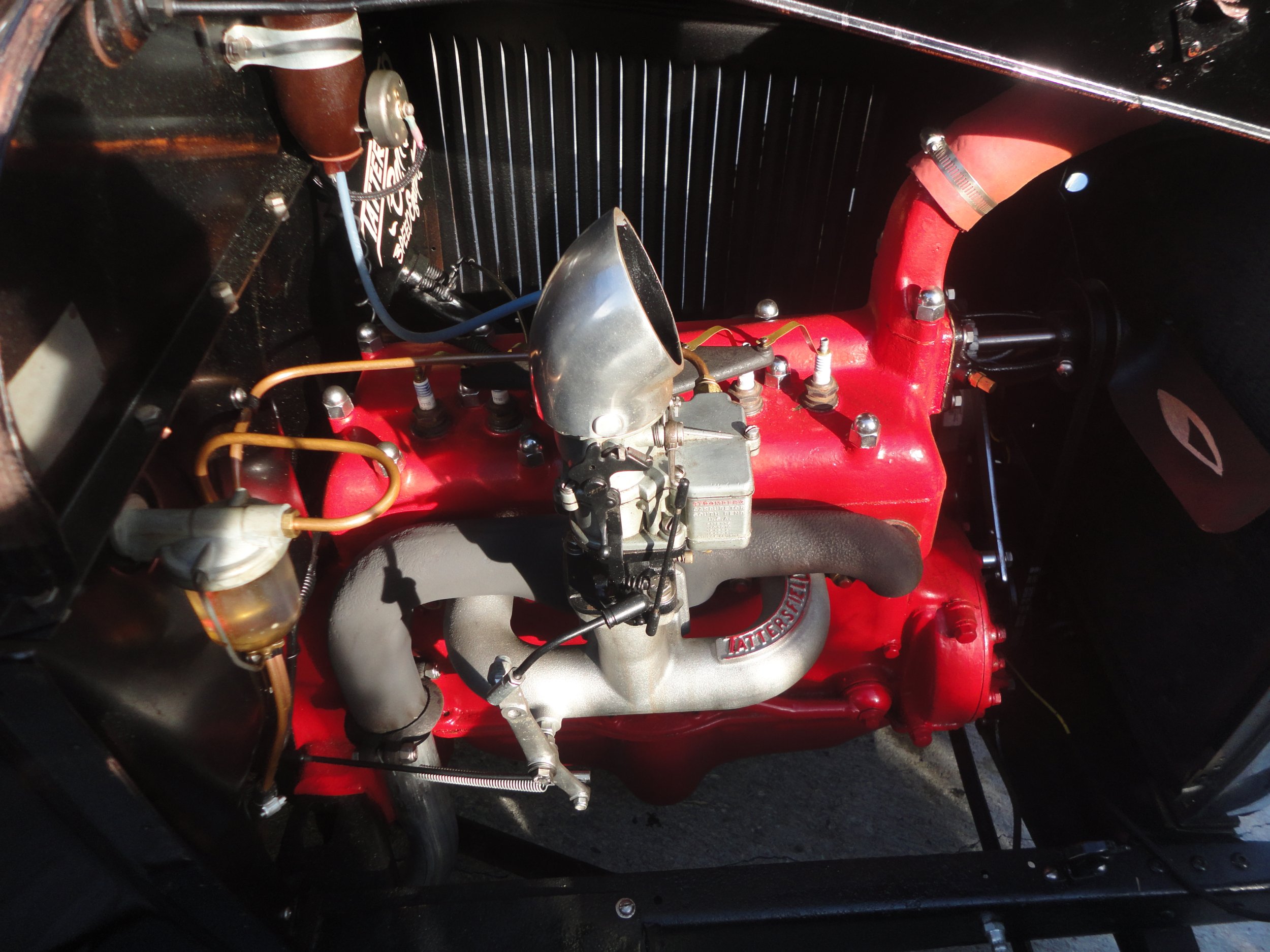

    I'm running a single a 81 with a Tattersfield down draft intake and an electric fuel pump.Runs good. banger.JPG

    I run two on my B ohv conversions, one 97 on the B flathead the 7/8 means that you have an 81 base too ....many got swapped out with the 97 that is marked 1 for one inch

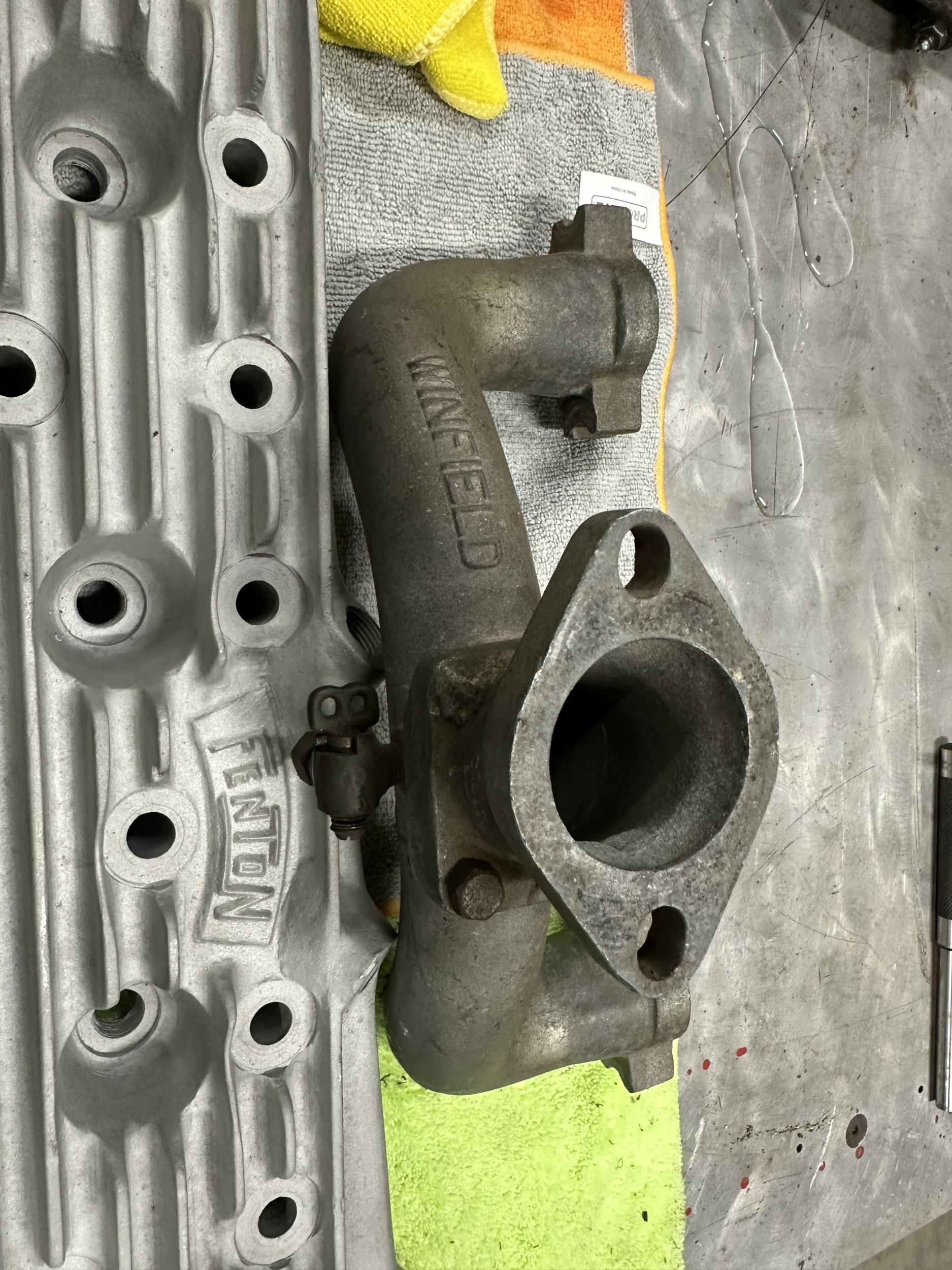

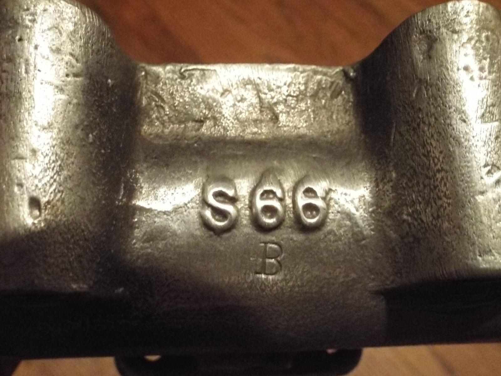

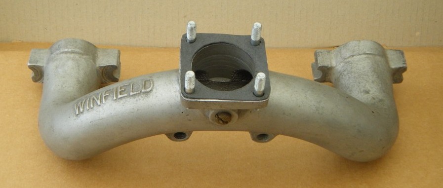

    If you have a Winfield intake the Stromberg won't fit. Winfield carbs had a square base. I've seen some adapters but they were for stock 2 bolt manifold to 4 bolt - not for the Stromberg. The Winfield intake will have which carb it fits stamped on the bottom A, AA, B, BB, etc. Of course someone may have created an intake for a Stromberg that says Winfield. If you do have a Winfield intake sell it ($300-600) and buy one for the Stromberg. Or junk the Stromberg and get a Winfield carb ($700-1,000)
    DSCF2980.jpeg intake s66 b.JPG y

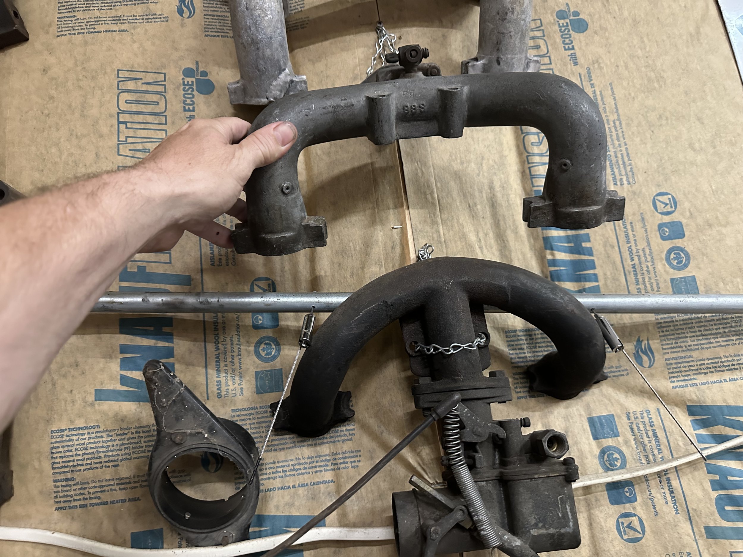

  18. I do have a Winfield intake and the ultimate goal would be to have a Winfield carb! I think mine is an SR-BB. Wasn’t sure but thought there would be a Winfield to ford/stromberg 3 bolt adapter? I do know a guy that has some experience in a machine shop! Maybe a little design time program it and go!

    I may have miss spoke its marked S and BB. Would be fun to design and build an adapter. Could be more fun than the day to day stuff!

  20. It would be quite easy to design a 4-bolt to Stromberg adapter . . . though I'm sure there has to be one made in the past. If you have CAD and CNC capabilities, would not take too long!
  21. Yep, nothing easier! I would have thought that someone would have produced them back in the day, but maybe not! I would ideally like to find the Winfield carb, a fella can dream!

    Let me look, I may have a cast adapter...4 hole Winfield to Stromberg base ....I just put one on a Windfield intake...the problem is that it gets the carb pretty high up above the hood line....no hood, oh...
