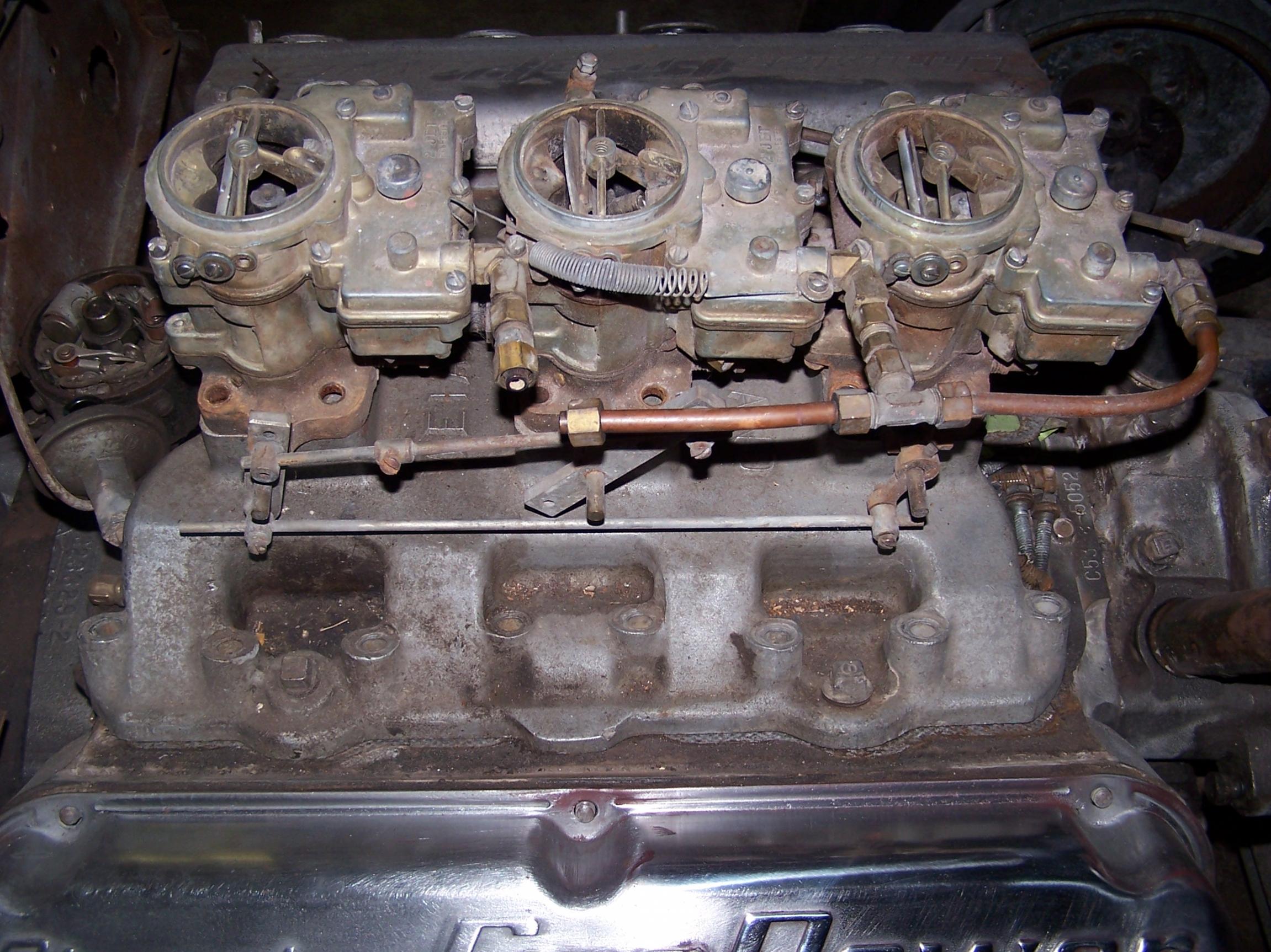

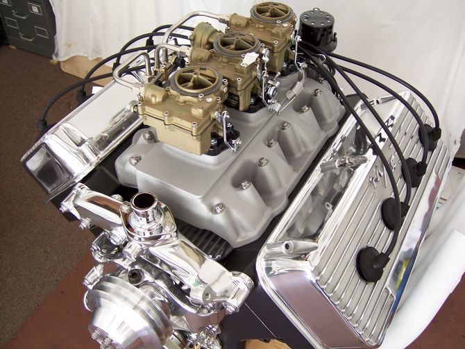

    Dave,.I believe the plate is on a Weiand 2x4 intake.

    yep, 2x4 set ups are commonly run on progressive, you rear carb would be your primary.
    i have a couple of 2x4 set ups and one of them i plan to run some 450 edelbrock carbs but im gonna pull em apart and bead blast the bodies and yank off the edelbrock tags so they look old.
    chrome valve covers, chrome plug wire covers and top it off with some cool little vintage chrome 2x4 air cleaners would be *****en.

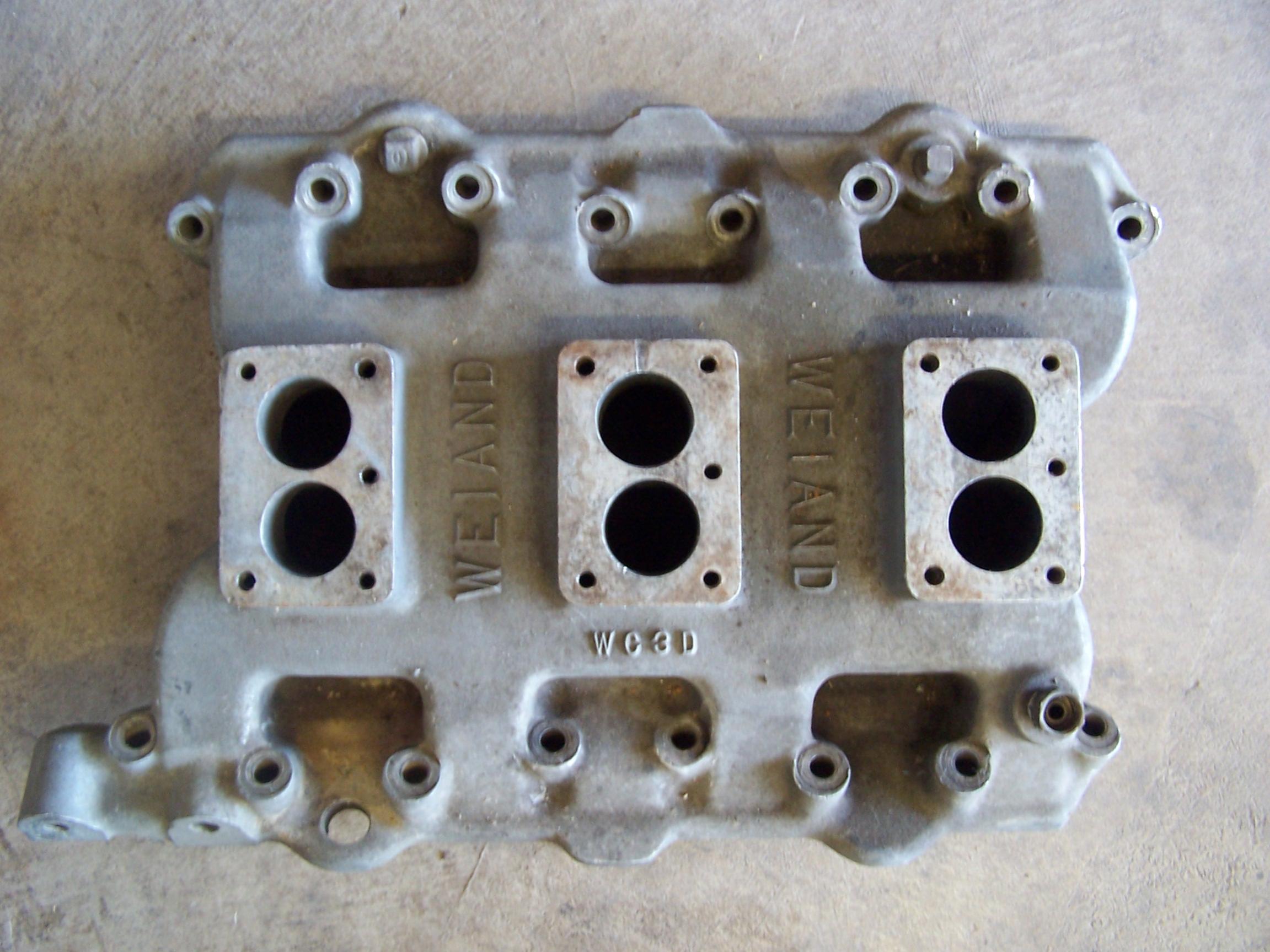

    Hi Jeff and others.

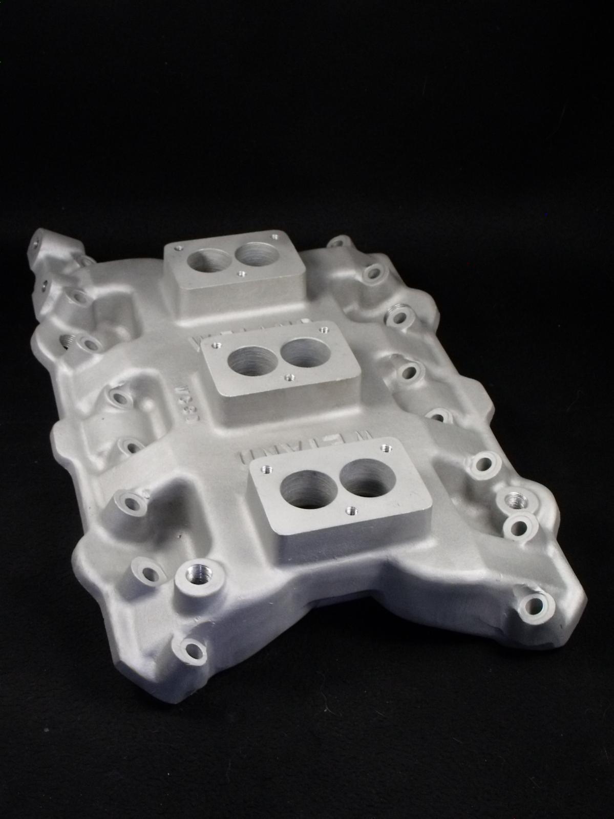

    WEIAND also made a 3x2 for the Chrysler Hemi's ( WC3D) but their not common, which is why most people don't know about them. I have seen people state that only 50 intakes were made ( not sure on that, only what I have read)
    Other option is a plate to go ontop of the blower intake, I'm sure one could be fabbed to look 'right' not just a flat piece of plate.
      109.7 KB
      157

    Edmunds made 2X4 & 2X2.
    Heard that the # was 75.....

    Yes Flatoz..correct
    my bad..I thought it was Edmunds...you are indeed quite correct.
    It was the Weiand WC3D
    My mistake all.

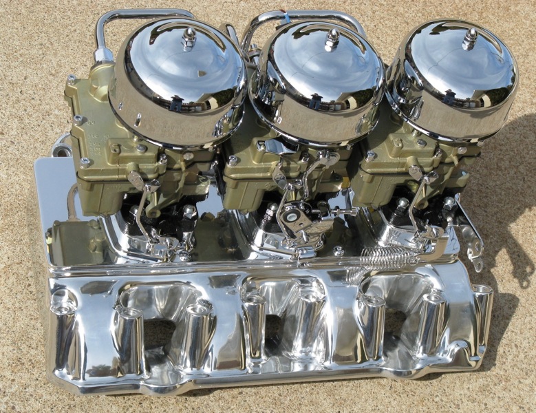

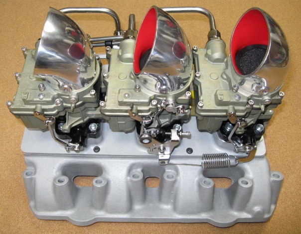

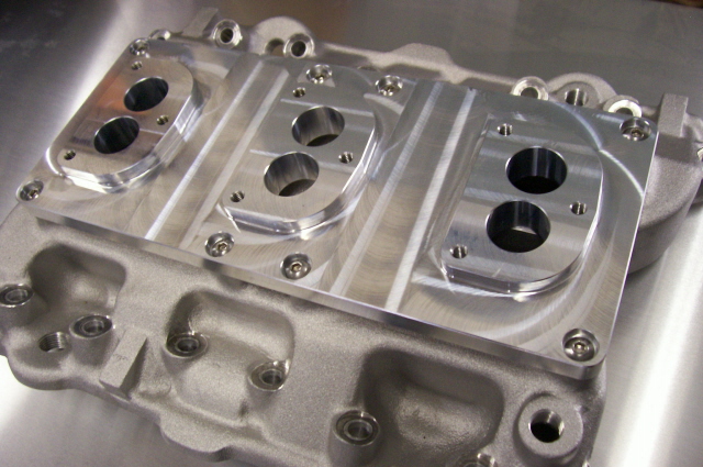

    I have been doing these for a few years now.
  10. TR Waters
    Joined: Nov 18, 2006
    Posts: 1,439
    TR Waters
    from Vermont
    They are based on a machined 2x4 intake. The 2x4 intake has a center divider which helps fuel distribution, unlike the PAW intake or a blower intake. All my top plates are 3 bolt. The carb pads could be machined flat and the plate drilled and tapped for the 4 bolt pattern. I can supply aluminum four bolt spacers.

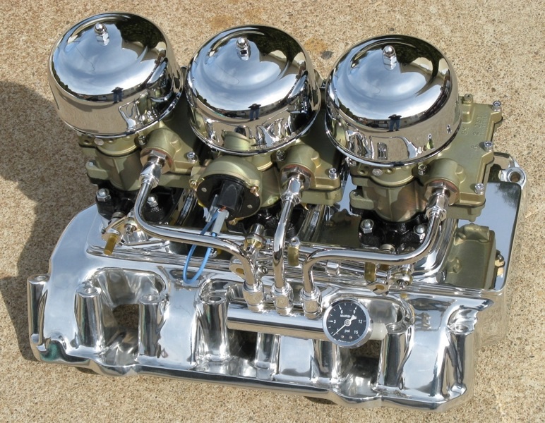

    Jeff (and others), a little clarification on the photo you posted.
    'Our Plate' was used on a PAW Base intake (not a blower manifold; or a chopped down 2x4). PAW discontinued this in '08/'09 before they decided to change their business plan and cut back on production of many of their items.
    We sold all of the units that we had as complete systems only and they worked very well.
    Just to let folks know, we do have some things in the works for this Early Chrysler HEMI 3x2 application and we'll let everyone know more once the details are settled.

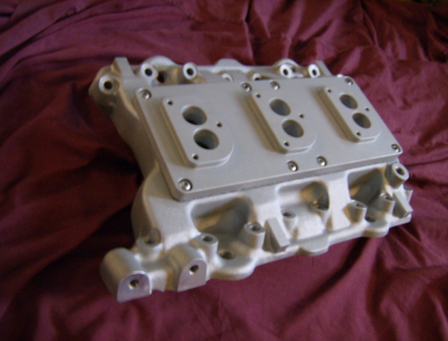

    It still amazes me that some many on the HAMB only care for looks, and not what actually might work better.
    I believe those now defunct PAW "universal" intakes had just one large hole in the center. The same as a blower intake. The picture below is one of my "chopped down 2x4" intakes before the top plate is added. You tell me which is going to distribute fuel better.:cool:
    The whole point of making my plates was that they can be added to one of the bizzillion Weiand 2x4 intakes in circulation already, and much cheaper than buying a whole new intake. Maybe if/when the new 3x2 intakes appear, everyone will be happy.
