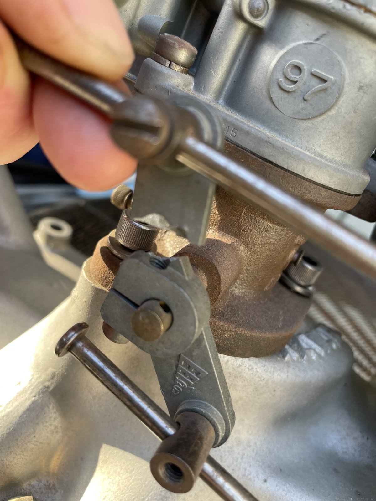

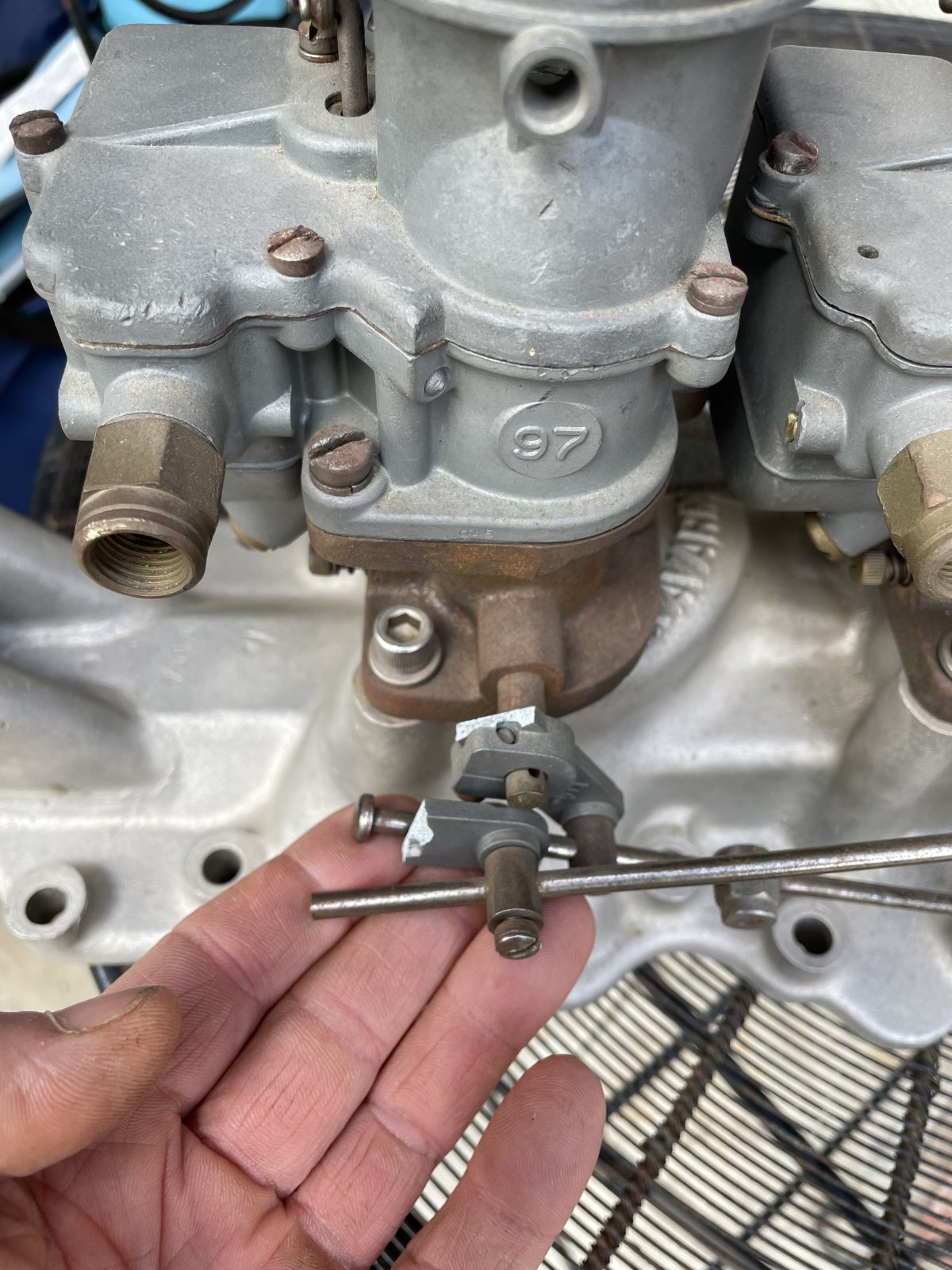

    Anyone know where I can get an eelco replacement part for this broken linkage part? Trying to replace it like for like because it’s so darn cool!
    thanks!

    Something like that can be machined from aluminum stock and then bead or sand blasted it to make it look like a cast part....

    I bet that is made of die cast zinc. probably can't weld it. I dug thru my Eelco stuff and I do not have one. I would search ebay for it.... there is nothing modern that is cool enough to replace that....

    Those linkage arms are very brittle. I was gingerly trying to pull one off a carb and it broke in two. I'd look on Ebay..

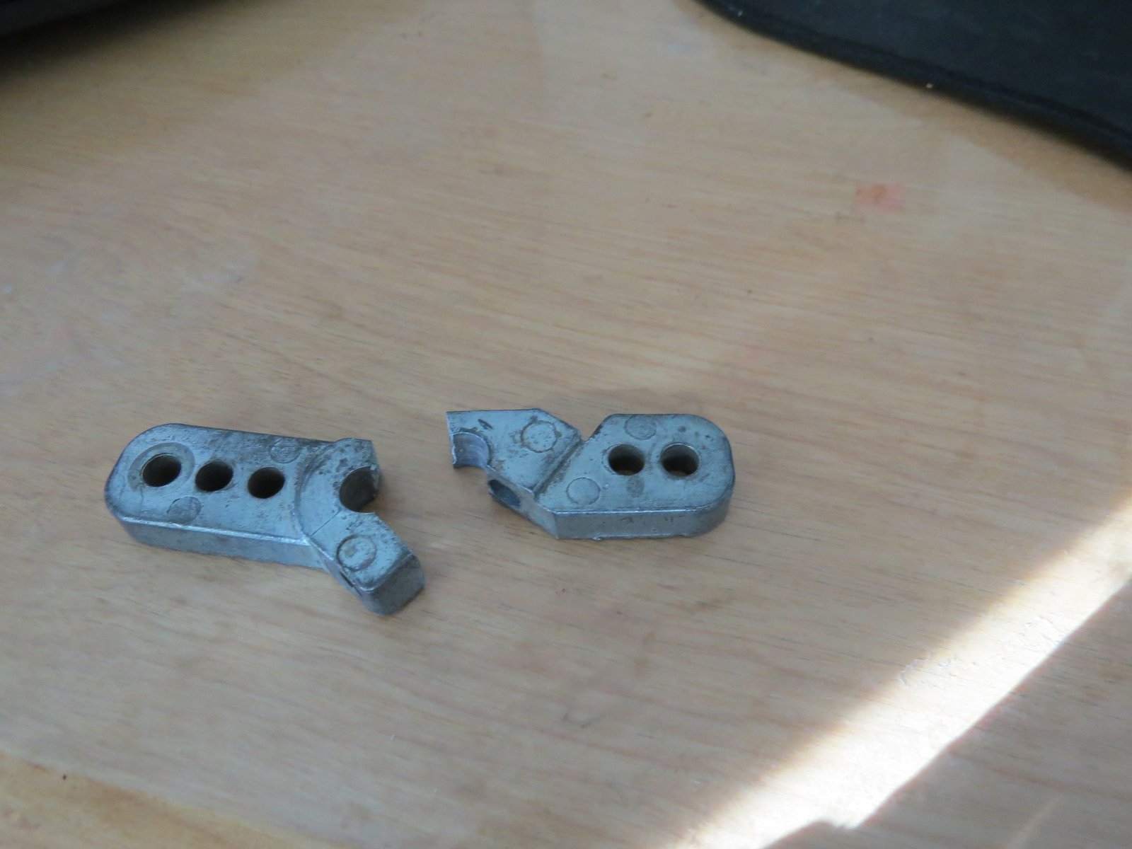

    As an Eelco collector I am continually looking for Eelco linkage. I have some. Not willing to part with them though. Sorry. Ya just gotta keep your eyes peeled. Post a want ad. The two on the left are probably not Eelco. IMG_2673.JPG IMG_2674.JPG

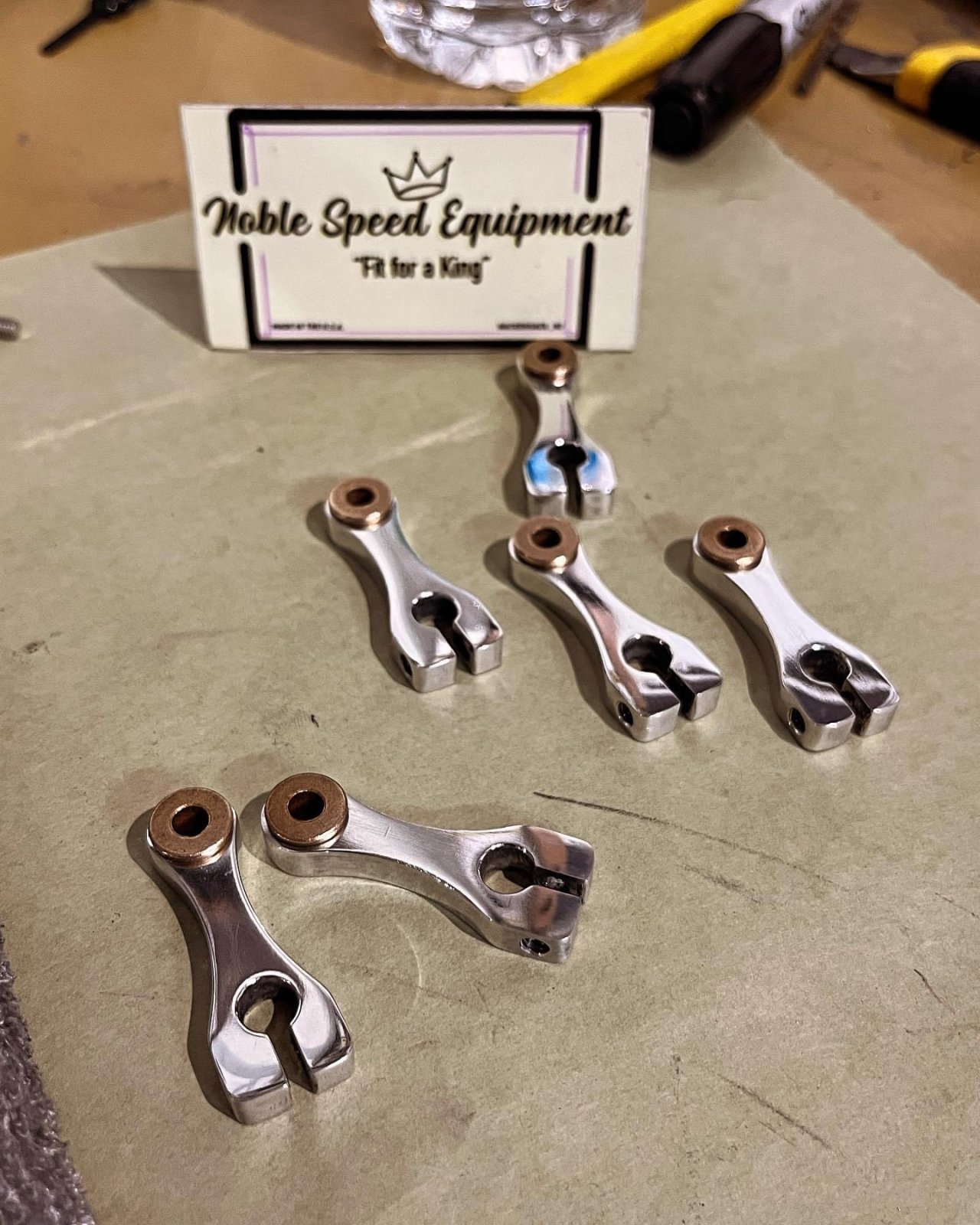

    Get a block of aluminum. It’s basic shapes, nothing you couldn’t replicate with a hand saw, file and drill IMG_4746.jpeg IMG_4747.jpeg

    upload_2024-3-2_20-55-16.jpeg Made these from copper. Have made the split type like the Eelco before as well. Just used hand tools.

    I sold him the one on the right in my picture above and as I was putting it in an envelope, I dropped it, and it cracked in half. Refunded him his money. They are brittle to say the least. The other ones I have are backups. IMG_2675.JPG
