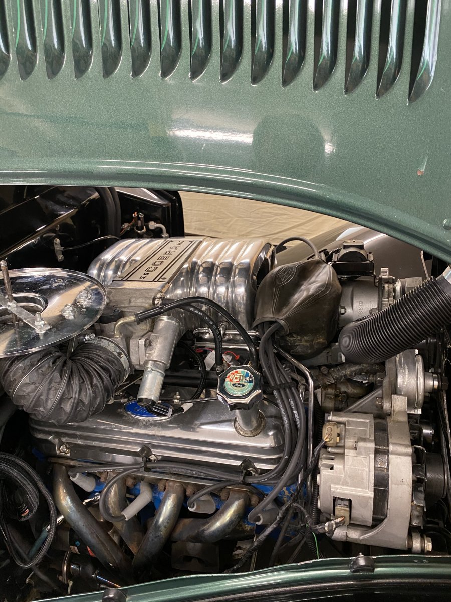

    I have 5.0 H.O. in my 33 Coupe with a return line. No big deal to put in a return line. B195FE25-A7F4-46EF-B58F-DA948BB53963.jpeg F5CE2D8F-A691-42E0-81B4-5890BC643563.jpeg 72DEF03E-F7F2-4B79-B1DC-8524B0971088.jpeg Have run it since 80’s with no issues. Grafted a Mustang fuel pump to my gas tank. Recently removed the stock computer system and put in a Holley Terminator FI System. Good results and car runs great.

    I like what you did with your air filter! Where's the MAF?

    Thanks. No MAF. Using Holley Terminator X Injection System which eliminates the MAF. After installing I had it Dyno Tuned and wow, what a difference!

    There you go! Good computer, custom tune, amazing results!
