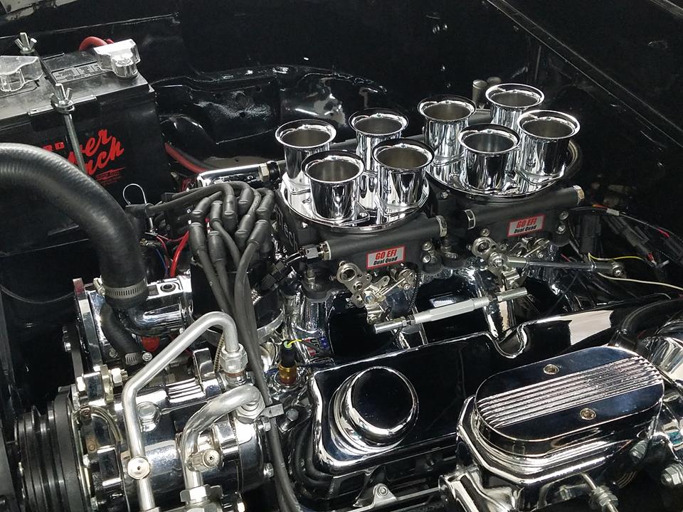

    I switched from a single Edelbrock to "Dual" Fitechs over a year ago and have never had a single problem. I Love it. I did plenty of research before hand and you will hear the same complaints about Holley or Fitech issues and I believe most issues have to deal with the installers. I took the advise of others and avoided the Fitech under hood fuel system and just put a good EFI pump in the tank, which seems to avoid a lot of the issues. I can start my car at 30 degrees or 95 degrees with a turn of the key. I've traveled over 1000 miles since the install and no more vapor lock, hard starts, sitting waiting for it to warm up, etc.. I highly recommend Fitech. btw I also drove the car to the Dragstrip without doing any changes and made 3 consecutive p***es with absolutely no trouble. The computer learned full throttle after each p*** and it picked up et and mph every single p***.
