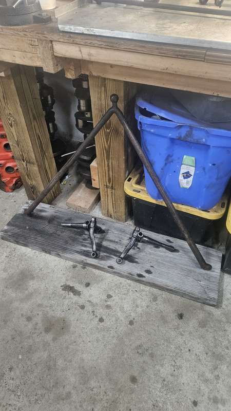

    Then I did a few mundane things, like the planetary gears for the steering column, an old rusty dash that seemed to match the rest of it;
    I have ordered all of the bushings I believe I need, so the next thing to do was to drop the front end. Everything was wallered out or loose, including kingpin bushings, which will be pretty evident later:
    Not the intricate art-deco curvature of the wishbone:
    I put the spindles and other bits in ATF/kerosene for a couple of weeks, while the weather calmed the hell down. Today, we were finally in the 40s, so I decided to clean them up a bit;

    The bushings had to be removed before the spindles could be properly cleaned:
    Had to drill out the bushing to 9/16 for a 5/8-18 thread.
    After I tapped it, I threaded this ball joint into it because it was all I had. I then had something for my punch to hit while I knocked it out. Gently, I might add.
    They cleaned up pretty nicely.
    It took two days of moving pretty slowly to get all the cotter pins removed and the front end dis***embled. I used metal picks and atf/kerosene with an SS wire brush to clean out as much as I could. I also used a lot of “Knock ‘er Loose” (with a name like that, I had to try it). Worked pretty well, finally got it 95% apart:
    Next up will be removing all the rest of the bushings and figuring out what else needs to be replaced or repaired. Supposed to be nicer out this week, and I’m refilling my propane tanks, just in case. Hopefully, I’ll be able to get all of the bushings replace in the front axle this week.
    The wishbone is tweaked pretty well, so I’ll be straightening that out, or completely destroying it and buying a new used bent one.

    I think the planets all aligned or something, so I got most of the front end straightened out, with new bushings, an almost straightened wishbone, and a mounted axle.

    I still need to straighten the end of the wishbone out a little more to fit correctly, from where it was bent. Ran out of time for the weekend.
