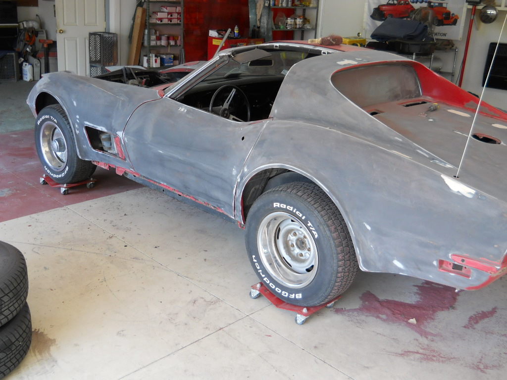

  14. Just finished this O/T Corvette---
    Razor strip 4 previous pant jobs and
    hand sand areas like jambs etc. 35 hrs
    Prep for epoxy primer 24 hrs
    Block Epoxy 16 hrs
    Re - Epoxy and 2nd blocking 20 hrs
    set up for B/C C/C 24 hrs
    Shoot base 3 hrs
    nib out a little dust 2 hrs
    Shoot clear 3 coats 3 hrs
    Nib clear and re warp 3 hrs
    Shoot 2 more coats clear 2 hrs
    Color sand and buff 36 hrs
    168 hrs @ enter yer own $$$
    Materials $2435.75
    Minor body work 28 hrs
    You guys do the math .
    This is 2012 not 1962

  16. Nice Job on that. You were pretty efficient with your time. Is this your own project or something you did for someone else?

  24. Thanx 4 the kudo's
    Customer was very happy! with quality and turn around time( 5 weeks)
    Went out the door for a little over 10K
    He shopped around (150 mile radius) and closest he could come to it was 15K.
    I told him "can't give ya an exact, but it would probably be under 12K."
    We were both happy with the 10 K deal.
    Nuff said !!!!!!!
