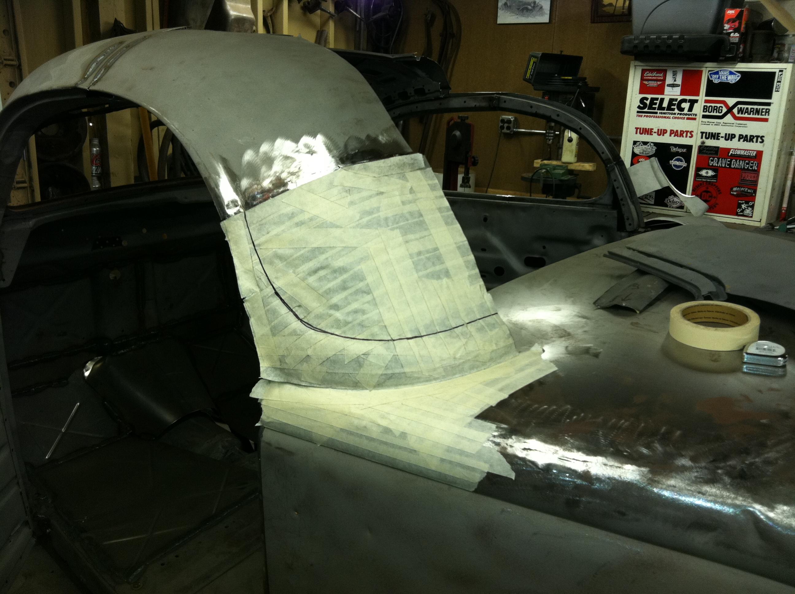

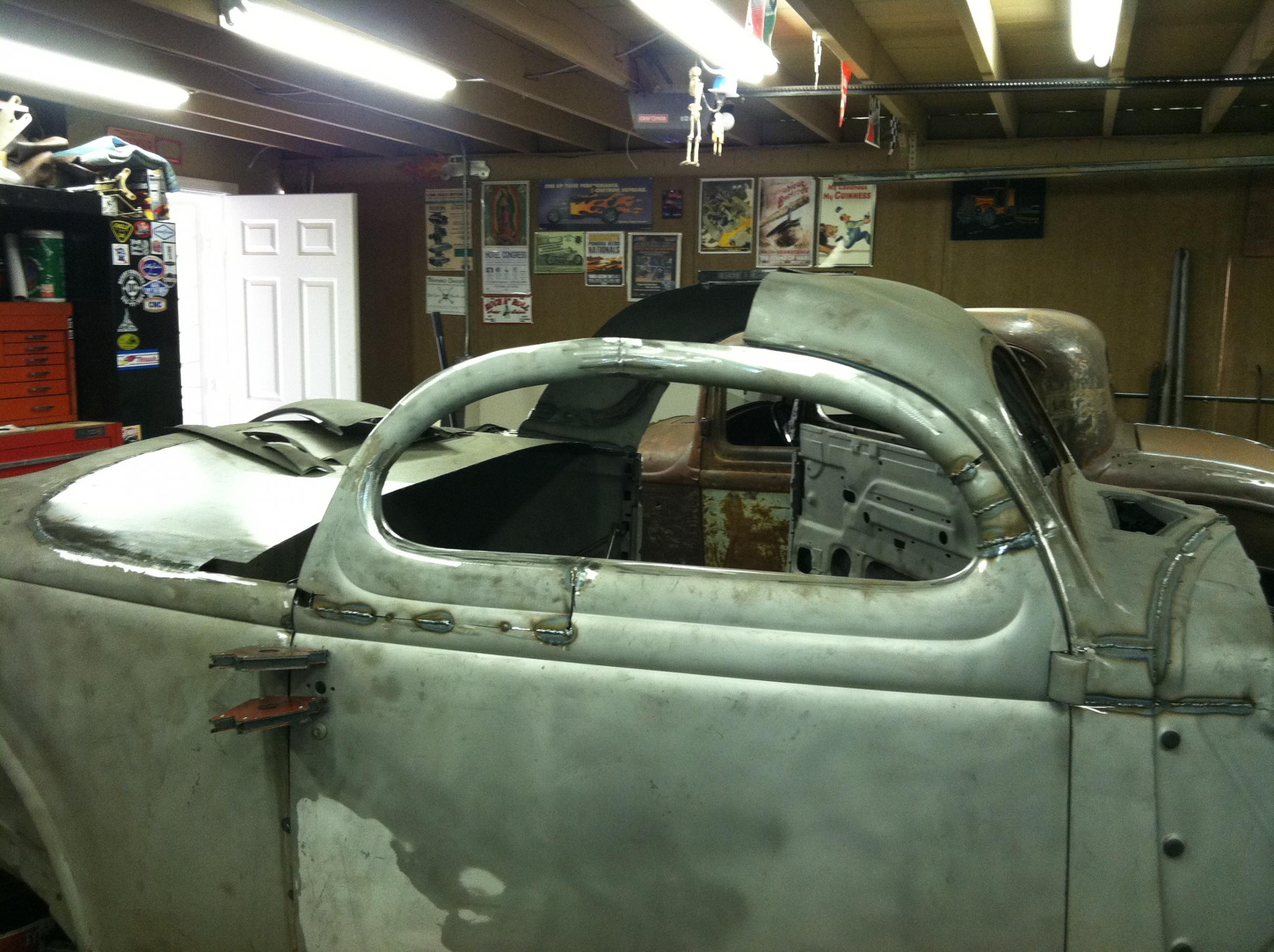

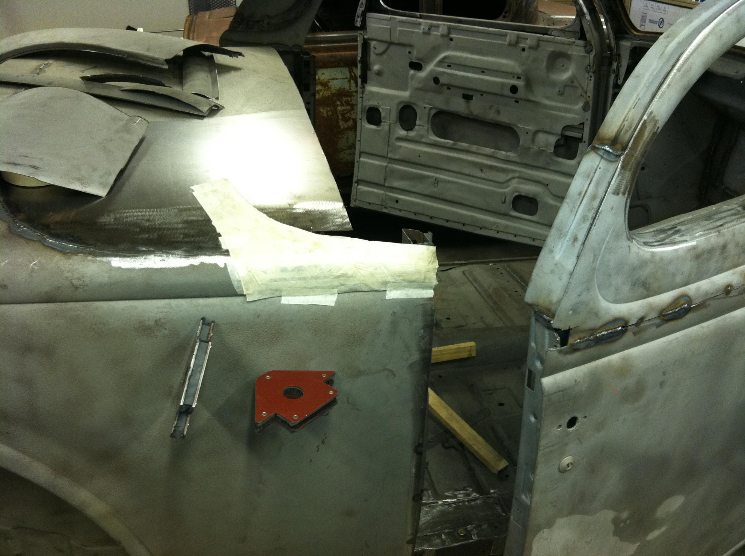

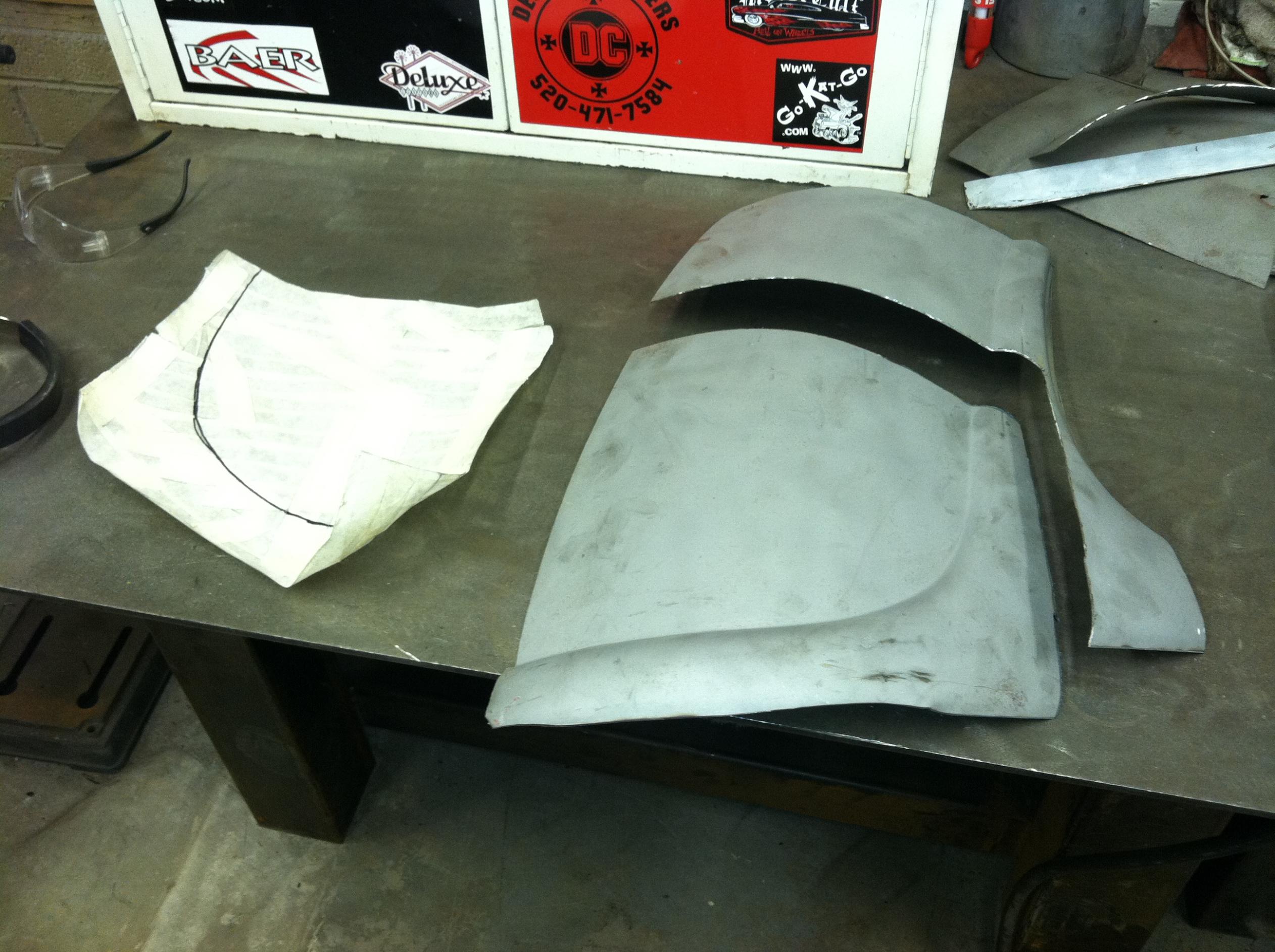

    Anyways back to the car. I had reset up the car after moving into the new garage and then spent some time looking at the right door which in the end did not turn out like the left so after sourcing some more doors to cut up, I redid the right door and now it look like the left so on too the roof. I used masking tape to make patterns of the left side and transferred them to the right side and made all the cuts and spot weld in place and this is where I am at so far. Its a holiday weekend so I am hopefully going to make some real progress this weekend. The summer is coming real soon and then its will be 115 degrees and work will stop to a crawl till the early fall starts up again. enjoy the pics and should have another update sometime later this holiday weekend.

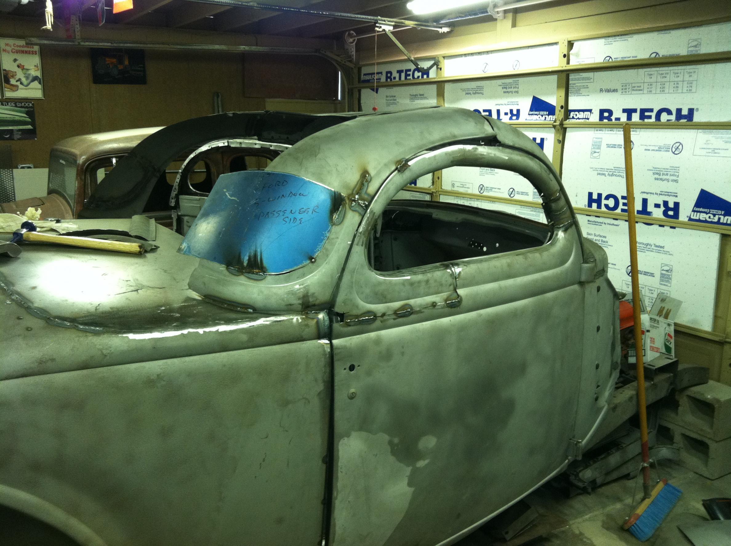

  11. So a small update. Got the right side of the roof ruffed in and now worked on the back window. First I cut the belt line off the window section and cut 1 inch out between the lower part of the back window and belt line to help section down the back window and still keep the stock height of the window for visibility. Then welded the belt line section to the car where the back deck was filled in. Now will have to get started on the fitting the back window and welding it in. Might even get to start on the roof skin before the weekend is over. Here are some pics.

    Fantastic work Ron....I really love three windas, I`ve owned two in the past...the only thing that I never liked on mine was the side on view..the measurement from the back of the roof where it met the rear deck to the edge of the trunk opening..it looks too long imo and made the cars look stub nosed...but thats me being picky I guess.
    get an air con unit rigged up in that workshop and get that thing finished...I cant get over that you can leave sand blasted metal uncovered and it does`nt turn to rust before your eyes....I`ve had bare metal panels develop a rusty handprint virtually before my eyes.Looking forward to seeing progress on this car, thanks for posting.

  15. So I started today by looking at the right side of the roof along the top of door and did not like the line the small rain gutter/body line was making. So I made some relief cuts and redid that body line and used a portapower to help push the roof down to make sure it was flat with just a little crown. Then having that done I could start on the back window section. I mocked it up and decide to build a jig inside of the car going thought the back window where I could get alot of cross measurements and vertical and horizontal measurements to make sure the window was in square and centered. Started by welding in most of the bottom part of the window and then made relief cuts on the right side till it fell in place with the right side of the roof/side of the car. As of now its mostly welded in on the right side and I can now go back to finishing the right side of the car top portion and then start on in the inner structrer with making new door frames and getting ready for skin on the roof. More updates coming your way.

  17. Some serious progress there!
    Back window is too big, looks funny.

    before you go any further, go back and start again. its all wrong. dont wreck a great car. get someone who knows what theyre doing to help you and watch and learn. all the best with your build.

    You have put some great work into that project but, the roof just doesn't look right. The door top as shown in the last pic is all wrong. Check the rear window and the roof length.
    Sorry, but I have to agree with the Voodoo Kreeper. Stop now and have another look. Roll it outside and stand back and have a real good look. With all the effort you have gone to it would be a shame to not get it right now.
    Read Voodoo Kreepers post again. He offered his opinion and wished you well with the build. But, because he didn't agree with everyone else you call him a clown.
    Good luck with the build.
  24. I can call him a clown when he just shows up on this site with no intro. I looked at his post and he never did a intro. He should start with that before throwing his weight around.
    You guys need to read a little closer. I said it was all ruffed in and there is alot of fine tuneing that will need to be done including the final alignment of the doors and gaps. go back to the begining of the thread and you can see the car was on its roof and was rolled down side of a gully. there is so much yet to be done. the pics make the top of the door look like its not right but trust me its close and once the gaps are set and everything is aligned it should be fine.
