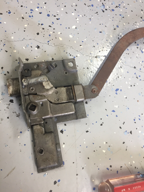

You can attach the power linkage to that point but it would require a Slot as you can see in my photo so that when throwing the latch it don't move the inside handle. Also so when you use the inside handle it don't move the popper. The inside handle has a spring to keep it parked in the proper position. You don't want to have to over ride 2 springs with the power unit. It takes more power to do that. The Wizzard
Yep. Good idea. I didn't think about having to notch the arm. This maybe trickier than I thought Sent from my iPhone using The H.A.M.B. mobile app
So I mentioned Math. The 2 numbers you start with is total movement needed for the latch finger. Then how much travel the Popper needs for total travel. The more travel in the popper the better the pull power. You must make sure you use FULL travel of both. If the door latch bottoms out before the power unit bottoms it will soon brake up the door latch unit. The slot in the handle pull rod is a simple to do item. The Wizzard

SMH, I'm sure you have seen that one latch has a broken return spring and the other is missing it's spring. Both of those need to be replaced with stock style springs. That cheezy little spring on the one won't do the job. I always get 40lb rated units. When you have good weather strip and doors that don't rattle you need the good pull to get the latch to release. The Wizzard
