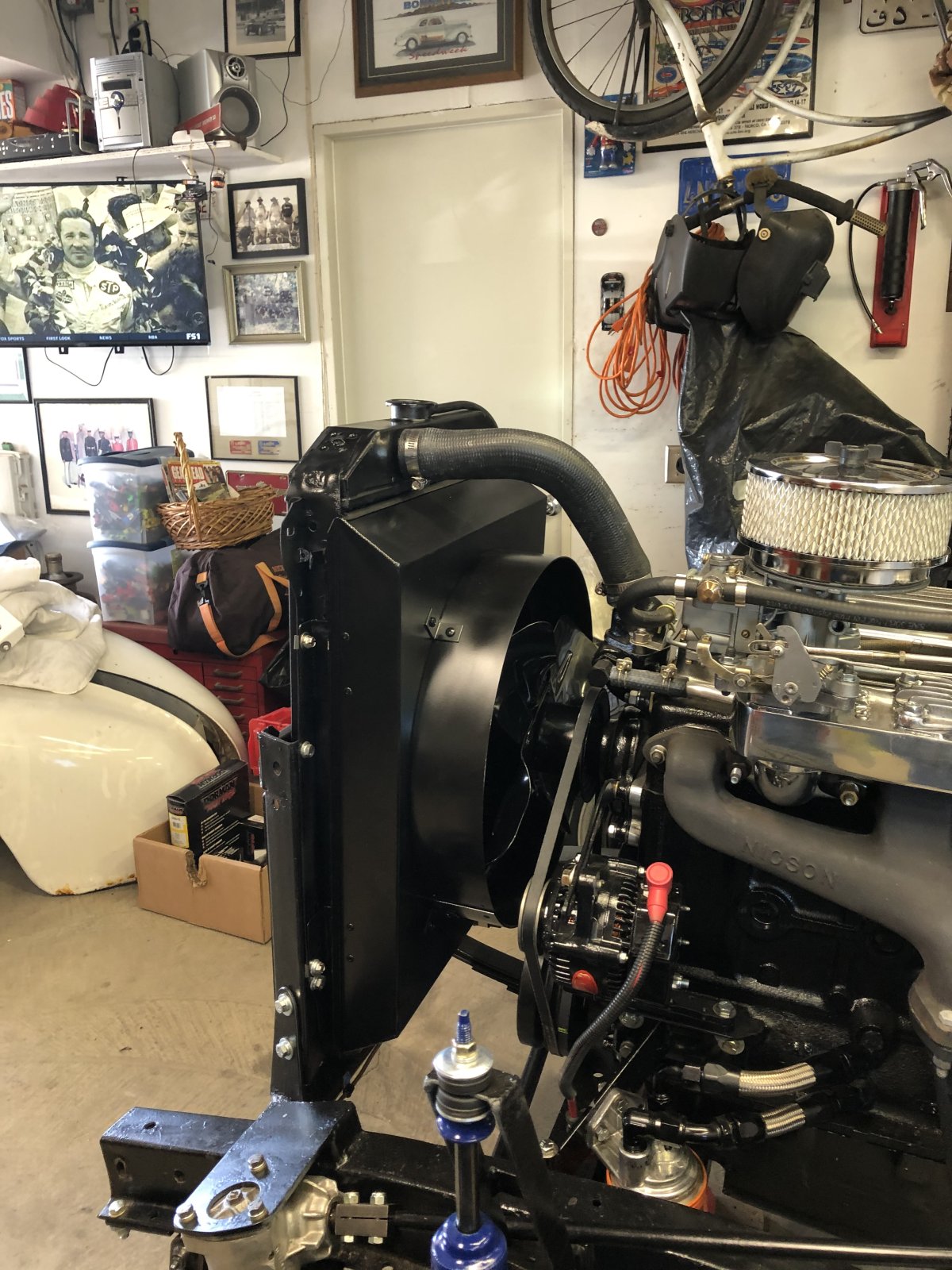

  18. Are you sure your harmonic balancer shows true top dead center?
    How much initial advance at idle?
    If it is only around 10 degrees initial, recurve the distributer to run around 15, it helps a lot
    Also make sure the idle mixture isn't too lean
    If that is all sorted out, and the rest of the cooling system is up to par, a 16" spal #30102049 curved blade fan is a monster, I have run it in several builds, never used a shroud. Bosch 70 amp relay with built in diode # 0 332 002 156 and a 100 amp alternater with upgraded alternator wiring. Fan draws 30 amps while running.

    ***uming the fan is mounted flush against the radiator, the ring around the fan acts as a basic but effective shroud by preventing air from coming in from the side, forcing all air moved by the fan to come through the part of the radiator that the fan covers. It's not quite as good as a full shroud pulling air through the entire radiator, but it's far better than a completely unshrouded fan sitting some distance from the radiator as that will mostly circulate the same hot air behind the radiator, pulling very little fresh cool air in through it.
