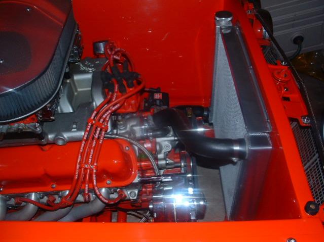

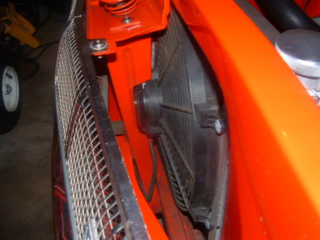

    I have a derale 16 inch pusher with both the automatic thermostat in the radiator, and an off on switch on the dash.
    I have less than a 1/2 inch between the motor and radiator, and cannot fit anything between the motor and rad.
    In 85 plus weather she will creep up to 210 at a lite, and more is in constant stop and go traffic.
    Once moving it will come back down.
    I may get a new radiator and then plan on using a mech fan and shroud.
