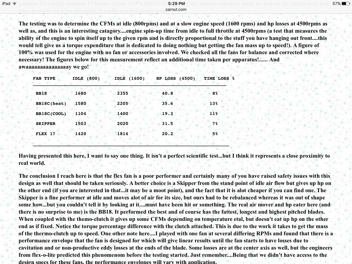

  3. Somebody could explain this:
    Be or get as scientific or simple as you want-
    So far with physics, there's nothing be gained with out trade offs some other place.
    And moving air certainly does take power and , "power is power"
    How is it that an 12volt DC electric motor running way less than 1 Hp and that can easily fit in your hand ( itty bitty puny thing) can move enough air when coupled to a Fan. Yet when a fan is bolted to a 350 hp engine it takes 40 hp to move the air?
    I've read the reports and seen the dyno results but it don't make any sense at all.
    This is a 40 HP dc motor

    the dyno isn't moving...a car is moving...I don't believe that it takes 40 hp to spin a fan on a race car.

  7. Man I don't either,
    and tests can be manipulated any way the issuer wants but there's a few tests that report a 40 hp difference from fan to no fan.
    I don't get it, I don't understand it, I don't have a dyno to prove it, so I basically ignore it. Not that me ignoring it is a good thing but I really can't even begin to ponder about it.
    40 hp is huge ! A regular old ultra lite has about 15 hp. The kick *** ones have 40 hp. The big whole house fan 3300 CFm uses a 1/2 Hp. If the puny electric cooling fan motor chops and moves air sufficiently and efficiently along with all theses other examples but a 8 cylinder will use 40hp to do it. Ok

    If a fan used 40hp, how did my '60 Falcon get to freeway speed?
    After that, plus generator load, drivetrain friction, rolling resistance, and wind resistance, etc., I should not have been able to get out of the driveway.

  10. There's two reasons.... One, an engine-driven fan doesn't run at a constant speed. Design it so it moves enough cooling air at idle, and at higher speeds it's going to move more air whether you need it or not. Thermostatic fans and flex fans are attempts to reduce this, but they're only partially successful at best. Two, it's a matter of efficiency. Engine-driven fans require larger clearances between the fan and the shroud because of engine movement to avoid physical contact, and this 'leakage' reduces efficiency. Sort of like removing the piston rings from your engine; it may still run, but it'll be a lot less efficient.
    Both of these things are easily addressed with an electric fan. Constant speed is inherent in the design, so you simply need a fan that moves enough air at only the times you need it. Removing the fan from the engine allows much closer clearances, so efficiency goes up... This is a bit simplified, but that's the gist of it.
    And I'll agree with Squirrel that real-world hp losses with a mechanical fan at speed are no doubt lower than what you see on a dyno, but still won't get anywhere near the 1 hp that an electric fan uses.

    Doesn't some thermodynamics theory tell that it's always going to take X hp to move Y CFm of air no matter where the HP comes from?
    And if that's so, couldn't you extrapolate the CFM being moved if 40hp was being used?

    I call ******** on this whole thing, and not because of traditionalism.
    It doesn't matter how you drive a fan, off the engine's pulleys or with an electric motor it takes the SAME HP to move the same amount of air. And you have to generate that power with that engine, either with an alternator or a generator in order to drive that electric motor. And you're going to need just as much horsepower as you do with a mechanical fan if you move the same amount of air. That's simple logic.
    And if you're generating that power with alternator or generator, THERE AIN"T NO FREE LUNCH. It's going to take as much, if not more because of heat losses and friction from 2 devices, one to make the electric power, and the other to propel the fan, as it takes from the engine to propel a mechanical fan.
    The only possible advantage of the electric fan is if it has a thermostat to turn it off when the vehicle is moving enough to supply the air flow needed to cool the engine without a fan. And that brings complexity and reliability into the picture.
    But I sorta suspect that the heat and friction losses I have already mentioned, plus the added complexity and reliability problems don't equalize that in the long run.
