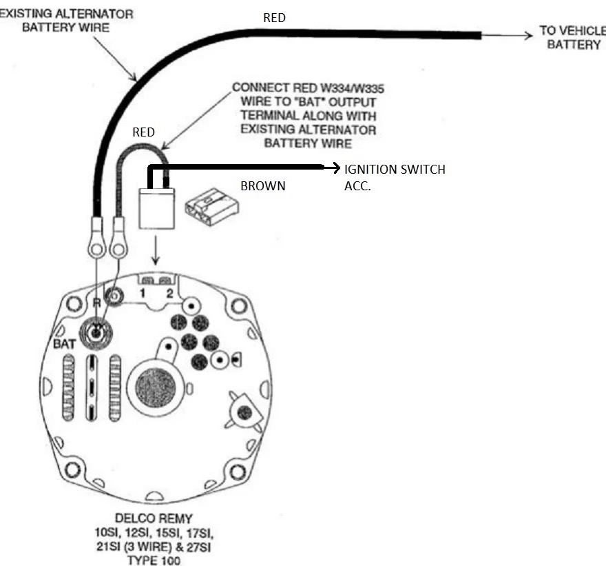

    ActionYobbo
    Alternator is a GM 10Si internally regulated. The output wire goes to the power distribution panel aka fuse panel then to the starter solenoid then the battery. This is supposed to be GM style of wiring according to the instructions that came with the 21 circuit universal harness. All I have running off the power while I have been driving is the ignition coil and the dash gauges unless I have my foot on the brakes

    Tested the alternator output. Off it’s 12.7 from the battery. Idle it’s 13.8 and 2000rpm it’s 14.7 the battery stays at 12.7
    from the picture I have the battery word going to thd fuse panel and the ign/acc wire going to the idiot light.

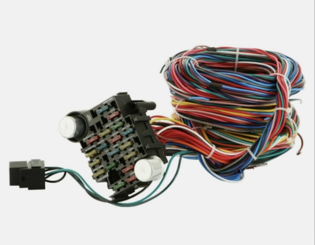

    The 2 red wires at the alternator are crimped in 1 terminal and to separate them I would have to cut into the harness wrap.
    I used this (see pic) 21 circuit wiring harness and it’s pre wired for the alternator to feed the fuse block power distribution bar with another wire from the other end of the power bar to the battery.
