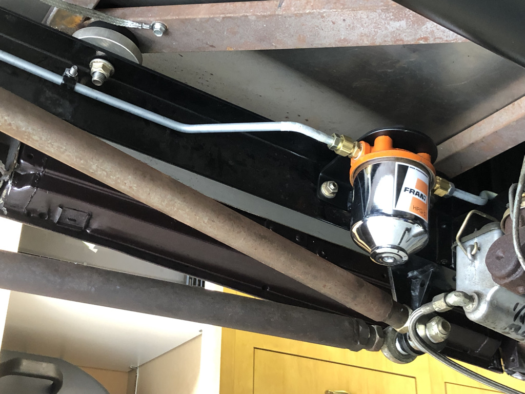

  11. Another vote for the Carter, a little noisy but if it's in the rear near the tank like it should be, then you'll be alright. A 100 micron filter before the inlet is another recommendation as well with a finer filter after it (there is a Wix element in the Fram can) 2CC16304-DFB9-40F0-BE67-D2C64AE1E5D6_1_105_c.jpeg .

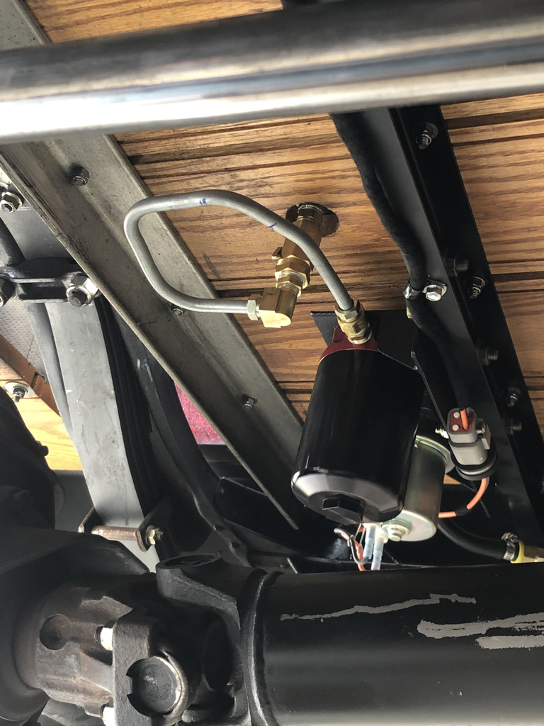

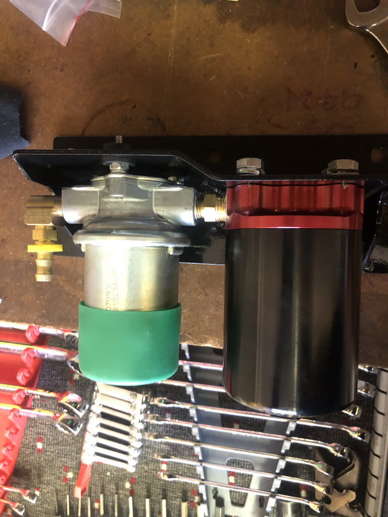

    I just got through installing a Carter 4600. It does require a regulator. One thing I like about is I can drive the car with the pump off and it will still pull fuel through the electric pump to my mechanical. The blue thing is my filter and needs to installed before the pump. The Carter pump does have filter screens in it from the factory but not fine enough for my liking. If you buy the right Carter pump you don't need a regulator.
