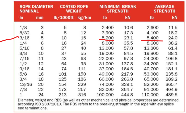

    Better still change it to Dyneema Rope.
    It is really easy to splice
    3/16" rope has the tensile strength of 5200 lbs [compare that to the McM Carr ropes]
    Dyneema wont amputate body parts if it breaks. [just be careful with some oils]
    Budget36 likes this.
  8. gimpyshotrods
    Joined: May 20, 2009
    Posts: 24,569
    gimpyshotrods
    You are comparing two ratings that do not match each other.
    The number on McMaster-Carr is the working load rating.
    The numbers you provided is the minimum break strength.
    You have missed the safety factor. That is expressed as a ratio of the minimum break strength to working load limit.
    In the US wire rope is not sold by minimum break strength. It is sold by working load limit.
    The OSHA 1926.1414, ASTM A1023 and MIL-DTL-83140 safety factors for wire rope used in construction are 5:1.
    That means that the minimum break strength of what I posted is at least 5x of the working load rating, but even that is not all of what is at play here.
    Several of those wire ropes are made to the Fed. Spec. RR-W-410. The safety factor there is 10:1!
    By OSHA/ATSM/MIL-DTL standards, the synthetic rope that you posted has a working load rating of 1,040lbs.
    By Fed. Spec. RR-W-410, the synthetic rope that you posted has a working load rating of 520lbs.
