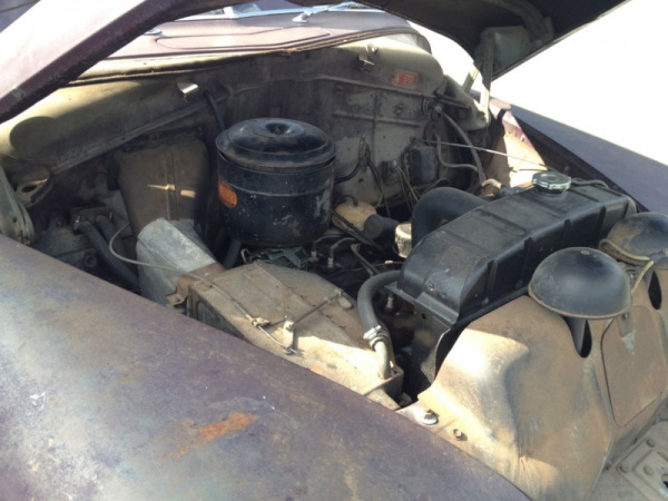

    The '49-50 Plymouths have an air tunnel from the grill to the radiator to direct the air. The '51-52 models came with a deflector in the hood to do the same thing.
    Pictured is the stock '49 setup.
    I use a Flex-a-lite fan mechanical fan with a shroud on my '51 and it keeps my 318 cool in 100 degree weather.
    Make sure all the air is going through the radiator.

    thanks for the pic, i think i can whip up a shroud to direct air over the exposed area of the rad.

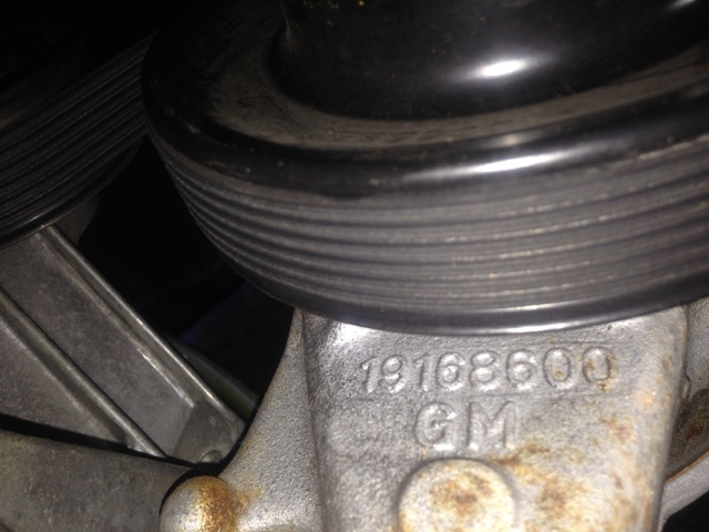

    thanks for the video. did some inspection of my water pump and only found this: (see Pic) never found any info on this casting #.

    I wouldn't have clue on the #.
    Let me ask a few things.
    Did you buy the crate engine new?
    Did it come with the WP?
    If you bought the engine new, what was the p/n for it?
    And if it didn't come with a WP, do you recall where you bought it...most online sites will have a record, as will AutoZone, Orielly's, etc., for the warranty.
    Just to be clear..is your engine set up with just one serp belt for everything?
    Or are some accessories run off a V-Belt as well?
    As I recall, if the WP turns CW while facing it, you need a standard rotation pump, if it runs CCW, then you have to use a reverse flow pump

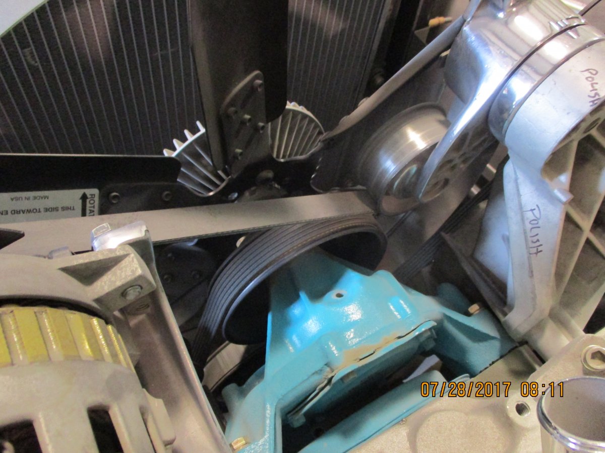

    And just to help out here on the standard / reverse rotation issue - the fan has to be the right rotation, too. An engine like the ZZ4 use a reverse rotation pump and has to have a reverse rotation fan, too. If the WP is turning clockwise looking at it from the front, it should use a standard rotation pump - if it's turning counterclockwise it should have a reverse rotation pump (and fan). When I get back to the shop, I'll look at the serp setup on my 50 Pontiac - I came off a Camaro and is all stock GM stuff. Sometimes it's really easy to get off on a tangent and overlook the basic stuff.

    The Camaro serp setup on my 355 in the 50 Pontiac uses a reverse rotation water pump (and fan) IMG_0064.JPG

    Eddie, if the pulley is turning CCW, then you should be using a reverse rotation pump - basically, the vanes are the opposite of a standard rotation pump, and the coolant flows through your engine the same direction as it would with a standard rotation pump, it's just made to pump correctly for the serpentine setups that basically use the backside of the belt to drive the pump.The drive setup for the serpentine belt will turn either pump CCW, but only the reverse rotation pump will pump correctly turning that direction. A reverse rotation pump on a standard rotation belt setup doesn't work either. I think the belt setup on my Pontiac came off a '85 or 86 Camaro or Corvette.
    I think that's probably a casting number on the pump in your pic - won't necessarily tell you much.
