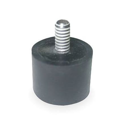

    Saw this on another site so thought I would try it for my Carter 4070 vane pump. Use a GM trans mount, cheap; about 5 bucks. Totally isolates the pump in rubber from the frame. You can still hear the pump but not like you have a can opener running on the seat next to you.

    Rubber isolator pads. They sell for $1 ea. and are much smaller, and clean looking. They also come in various sizes with either threaded studs, or threaded holes. I used two 1/4" stud style to mount mine and eliminate the noise.
