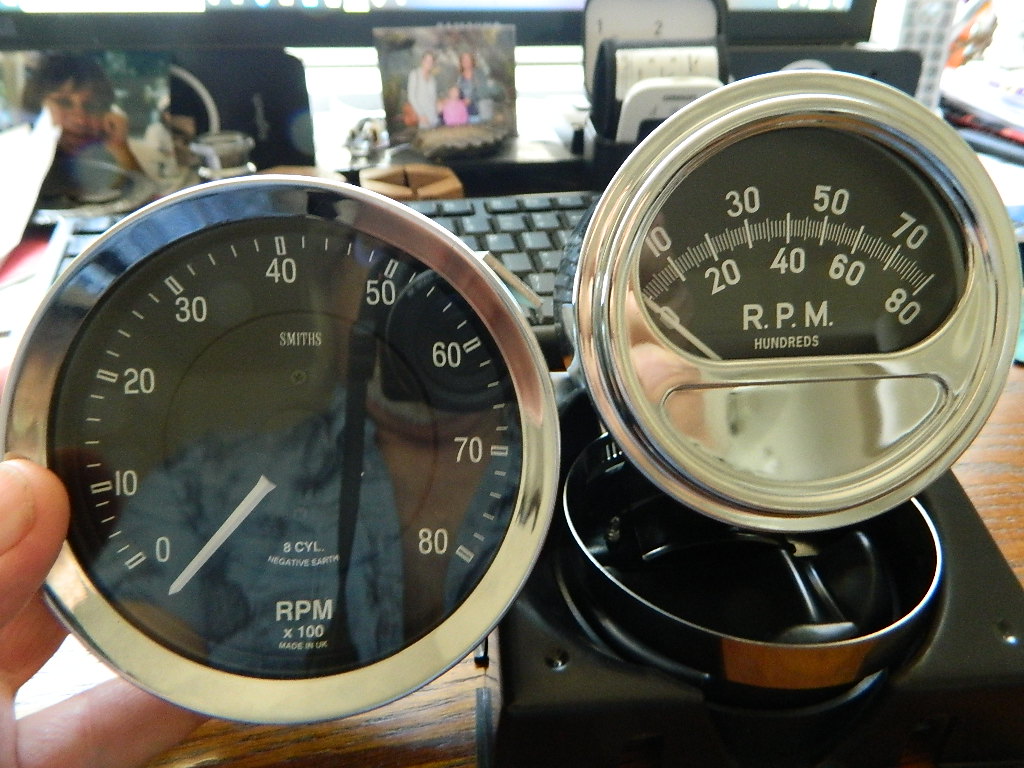

    I'm wanting to use an electric tachometer with a Vertex (internal coil) mag. There are a couple converters on the market that will handle changing the signal to a square wave and read the mag. Anyone have any 1st hand experience with either the Autometer 9118 or the MSD version?
    I have a Bosch FST 8050 and a Smith's RVC 2816-00CA neither of them are traditional but I do have them in my stash and do not have a cable drive bottom for my magneto.
    Thanks.
