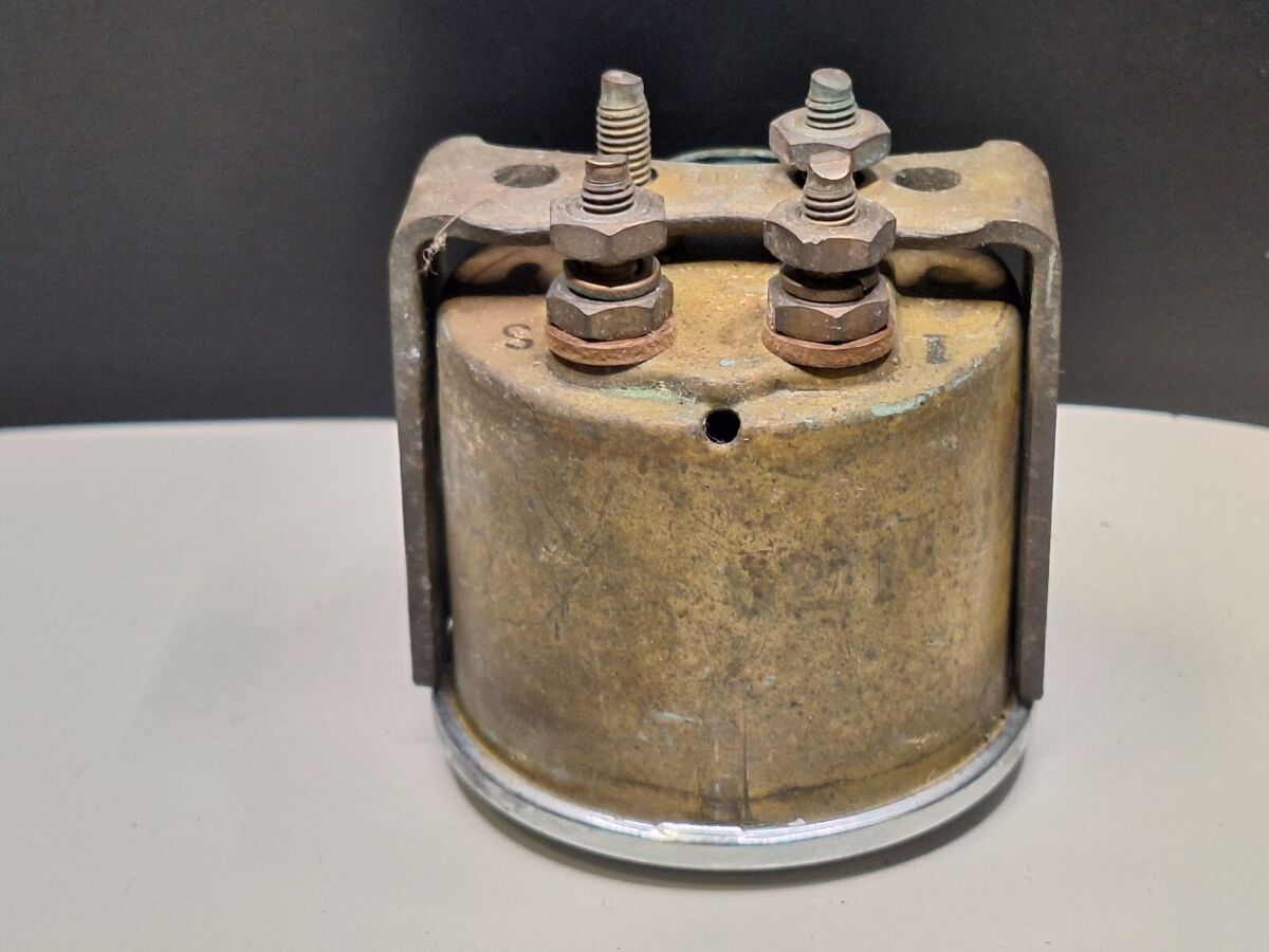

    I'm stumped on my inoperative electric water temp gage. There's no needle movement when the ignition switch is on or after the engine has come up to temp. I've tried two different gages. Here's what I have and what I've checked out.
    Stewart Warner 100-280 electric water temp gage; I tried both a 70s vintage gage and a new gage

  2. Ohm wire end to wire end. Unhook from gauge and unhook from sender and just ohm the wire or run a jumper wire from the gauge to sender. Make 100% the power is to power on the gauge and sender wire to sender pole on gauge, also make sure both studs have the isolation cardboard under the stud base.

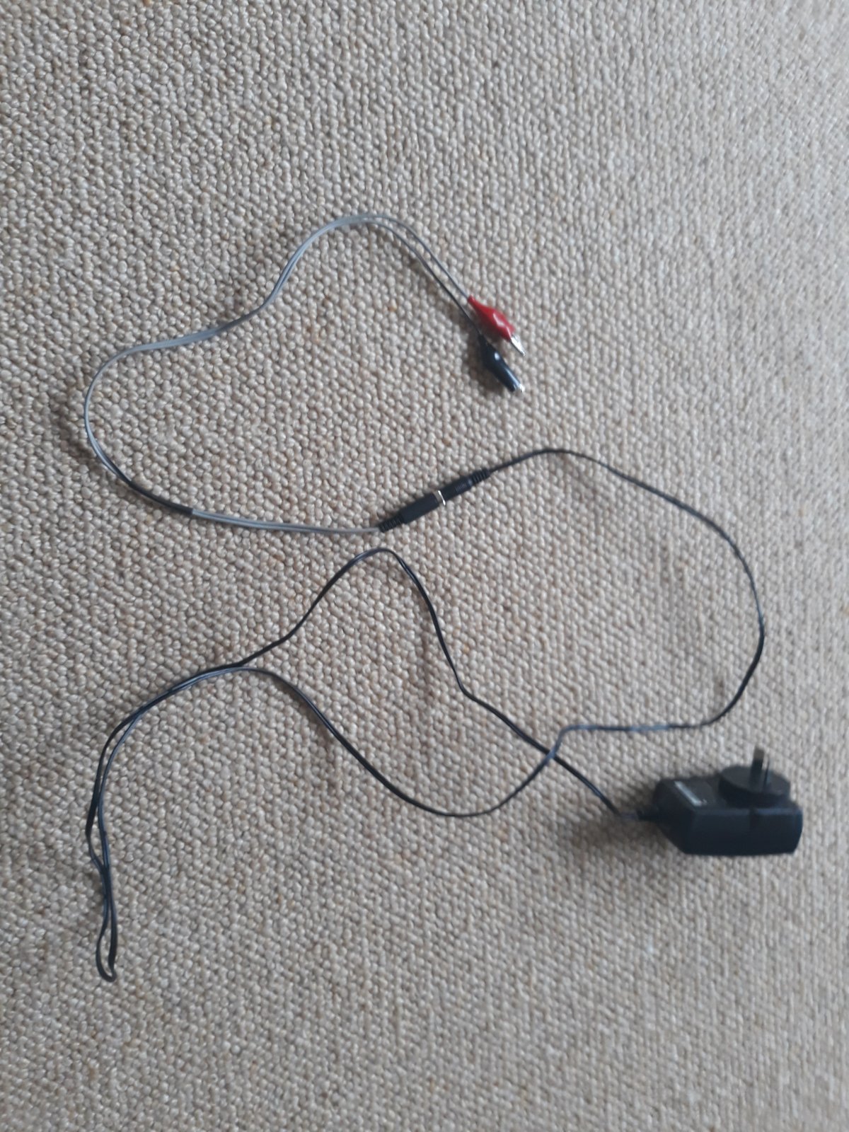

    Temp and Fuel gauges are dirt simple [they are basically 2 electromagnets pulling against each other]
    They are real easy to bench test .

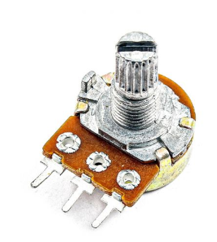

    You need a positive wire and 2 ground wires . But connect the sender ground wire via a potentiometer [in-series]
    Approx $2-50 for a potentiometer
    If the gauge is working correctly you can dial the gauge up and down using the potentiometer [then measure the resistance across the potentiometer to match the sender values]
    I use a 12volt A/C adaptor 2 power up my gauges on the bench.
  10. brianf31
    Joined: Aug 11, 2003
    Posts: 1,050
    brianf31
    I need to add a potentiometer to my tool box. I bench tested with jumpers straight off the battery but that only pegged the needle to the extremes.

    Kerrynzl
    They dirt cheap.
    I also use them to "tune" my gauges.
    If your temp gauge is reading too high or too low and you want the needle to be in the normal range.
    After getting the Engine up to running temp [you can also do this with the engine still running ,even on the side of the road after a drive] .
    Connect the potentiometer in-series between the sender wire and sender and dial it up and down.
    If that doesn't dial it the correct direction, then reconnect the sender and connect potentiometer parallel [from sender to ground] and dial it up and down.
    Once you have the gauge where you want the needle , then measure the resistance across the potentiometer.
    Then add the same value resistor to the sender wire [either in-series or parallel by grounding it]
    This method keeps the needle in the correct position at normal running temperature
