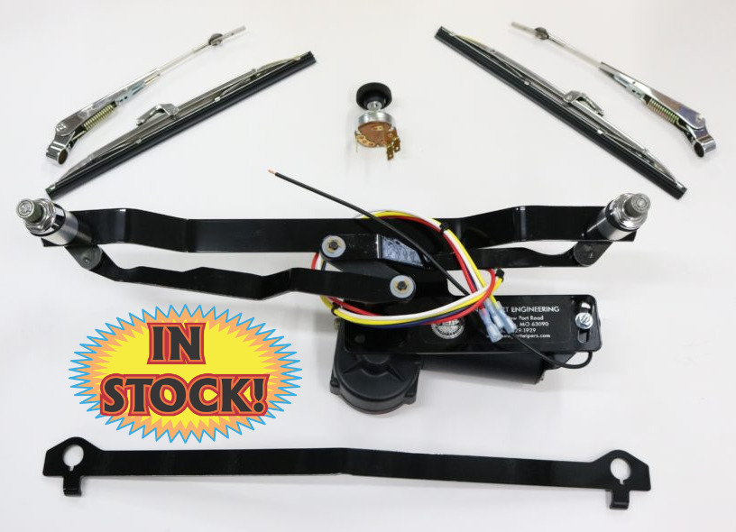

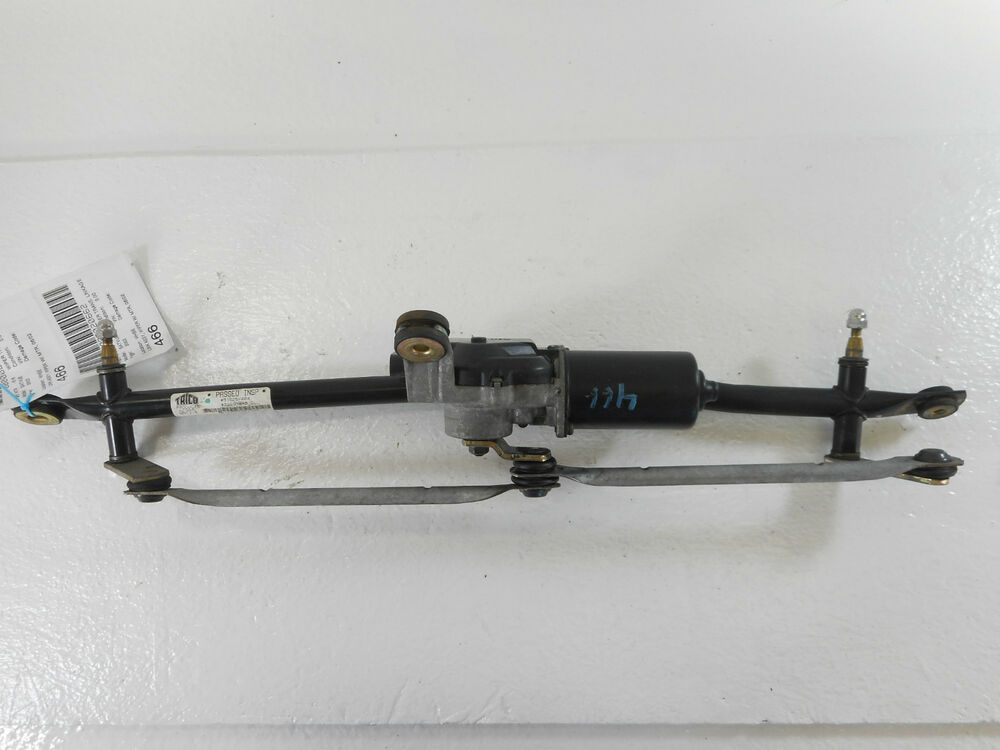

    That is incorrect. Pic 1 shows a standard dual wiper system. The final drive turns 360 degrees and both wipers move in the same direction. wipe2.jpg
    Pic 2 is a Dual wiper system with wipers moving in opposite directions. As you can see, there is no way you can use a 360 degree final drive...as the arms will just run into each other...it's physically impossible. You need an additional transmission to make the final drive go in a back and forth motion...and less than 180 degrees both ways. wipe1.jpg

  14. hotrodjack33
    Joined: Aug 19, 2019
    Posts: 4,981
    hotrodjack33
    Incidentally, The above is a Newport Engineering set-up

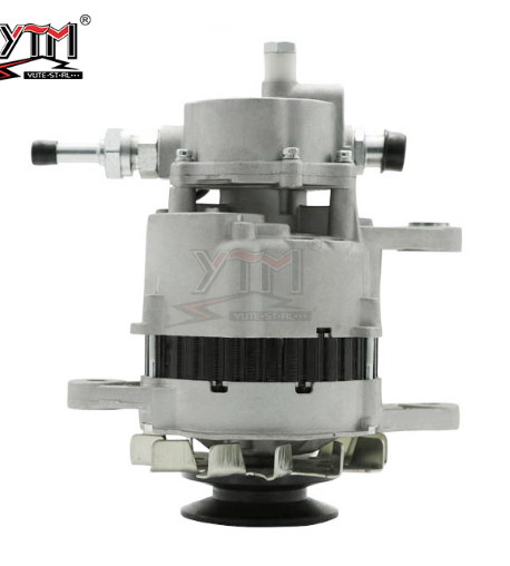

    Mimilan
    Fit an Alternator from a Japanese Diesel engine, they have a powerful vacuum pump driven off the back of them
