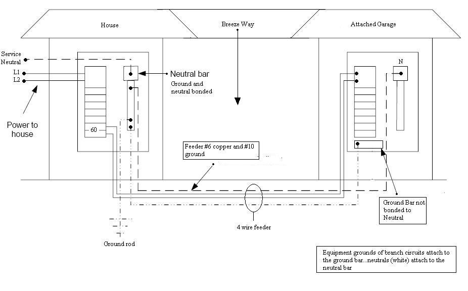

  19. bubba55
    Joined: Feb 27, 2011
    Posts: 525
    bubba55
    Make sure you do not bond the neutral to ground in subpanel and yes you do need a true grounding rod - code usually is one size smaller than feeder -if you use aluminum must go up one wire size - if in doubt don't - call an electrican

  21. Mike51Merc
    Joined: Dec 5, 2008
    Posts: 3,855
    Mike51Merc
    Hey Bubba,
    I understand you're not supposed to bond the neutral to ground in a subpanel, HOWEVER, if you are putting a subpanel in a remote building, doesn't it act as a new main, its own main? In other words, the feed coming in will be a hot leg (or two) and a neutral, and the structure has its own earthen ground (together with a bond to neutral in the box)?

  24. 52HardTop
    Joined: Jun 21, 2007
    Posts: 1,116
    52HardTop
    buba55's diagram has it right. Though you do need to ground the neutral at the garage so there is a path to earth for the over current protection to operate if the neutral were lost. The voltage is most likely your problem. Or the probable low voltage in the garage. Amperage is created by the load of your device in relation to the voltage of that device. You're not running amperage. The equipment on the circuit is creating amperage. It is the amperage of a circuit that will trip the over current protection if it exceeds the limit of the circuit breaker or over current protection..
  25. bubba55
    Posts: 525
    bubba55
    @Mike51Merc - any subpanel must be wired as diagram shows - to prevent back feed from main panel
    I'm not an electrician - but I've worked around it my whole working life - safety first - when in doubt - DON'T - call an electrician !
    @52HardTop - as far as I understand the neutral must not be bonded to ground at subpanel - thus a four wire service feed from main panel - I did install a ground rod at my subpanel and tied it to separate ground buss
