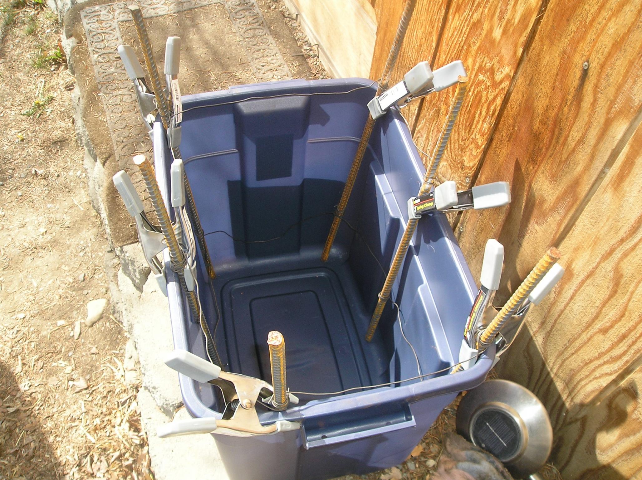

    I've been derusting parts with electrolysis for the last few months. I started with rebar anodes and then moved up to steel plates to get the amperage up. Of course, the steel got covered with **** pretty fast and the amperage went down. I had to clean the anodes several times to keep the amps up.
    Then I read somewhere about using carbon anodes. I had some large carbon brushes out of a huge industrial generator handy and used them. What a difference! No cleaning required and the amperage stayed up for the whole derusting process. My brushes were fairly soft and did break down some leaving the water black, but as far as I know carbon isn't toxic waste. Hard carbon is supposed to be better, but what I had was free.
    It appears that carbon works as well as stainless without the nasty toxic byproducts.
    Mike

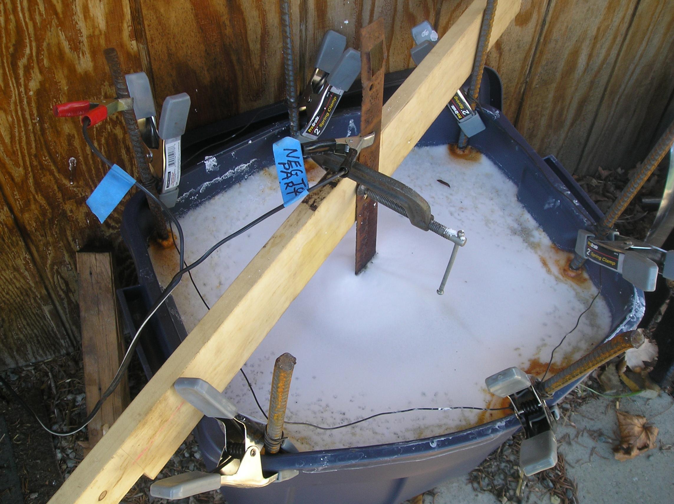

  10. experiments derusting at higher voltages;
    I used a small dc inverter welder and battery chargers in different configurations. The welder put out the most voltage but I was afraid to leave it running without being nearby. I used a car start charger set on start for high voltage. Also two chargers connected in series for doubled voltage.
    The size of the anode matters I forgot to clean the anode often so higher voltage seems to compensate for that. Don't let it short out, I cooked one battery charger that way.
    The plastic screen is a great idea to prevent shorts.
    Thanks for the several good suggestions, I will try carbon anodes, [if I ever find big chunks of carbon] I could not find washing soda so I made mine from baking soda in an oven at 330 degrees [30 minutes on a cookie tin.]
