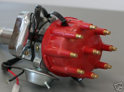

    let me get an answer on this kind of wiring for this particular distrubtor.
    I know I have to use a coil.
    1st question do both wires conect to the coil? red to (+) and black to (-)? Or, is it wired red to (+) and black to ground?
    2nd question. Does the keyed ignition wire go to the (+) or the (-) side of the coil.

    ford 302
    knockoff brand ebay.

    About a month ago, I installed a Pertronix distributor with Ignitor II and a Pertronix Flame Thrower coil on a Ford 302. Ran the red wire from the dizzy to the (+) side of coil. Ran the black wire from the dizzy to the (-) side of coil. Ran the keyed ign wire to the positive side of coil. All is good.

    "You will need some kind of ignition module."
    it is on the underside of the distributor. It is HEI.

    I have the same dist. Seems to work good.
    Black wire. - side of coil.
    Red wire. + side of coil
    + side of coil to 12v ignition sw.

    I installed it and the o-ring is too small I am going to have to find a larger one if I can - because the distributor is wobling back and forth at the bottom. I replaced the oil shaft thinking it was bent or worn. No way to check the wear on the gear drive in the oil pump without a bunch of work. By the way...The distributor fired on the first try, 180 off, kaboom. Next try it runs but, the wires I had were older and I had cross fire. New wires installled. I might move up to a stronger coil. Now I have 14 ( I had 22 ) inches of vacumm and the motor does not rev up ( it was purring ). I suspect the power valve is flooding the cylinders because my plugs are wet. Can a back fire blow out this valve. I do not have a vacuum leak I checked.

    Bottom Line.
    The distributor was defective. It was returned to vendor. I opted ato use a PerTronix Ignitor for Ford 8 Cylinder. Runs beter than ever. Thank you everyone for the input.
    Midnightoilgarage was right on the money. It did not work.
    Cheaper parts are not good parts. Tried to save a few bucks spent 3 times the cost of one pertronix ignitor.
