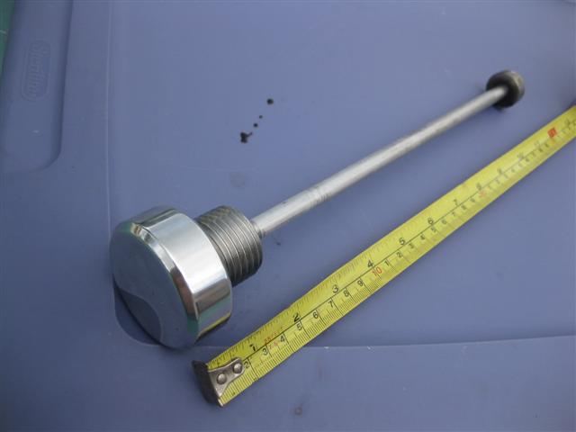

    Bruce, I'm running my 8BA with the pushrod cut down as you suggest, and it works ok. Bushing still in place, and if some need arises to return to the stock configuration,
    it's an easy fix.

    As for the fuel pump push rod bush the easiest way to block it, if running an electric pump to stop oil splash up your breather is the install a core plug, the core plugs used on the early SBC rear oil gallery passages are the correct size, can be knocked in place without removing the intake.

  15. On my 32 with the flathead V12 I have the mechanical and an electric fuel pump to primer the lines than switch to the mechanical. On my 53 Flathead I installed an electric fuel pump and illiminated the mechanical with a plug similar to a small freeze plug.
