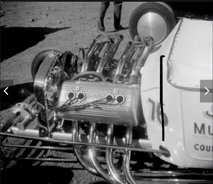

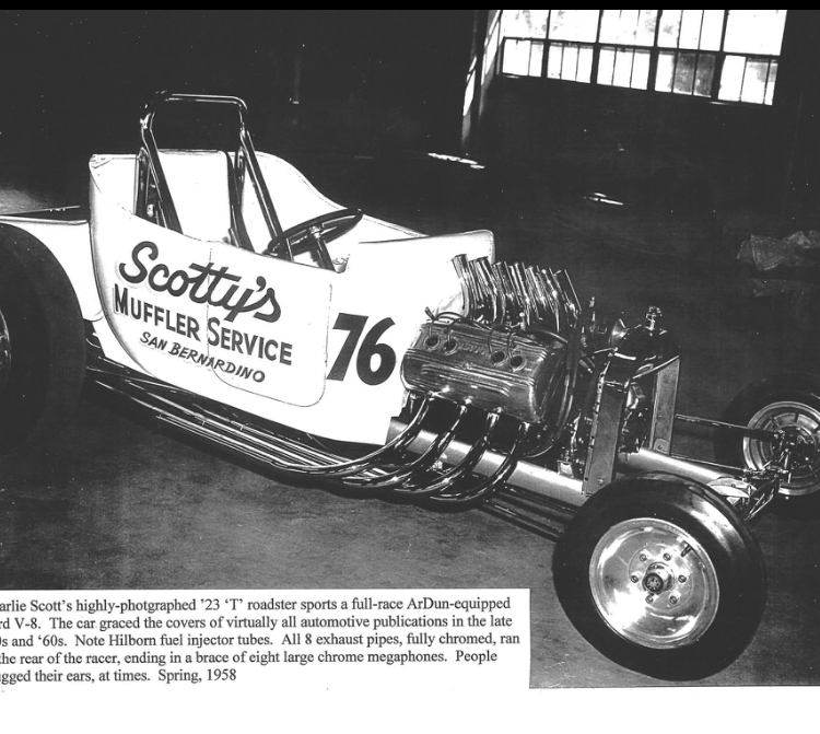

    Im just getting started on this new project And would like to start by getting the ch***is started. I’m having difficulty sourcing the elliptical tubing I need to re create this hot rod. I didn’t think it would be this much of an issue sourcing it but it’s proving to be very difficult to find. So far I’ve actually only found one place that said they could produce it but it costs 3K for them to tool up for a run plus the cost of the product. I’m not totally against doing this but they also said they are 8-10 weeks out as well. So a few thoughts I have are, if I have some made would there be enough demand to have some extra made that I could sell to help offset the costs? Then I would need to spec out the tubing itself. Off the top of my head I figured it would be made from 3” DOM and probably .095 wall would be sufficient in strength? I believe this would end up with tubing that would roughly be about 2” by 4” give or take? Maybe some of the ch***is builder guys could chime in on this? In doing the research for this project It’s said that this tubing was used for PBY wing struts. I haven’t been able to find any specs on what that tubing actually was sized at but I would expect it was 4130. The car I’m building is only going to be for display purposes but I would want it to be of sufficient strength that it could be driven.
    My next thought would be maybe I could take 3” tubing and run it through a set of dies and try to make it myself? I don’t know how hard this would actually be but I would expect it would take a good bit of thought to do it well. Anyways? Here are a few pictures of the ch***is showing the elliptical tubing I would like to hear some opinions on what approximate size you think this actually is and what wall thickness it would take to be sufficient for this type of project. Maybe some other ideas on how to accomplish this or maybe locate some I haven’t thought of yet. I’ve been searching aircraft suppliers like McMaster ETC…. And googling tubing and steel suppliers. So far with no luck other than the steel mill in Louisiana I mentioned. I’ve found some exhaust tubing that is oval shaped that’s 304 Stainless I think, but it’s only .065 and not really the shape I’m needing anyway. Anyway, here are a few pictures that show the tubing I’m needing to duplicate I’d like to here some opinions on what sizes and wall thickness you think this would be and/or need to be to be structurally sound to use for a ch***is like this. I would also like to hear what anybody thinks the estimated wheel base is on this car. I’m ***uming around 104-110 maybe? Thanks in advance. IMG_4667.jpeg IMG_4602.jpeg IMG_4596.jpeg

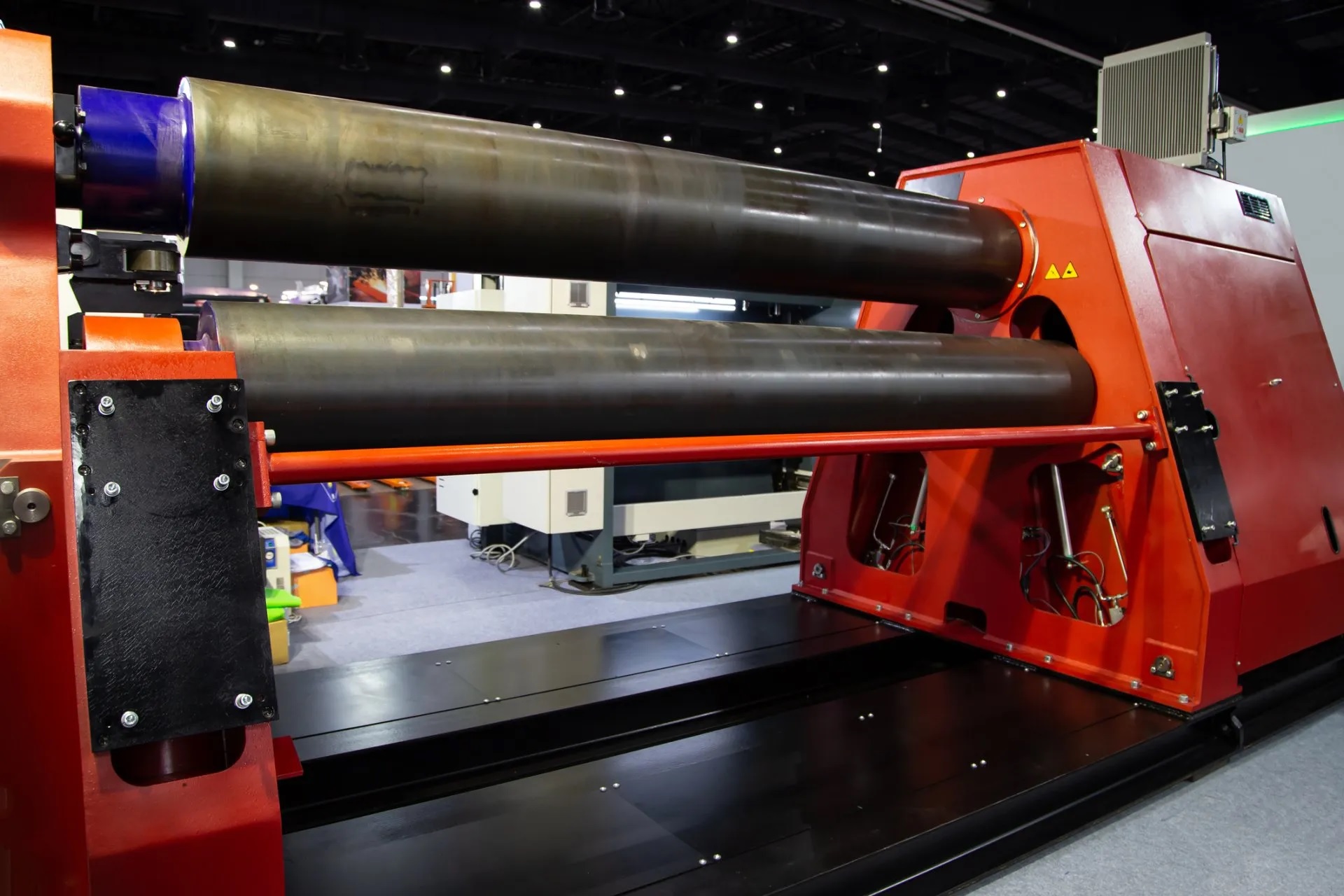

    Flatten round in a roller ? I worked at a shop that had a roller that could have done frame rail sized stuff. We sent bigger stuff out all of the time. Mostly box, round, I-beam and angles into curves and circles. I'm pretty sure a machine that can roll I-Beams could do it, with the right set-up. Mike

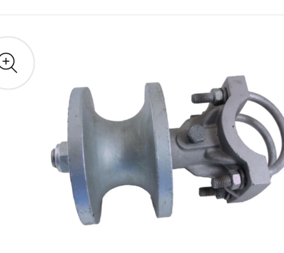

    I work for a fence company, we use some pretty heavy rollers on our cantilever gates, I could try to turn them down in a lathe to get the profile but it will take a hell of a fixture and a lot of force to draw it through I’d bet IMG_4678.jpeg

    I was thinking of a place more like this https://www.cmrp.com/ or this https://www.nisteel.com/steel-fabrication . One of these should be able to do it
    A 3 1/2 round would be just about 2x4 if you flattened to 2 and ended up with ~ 1/2 round (1" rad) ends. It'll put a bend in it, a run through upside down should straighten it. Just a hunch, Mike

    Man, both those places sound promising and are within a few hours of me too. I just imagined the machine that forms it uses a series of round dies on rollers that it feeds through like a big bead roller progressively getting smaller I donno?
    That big roller is crazy!
