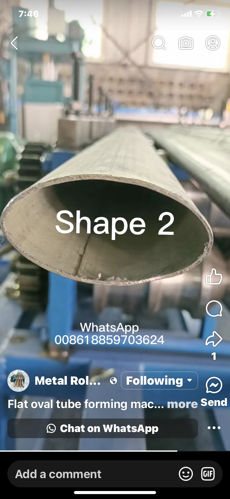

    Searching on the internet I have found a few places (all in China) that appear to either make the machines/tooling or list similar shape tubing but so far I haven’t been able to directly contact them. I’ve also been checking into the possibility of buying a cheaper Rollforming machine but it would need modified to produce this type of shape and I’m not even sure it would be capable of doing this. There are several places I have found that sell flat sided 304 stainless oval tubing in about the correct size but its intended use is for exhaust and is only .065 wall. And even then, it’s not actually the correct shape. I’m waiting to hear back from a place in Iowa called Superior Tube Products but again they don’t actually show true elliptical tube but rather flat sides oval tubing and they are more of a bending and shaping place than a source for small amounts of tubing.
    Here is a picture of one of the Chinese companies that showed the correct shaped tubing (shape 2) for reference and the approx size I need would be about 2 1/4” x 3 3/4”. I am not very proficient at computer /internet type stuff so I’m still hopeful someone will be able to come up with a source

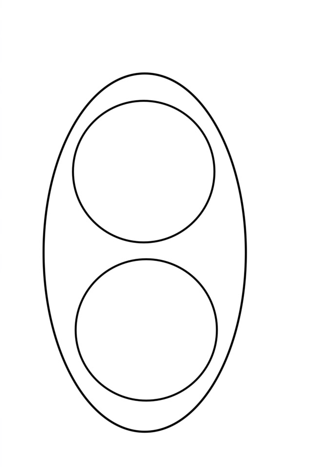

    How about 2 round DOM pipes inside an oval shaped thin pipe? Easier to oval the thin pipe? Use a “form”? “Wrap” the form with thin metal / slip round pipes inside the form(s)?
    Or, 1 round “structural” pipe inside a flattened “non-structural” pipe…
