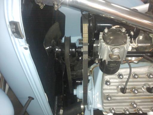

    It will if you run a 32-39 gen and lop the front pulley off.

    On bulls A tudor build which i posted a pic of we ran a stock 46 ford 59ab with the stock fan set up, theres no way you could ever get that to clear a stock A firewall, i mounted the motor 1/2 inch away from the radiator and had to recess the firewall about 2-3 inches, If a guy ran a 32-39 gen on the 59-ab i would think it would be doable, i havent done it that way so i cant say for sure but

    it's for sure doable, Mine is set up that way, unless I haven't figured what's going to screw me....

    u running the 32-39 generator? that should work.
    im just saying the stock fan set up on a 46-8 ford that has the fan pully mounted on a idler will not work. heres a pic of the set up on bulls sedan, if you made this set up work i dont now what i did! someone must have shortened this car then!

    Yep, 32-39 gen on mine.

    I'm actually hoping that I can get a 35-36 low profile fan to squeeze in there.

    Sure with a 32-39 gen/fan it`s easy.
    But no way with a 59AB fan setup.

    sorry, should have been more clear in my original post....You can make a 59ab fit with minor mods....
    BTW Elrod is that a supercharger snout I see?
