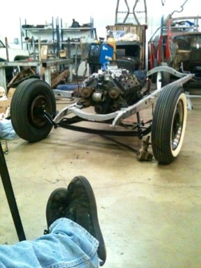

  4. Elrod
    Joined: Aug 7, 2002
    Posts: 3,566
    Elrod
    Hitchhiker - Those are 32 wishbones. I believe the longest. Really put them close to the F1 cross member for an easy bracket build.
    Thanks Chris! I felt much more comfortable moving forward with the drive line swap after seeing some of your work. I'm also planning on using the cut off A rear spring perches on my 38 rear end that I saw in your roadster build.

    Next up on the list is to figure out where the steering column needs to go in relation to the new dash and the mounts in the frame. To do that, the body has to go back on. A little tricky to do with just two people, but we did it with no problem.
    I was really excited to see my old coupe now proudly displaying a flathead engine. I just kept saying, "Oh, man! Holy ****!" This is really going to be cool, and I'm really happy that I had a few beers with Anderson and he suggested we start taking my car apart! haha. This is going to be really cool.
    Another good feeling is that we NAILED the engine location in the frame. It couldn't have been more perfect. I really didn't want to cut the firewall and it now looks like we wont have to.
