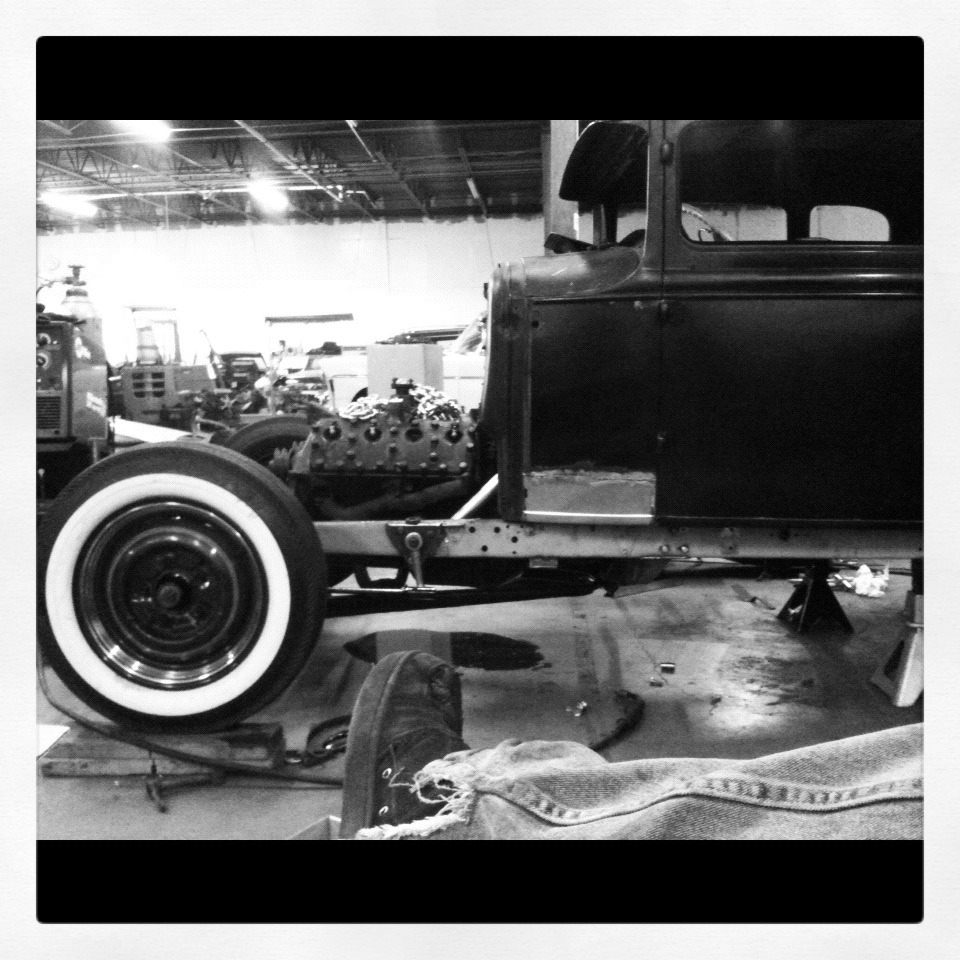

  3. Anderson
    Joined: Jan 27, 2003
    Posts: 7,560
    Anderson
    Tomorrow. Seat belt crossmember installation. Body removal from ch***is. Finish rear brakes. Paint frame, re***emble bad *** ch***is, drive said ch***is around the parking lot. Working on cars on a Tuesday night?? Whodathunkit???????

  10. Anderson
    Posts: 7,560
    Anderson
    The little **** eats it up. Mount for clutch pivot shaft ball made. Steering arm modified and on. Drag link figured out. Exhaust eyeballed. The only thing left on the frame is to cut and install the crossmember for seat belts.

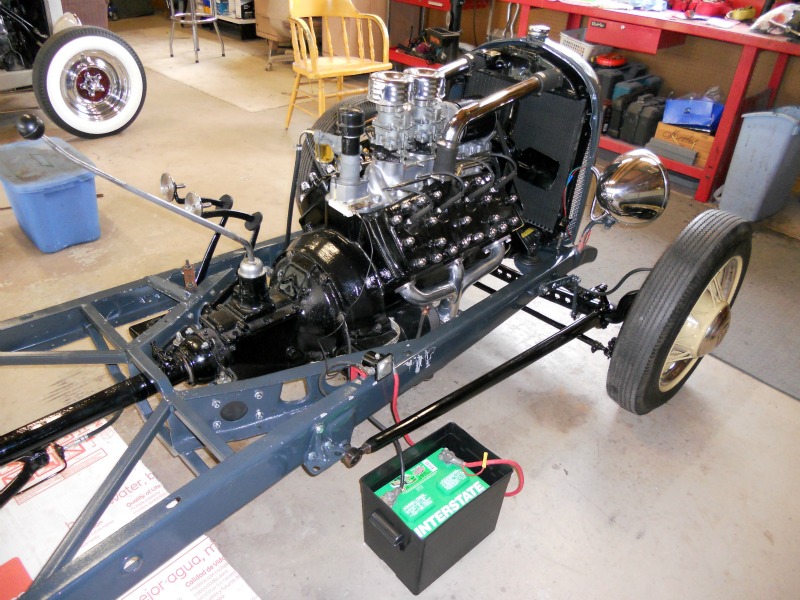

    Joined: Mar 11, 2002
    Posts: 575
    Garry Carter
    I'm totally impressed ... and will be looking for you and the coupe at Roundup! I had some thoughts about bringing my `28 A-V8 roadstr to Roundup as a "work in progress" but ultimately decided I didn't want to take it all apart yet another time after I got home. I'll just shoot for having it in presentable form in time for the Revolution. But I do have it far enough along that I can crank it up and listen to it at will -- that's my motivation!!
    See you in Austin!
  27. Elrod
    Joined: Aug 7, 2002
    Posts: 3,566
    Elrod
    Looks awesome Gary! Do you have a drivers side photo of how you did the headers on that side? What steering box are you running?
