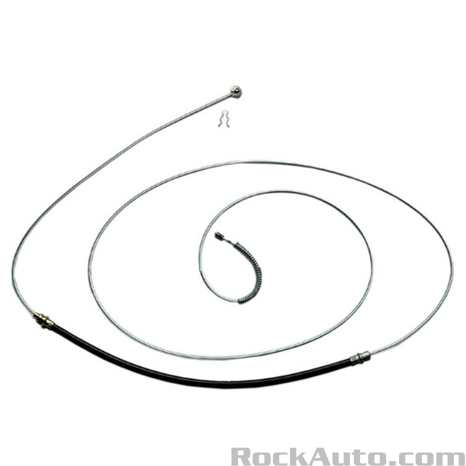

  11. nobby
    Joined: Jan 8, 2006
    Posts: 1,366
    nobby
    if you have nothing at all...
    IF you have 10'' rear brakes small bearing
    buy two of 1970 mustang rear right cables - rock auto cheap.
    the internal spring needs to be the correct length for the actuating arm
    the rebate or spigot or doofer in the backplate needs to be correct.
    the length of the bowden or the outer sheath of a 68 mustang is just right IF you have a leaf spring kit as you can mount the stop for the bowden on the front leaf spring mounting.
    the inner cables are longer than a stock 36/37 up cable ford
    locate the rear x member brake swivel from a 37 38 - or whatever ch***is and fit to yours
    use the oringinal ford female threaded heim
    i forget what size thread it is i think its 7/16 unc
    make sure you have stainless steel cables, buy two stainless steel bolts
    bore them in a lathe and cut the cables to fit into the thread - chop the head off
    both swedge or swage them on with some heat, and put a tiny bit of stainless weld if you dare.
    use a oriinal ford front handbrake cable
    find a 37 - 38 dash mount parking brake lever
    you will need to modify it to fit the 35 as the dash is shallower than a 37
    this ay the lever is oooooooooot the way
    the rear cable will not go through the frame like an original 37 IF you are running an axle of 57.25 inches wide
    IF however you run a 59.25 you can
    it also depends on how low the car is as the angle of attack from the backplate is in a much different opsition than stock.
    you do i think need the articklemalation from the same position of the suspension
    or stock a 70 mustang leafspring from axle centre to front mount is 2 foot, the distance of the oputer cable will land it in the same plane
    bowden and inner cable lenghth specs#
    More Information for RAYBESTOS BC92452 (rockauto.com)
