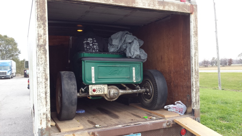

    My son bought a cheap box van for hauling his T bucket when he had it. We just made some simple 2x12 ramps reinforced with some angle iron on the bottom and then supported with a couple jackstands in the middle. Winch in the front for pulling it in. Insurance was a pain though, everyone wanted to charge a commercial rate. Can post pictures later if you're interested.

    Bought the van for $1000. We added the 2x12 runners on the floor, made the "steps" to help getting over the wheel wells. Added a frame work for a receiver type winch mount in the front and tie down loops front and rear. Pulled it in with the winch and normally just backed it out. Slid the ramps in under the car.

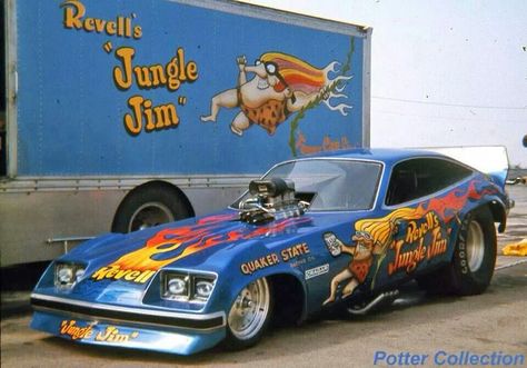

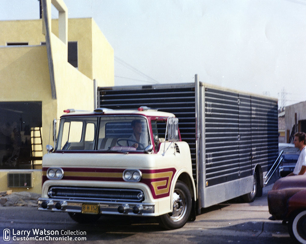

    Grumpy prostock11.jpg GS truck-n- trailer.jpg GS larry-watson-truck-10-W.jpg jungle jims hauler.jpg jungle jims haulr big truck.jpg The big Red truck is a Grumpy Bill Jenkins Pro Stock hauler from the 70's. The next 2 pictures are the Ford Cab over Customized by Larry Watson to haul the Golden Sarah and "Kookie Car"
    Where is this hauler now ?? The white truck with the red spots is an early JJ rig. The last (sorry 4 the off topic racer)...Jungle Jim's (JJ) mid 70's Box truck/Ramp truck Hauler. All "Box Truck/ Ramp Trucks...

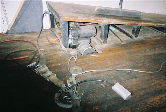

    Inside of Grumpy's hauler.

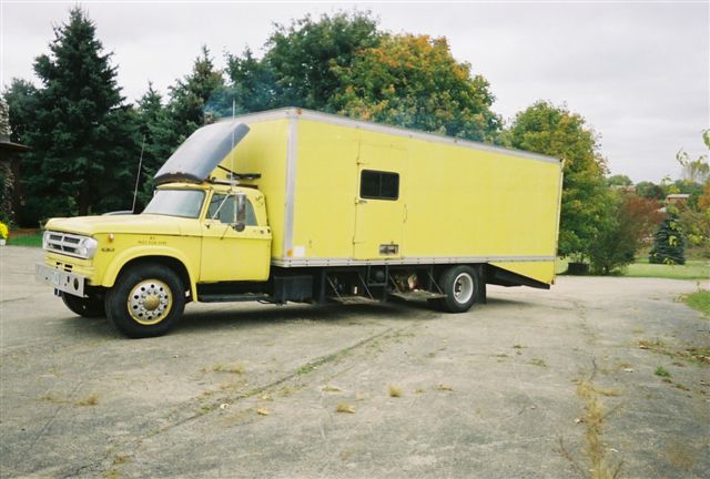

    Ex-Sox & Martin hauler...
    ExSox&MartinHauler_01.jpg ExSox&MartinHauler_02.jpg ExSox&MartinHauler_03.jpg
