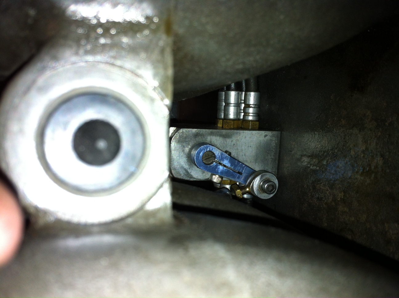

    Forgot the pic

    I had almost the same problem with my stack injection turned out the spool in the BV was 180 degrees wrong way, loosend the arm and rotated one half turn and voila..... it runs like a dream. There is a number stamped on the edge of the axle (in my case 54) the number should be on the left side of the axle when the slot is pointing up/down, or on the wider side of the BV if looking on the top of it.
    My pic shows the number before i changed it. You might have to tilt your computor to wiew it correctly...... :)
