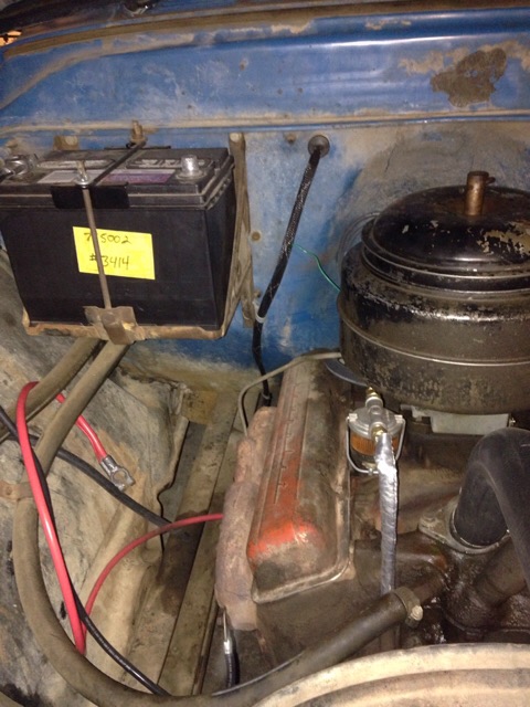

    I picked up heat shield tube from grainger. It is pretty cheap and easy to work with. It stretches so the wires fit in and the you can pull it to tighten up. It makes my engine bay look neater. Not sure if you can tell from the link but it has a cool Diamond pattern in white contrasting the black. I can post a picture of my engine bay when I get home.
    http://m.grainger.com/mobile/product/TECHFLEX-Techflex-TM-1UXY1

    ImageUploadedByH.A.M.B.1418870712.680644.jpg ImageUploadedByH.A.M.B.1418870725.278586.jpg
    Not the prettiest engine bay but miles away from where I started. I haven't finished the tube joints and I don't have the heart to remove the throttle/choke 235 remnants yet. I picked up the little white wire hangers off of evilbay.
