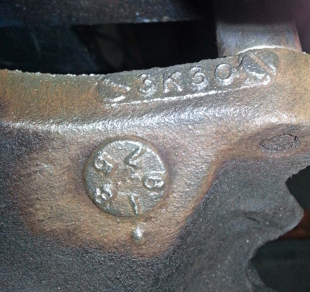

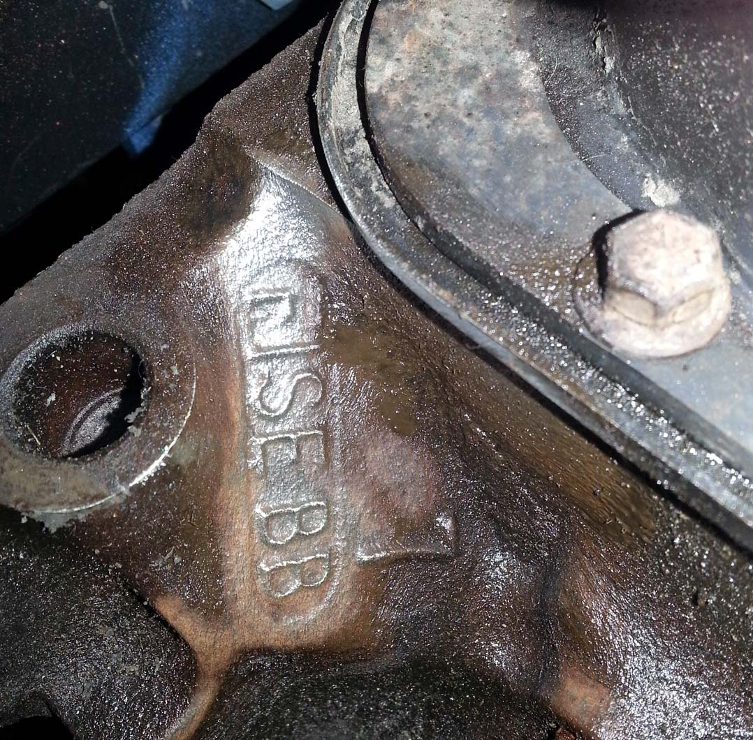

    I'm trying to find out the year of my 302 engine? KJ
    Block ‪code: ‎F1SEBB‬

    F1 is 1991, 3 K 30 is 1993 November(?) 30
    is my guess....but I'm not very good with Fords. I could be off by ten years or more.

    That's the "engineering number" The casting date code is 3 K 30, which means 3=19x3 year, K is the 11th? month, 30 is the 3oth day of the month. So it could be from a 1994 Tbird.
