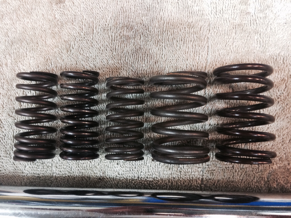

    This picture shows 53-56 322 from left to right.
    Sealed power inner with 9 turns
    Falcon inner with 10 turns
    Stock Buick inner (quite abut shorter)
    Stock Buick outer ( again shorter )
    Falcon outer
    Not pictured is the Sealed power outer, it is similar to the Falcon but had one less turn.

    I'm really concerned about your springs in your very first pic's. It's clear that the outer springs last wind and where it thins at a taper to creat the flat is bad new's. Some of the retainer's are clearly not square/parallel to the valve spring seat. This can cause keeper failer to happen not to mention unwanted side load on the valve stems. Yes I know gang, the springs are the top thing to blame but I don't think I read this mentioned before. Just further reason to dump those springs.
