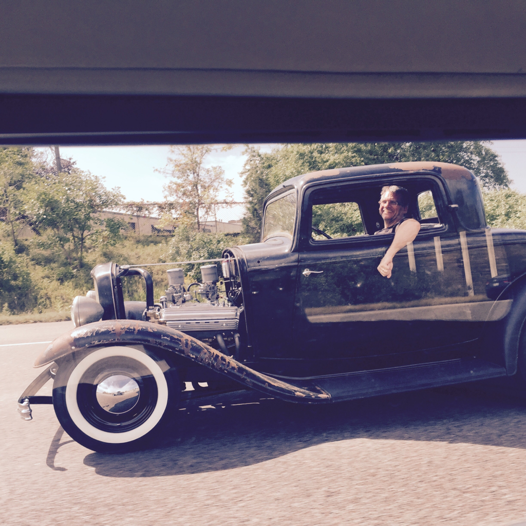

  3. Roadsir
    Joined: Jun 3, 2006
    Posts: 4,054
    Roadsir
    My smile here says it all. Thanks for the pic Craig!

    Runs a little better now that the valve springs actually compress, eh?:D WOOHOO!
    And to think you were ready to give up and put a (eww, ech! Blach!) flatty in it!:eek:;):p

    A man and his hot rod. F*ckin' awesome!

    Seeing that **** eating grin on your face even made me smile :D:p:cool:

    Awesome picture, glad you sorted out the valve spring issue.
    Driving the car makes it all worthwhile. :cool: Larry
