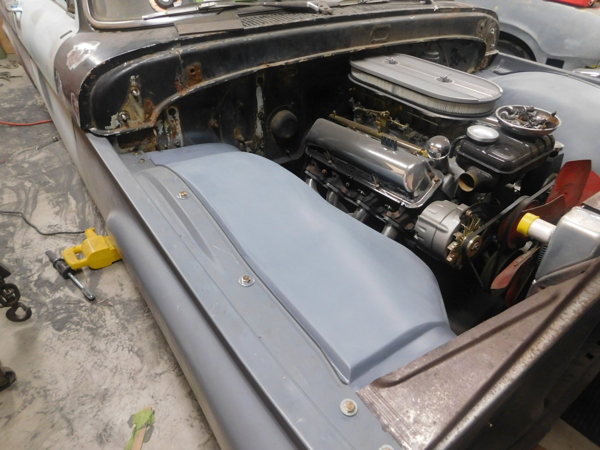

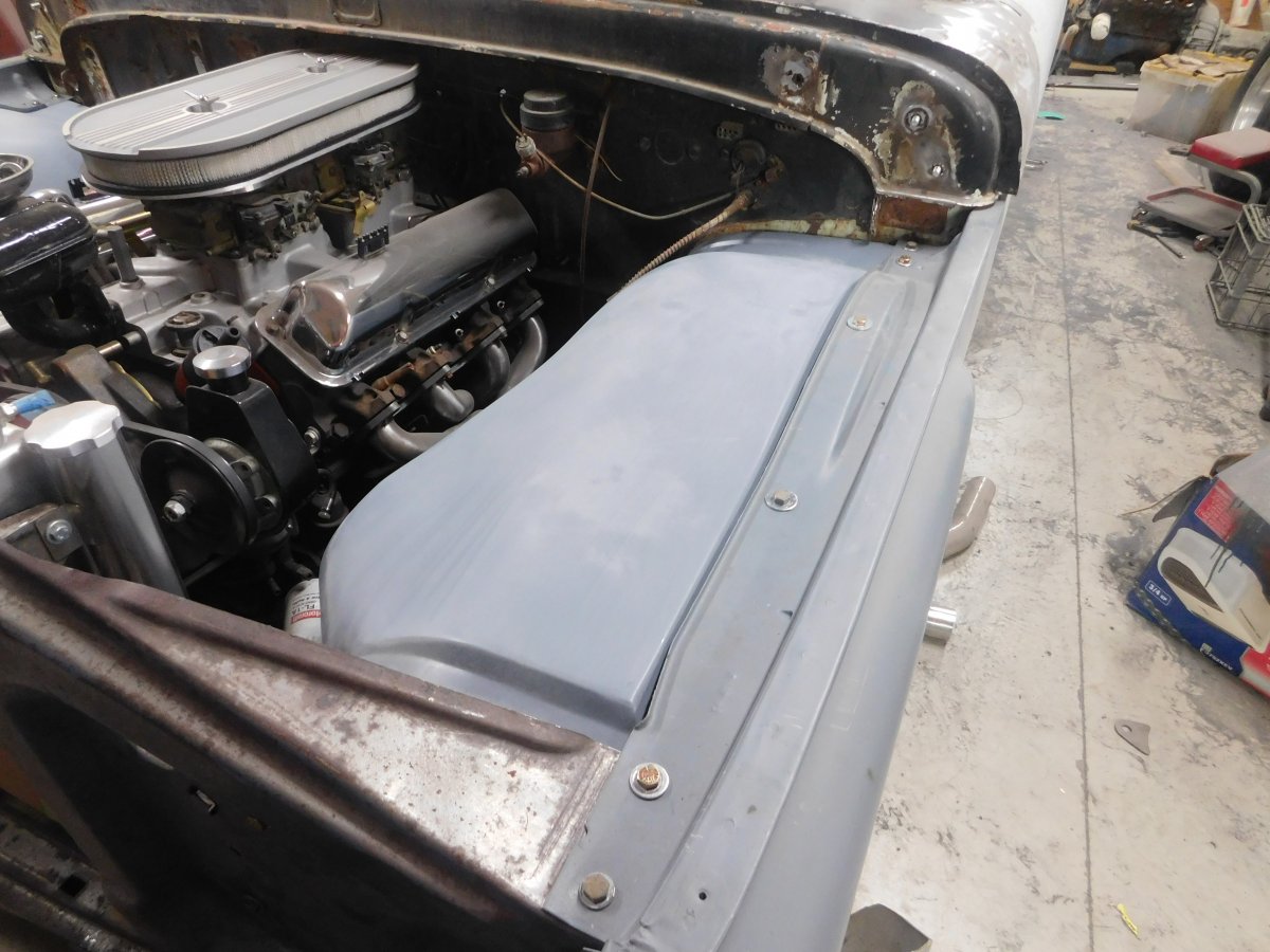

    B3A27EC8-6560-455D-A024-EEB52E905C88.jpeg 042685ED-BF9A-4BA4-A382-E315BF5B8FCB.jpeg I did a y block in my 61 unibody, had a 223/ 3 spd. Would be the least amount of modifications as all parts are out there, you would need to get the truck v8 bellhousing and front frame and engine mount, as well as the clutch bell crank, everything else would be a matter of taste.

    A complete 302/C4 would be the easiest thing to put in it. Cheap, small, easy to find parts for and easy to mount. Put a 289/C4 in my '57 with Speedway mounts (structurally the trucks are very similar). Easy to do. I hate adding another crossmember lite the one shown above. Gets too cluttered. I went with this one: https://www.speedwaymotors.com/Spee...351W-V8-Engine-Weld-In-Motor-Mounts,1376.html
    I put a 390/C6 in my '61 uni but it's also got IFS, rack, disc brakes, 4 bar rear, etc. Wouldn't recommend an FE for these trucks. They fit fine but the extra weight will make it harder to steer with the manual steering/beam axle setup.

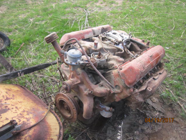

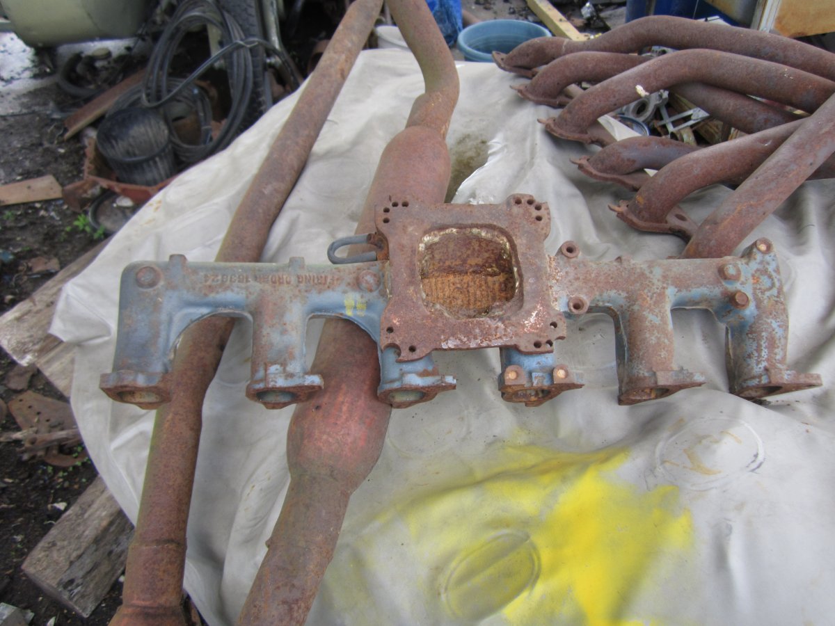

  24. Keep it up and you might have to deal me out of my collection of Y block engines and parts. Im interested in FE aluminum intakes and 411 and steeper 9 inch gears. and of course a 428 stick flywheel!

    I’m going to get over in your area sometime and relieve your of your “ boat anchors” lol. I’ll bring that cylinder boring bar! I’m too fond of my FE stuff! !!
    I do have about ten sets of nine inch gears, I’ll check and see what the ratios are!

  27. I would suggest finding a good running but rusty 67 thru 79 ford truck that has a FE and a stick trans. I addition to the FE. You get a V8 Radiator. Full syncro three speed trans. 11 inch flywheel that uses the 65 and newer type starter. Alternator and all the pulleys. The newer trucks will have valves and seats compatable with unlead fuel. and electronic ignition. You could even use the exhaust system. With a Y block you have the long snout starter. Generator. Valves that don't work well with todays gas. A engine that is not fuel efficient. I fully intend to pull the 262 from my 55 ford wagon and install the stock $100 -390 -62 T bird engine in it. I keep hearing about the super fast relatively stock Y blocks. Im 68 and never owned or seen one yet. When I get the 390 in the 55 ive got a grand that says a relatively stock Y block cant beat it in the 1/4 or top end.
  28. I could sell your exhaust manifolds for enough cash to by a running truck that has a FE and stick trans. A junkyard at williford Ar has a long row of complete trucks that RWP. for $500 your choice.
