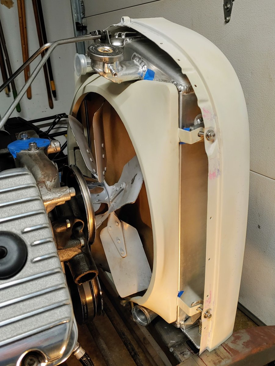

    To work at max efficiency, the opening in the shroud should sit right at the fore/aft center of the fan blade. You may want a fan blade with more blade pitch. The flatter the pitch, the less air movement. If you live where summer weather is hot, you should change to a lower opening temp thermostat. If you are going to use a cut down fan, pay close attention to balance issues. An out of balance fan can cause some really bad problems. The chrome fan you have does not have enough blade left to move enough air when idling. Increasing the fan speed by changing pulley sizes may help a little. not enough to do much good, though. As much as I hate electric fans, that might be the way to go. If you do, don't spare the bucks. Get the highest air flow and quality you can get. You can mount that up in the middle of the radiator where it needs to be, and no cross member problems, You can also install a switch in the circuit so you can turn it off at highway speeds, where you don't need a fan at all. They tend to be noisy. A little hint: Lower temp stat and drill a 1/8" to 1/16" hole in it to prevent steam pockets in the hottest part of the engine while warming up.

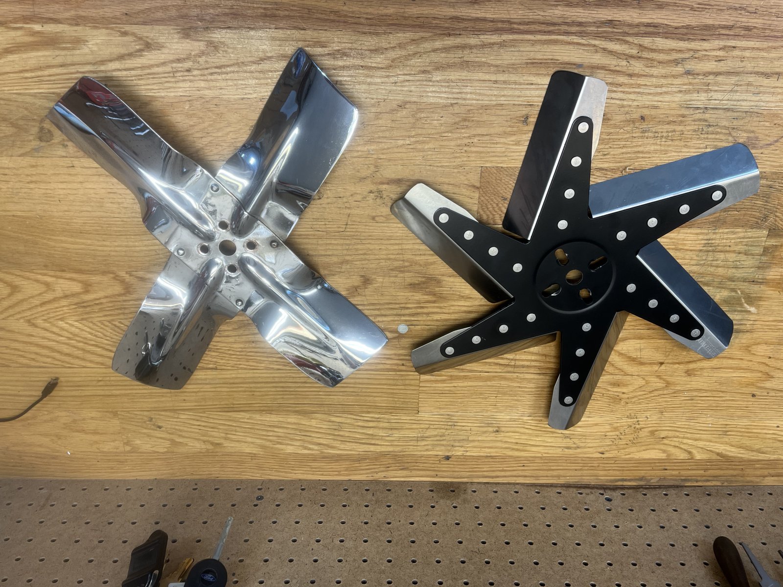

    Overheating is generally an air flow problem or water flow problem.
    You have increased the water capacity by fitting a larger capacity radiator, with four rows of tubes.
    If it is overheating stationary and the temp gauge goes down as soon as you start moving (increasing the airflow thru the core of the radiator), it is a airflow problem.
    Both the original 4 blade factory fan and that 6 blade flex fan are not great at pulling the air thru the core.
    Despite the flex fan making a lot of noise, it is not much improvement.
    But yes, fitting the six blade fan along with a fan shroud will improve the efficiency of your system.

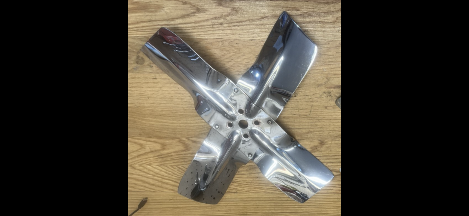

  9. Johnny Gee
    Joined: Dec 3, 2009
    Posts: 14,998
    Johnny Gee
    from Downey, Ca
    When the tips are cut off fan can not work properly. Air is escaping off the tip’s outward. Note the hooked tips on lower pic. 3A0375EE-D27F-404B-8526-1A5405FE7B27.png 8C6E711C-AEE7-4BE6-94A1-AA689B0D6D6E.png

    Shroud - good idea.
    That 6 blade fan - not too good. Personally I prefer Flex-a-lite stainless steel.

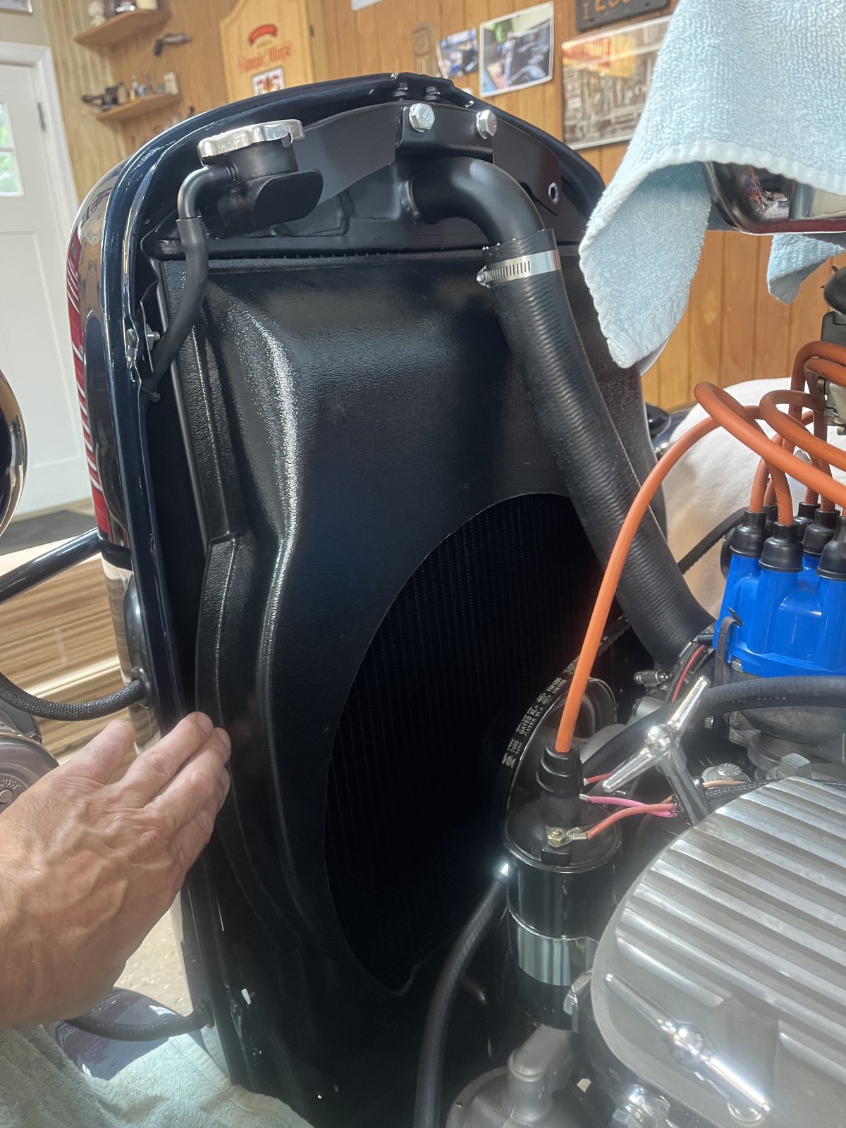

  12. Just Gary
    Joined: Oct 9, 2002
    Posts: 6,049
    Just Gary
    Here it is. The fan is near the center of the radiator and ~ half in/half out of the shroud.

    Wet water is another product for drag racing where engines run for 5 minutes max. I tried some in my Olds engine and it made no difference. Save yer dough for beer! Your fan should sit between. 3/4" - 1.5"
    Away from the radiator and higher up than where yours is.

    My 1932 Ford sedan can sit in bumper to bumper traffic for over and hour and never get above 200 degrees, with the air on!, I run a sbc with a zips riser that centers a 17" engine driven fan that sits in the middle of the radiator.

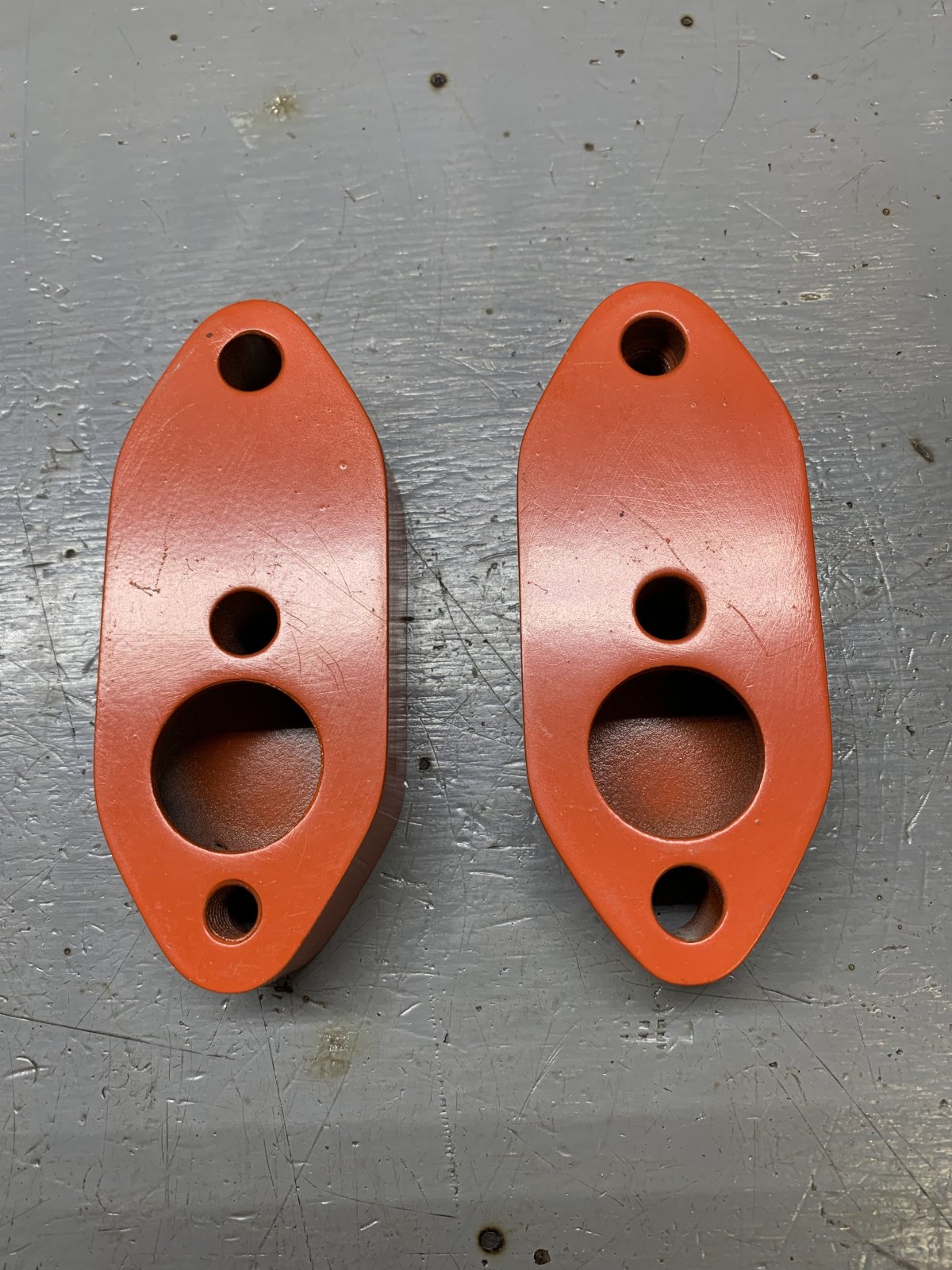

  17. Johnny Gee
    Joined: Dec 3, 2009
    Posts: 14,998
    Johnny Gee
    from Downey, Ca

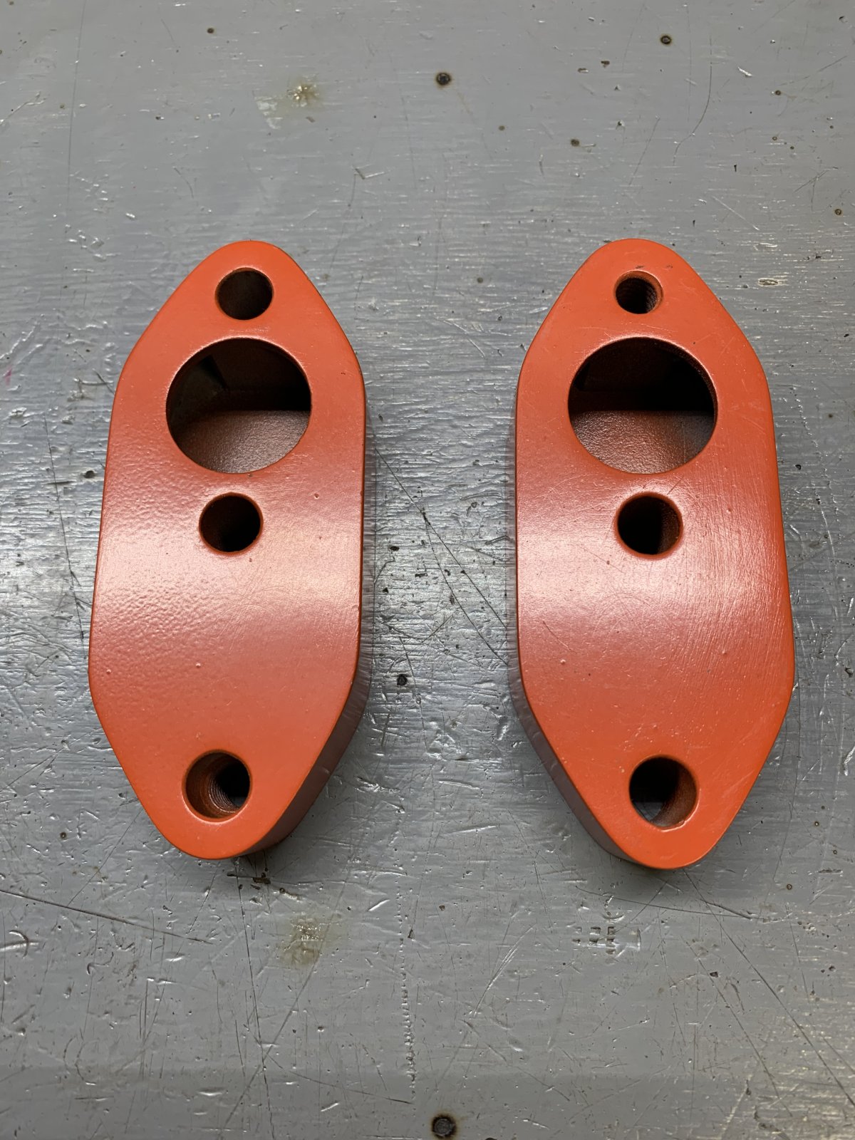

    I can not claim credit for coming up with these but I just had to make my own pair. These will raise a SBC pump 1 3/4”. 321B111F-D0D6-4078-8BBF-24202FAA9D9C.jpeg 55EF9F3A-246F-4988-A36E-87D1122ABF14.jpeg 59C9369D-C694-4492-8FCD-E803682F7574.jpeg

  26. RockyMtnWay
    Joined: Jan 6, 2015
    Posts: 879
    RockyMtnWay

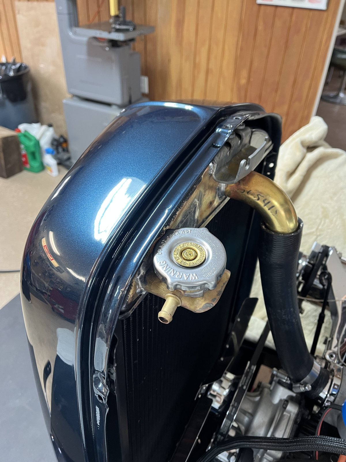

    Best solution I can recommend is a good shroud with the biggest fan you can fit in, but in the past I’ve been known to use a little helper fan (electric) at top of rad to help when the engine sits low or I can’t figure out how to get the water pump higher (like a zips type riser).
    Snapped a pic with a 32 rad and an old little electric fan to demonstrate what I mean.

    That ricky racer 6 blade fan will not move enough air while sitting in traffic to write home about. I had one of those on my 48 for years and when you were at a stop the temp went up and when you hit 25 or so it dropped like a rock. The chrome one will pull as much or more air and with the shroud should actually pull air though the whole radiator rather than a small circle down low on it.
