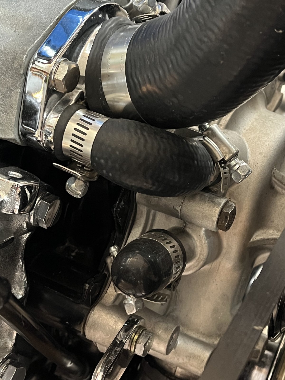

    The heater heater hose fitting is capped. I think this is what you are talking about. IMG_9947.jpeg

    Yes, thats what I was referring to. Not sure if the other small hose needs to be removed and capped as well. What you are trying to avoid is any ability to byp*** going thru the radiator....and maybe pumping in a non-cooling circle. At idle there is less volume being pumped, so if an alternate path is available, some or a lot of that reduced volume may not go to the radiator. Anyway, just a guess on my part.:)

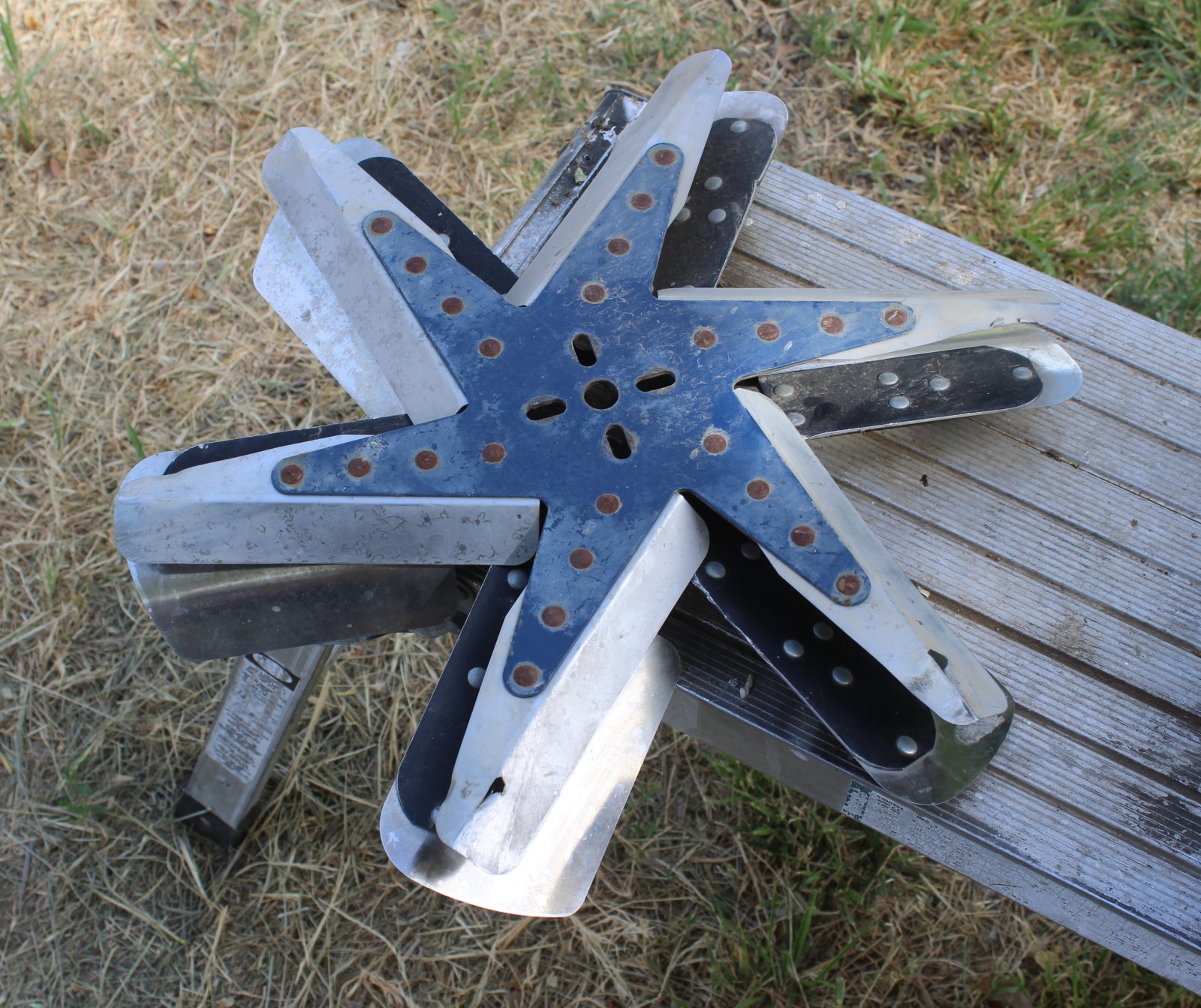

    Those fans are junk and don't move enough air. Get a fixed blade fan or a flex that's not that style, more like a regular flex fan than that saw blade. The cfm of the one you have there is not enough to cool a honda lawnmower.
    Hemi Joel likes this.

    That Ricky Racer fan especially when cut down is not going to pull enough air even with the shroud.. I had one of those damned things on my 48 for years beause yes, it was the only thing I found that fit in the space but just as you found out with the other fan it only covers a small part of the radiator. Exact same issue as you had though, stayed right on the desired temp while moving, temp gauge went up in a hurry at a stop light. Simply meaning that the shroud should help a lot but you still may not have enough fan blade to pull enough air through. Those "race fans " were sold because they had less resistance years ago IMG_1481 (2).JPG IMG_1484 (3).JPG IMG_1485 (2).JPG

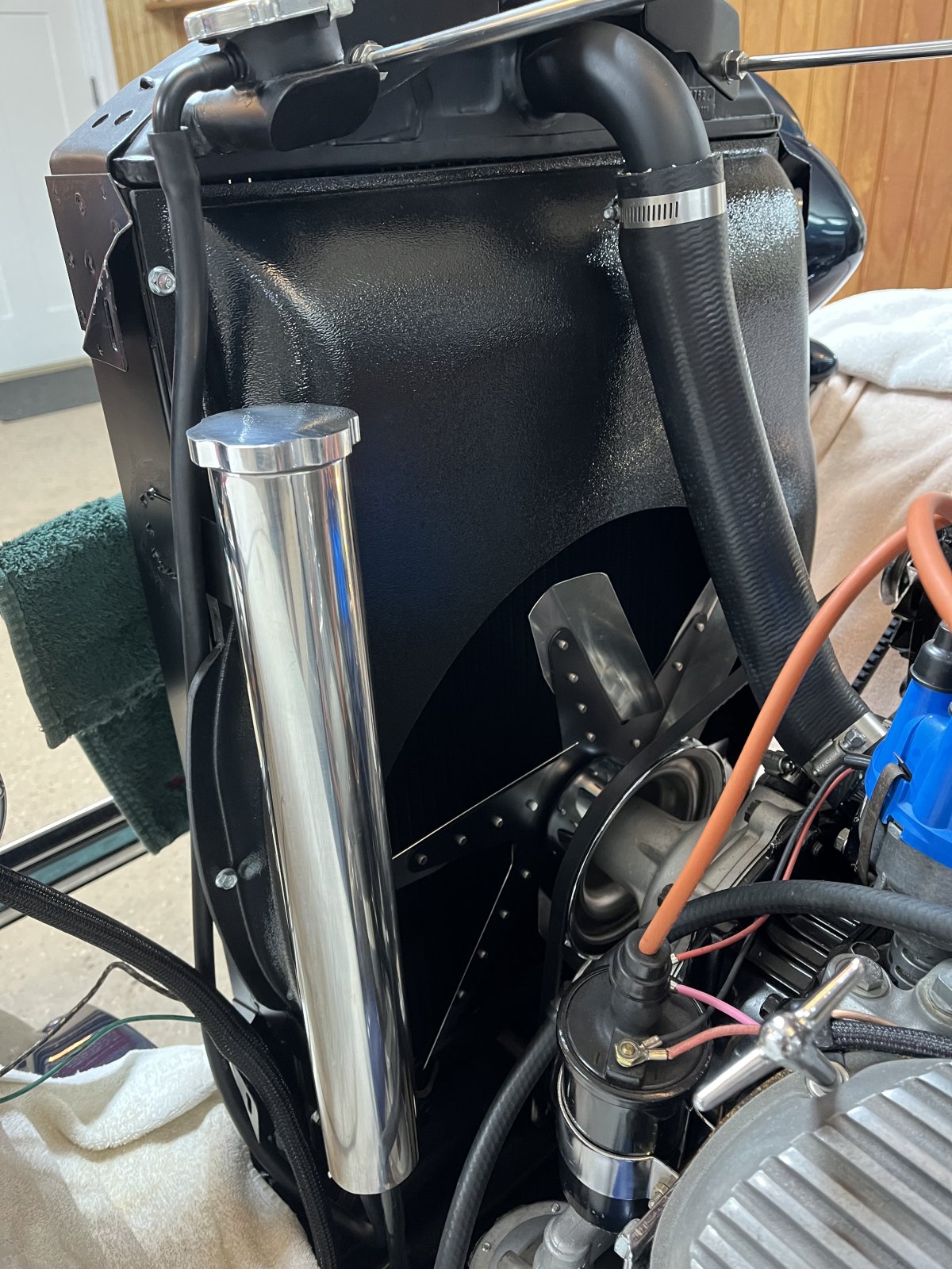

  21. The Fan needs to be 1/4 " from the radiator and there needs to be an air outlet back by the floorboards if you're running a hood. Water Wetter liquid in the radiator can help too and no trans cool in or on the radiator, put it below or behind the radiator somewhere. Finallly no 2 core radiator, you need 4 or 5 cores.

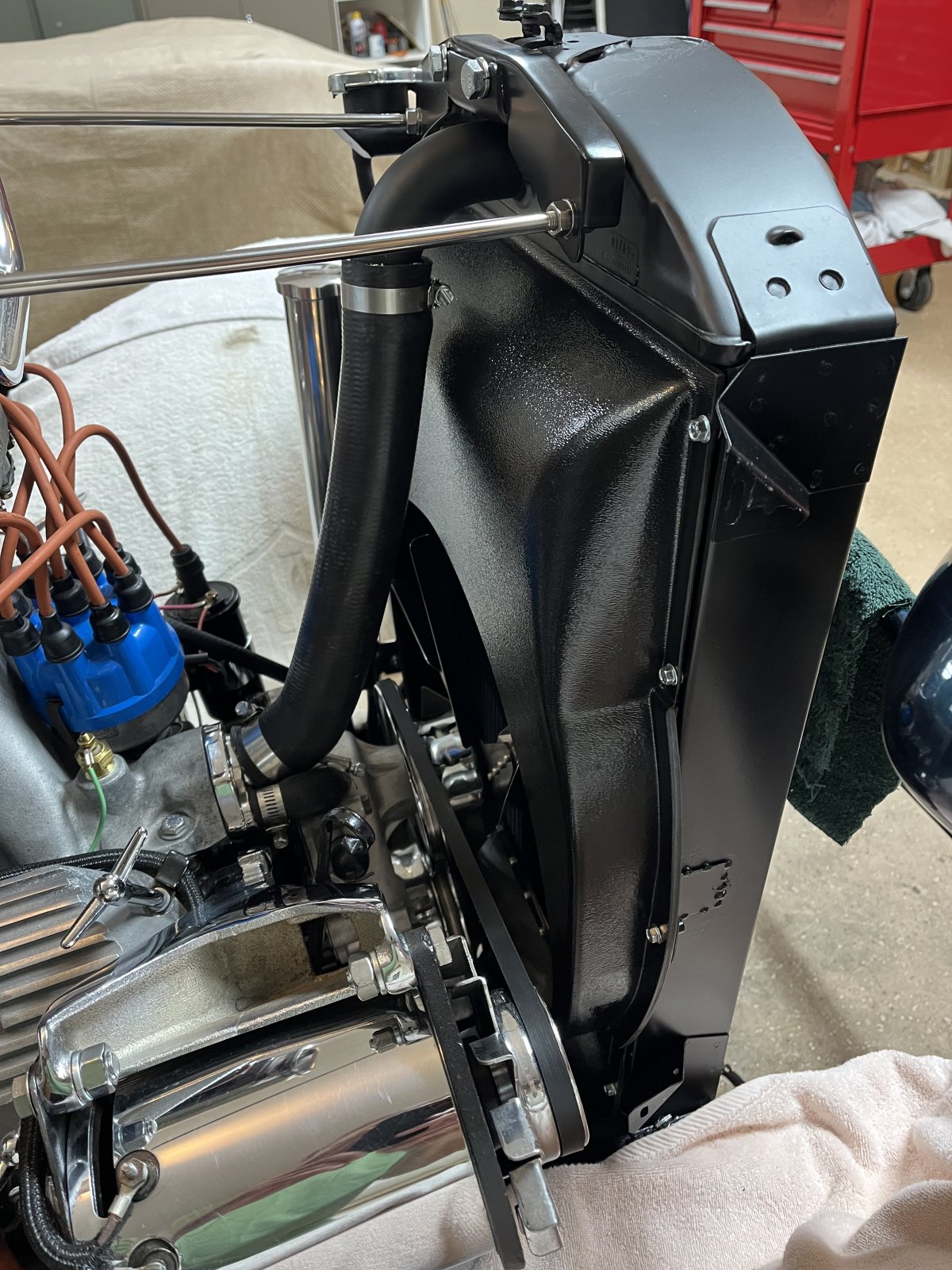

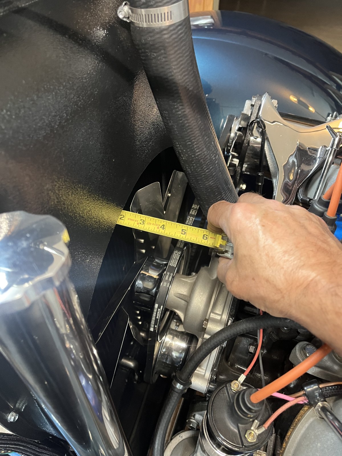

    I drove the car a few times this weekend. The car is running cooler when it is moving,
    it stays about 180 degrees. After a long ride i park in my drive way it gets up to about 230 close to 240. The gauge only goes to 240.
    I plan to try the old four blade fan just to see if it makes any difference.
    I think part of the problem is the blade is too far from the radiator.
    Its about 2" on the top and about 1 1/4" on the bottom. So its not pulling enough air.

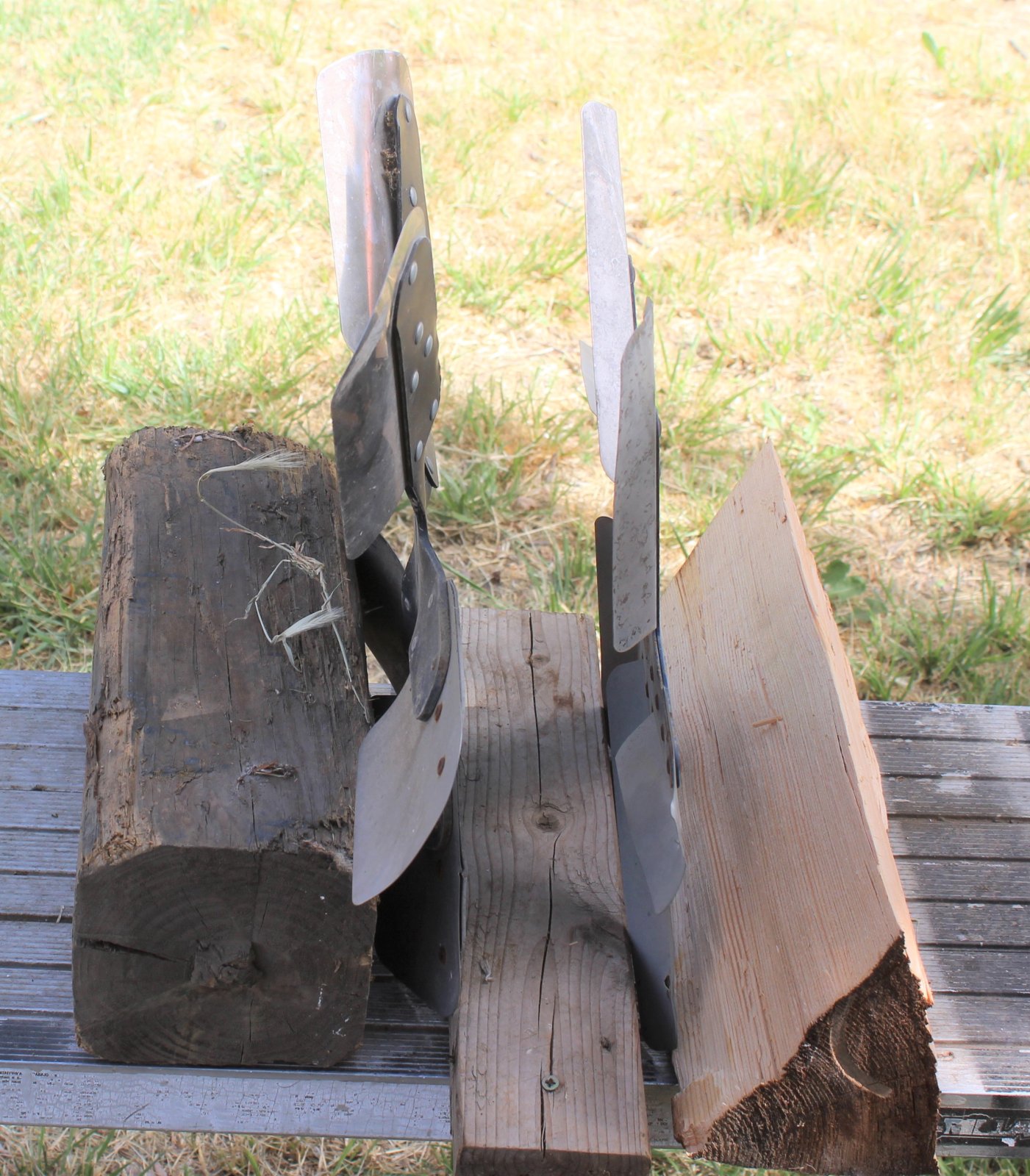

    This blade looks good but it's 2.8" deep i only have about 2"

    The fan you have in pic was designed to be run with a small motor to water pump for cool down on drag use after each p*** ,
    Ditch the skinny fan!!
    The 4 blade im sure mover more air then the Skinny ,,
    A 6 blade will be so much better.

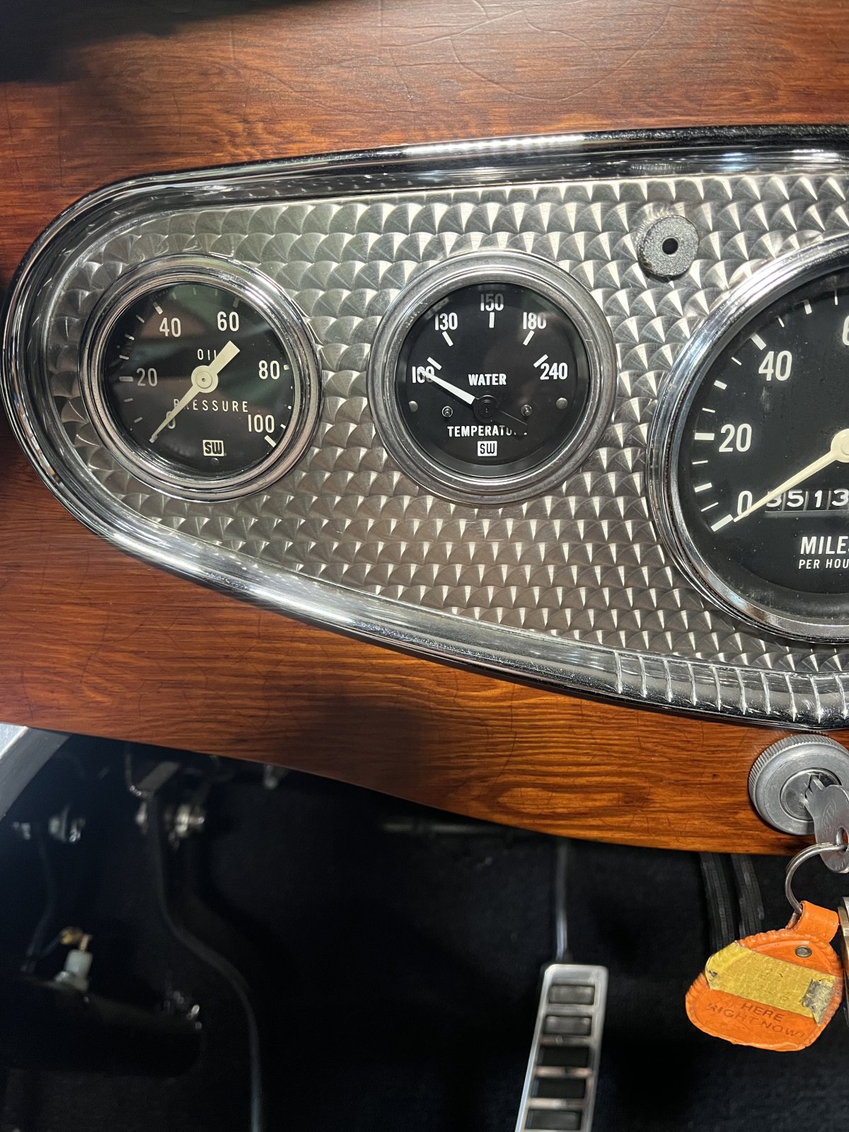

    Your gauge numbers stop at 240 but the peg is much higher. Looks close to 300. Not that I would want to be int he car when it hits the peg. :cool:
    It may have been asked already (I don't read posts, I basically cruise them for pictures of girls and cool cars) but have you tested the water temp to check the accuracy of your gauges? Are those mechanical SW or electric?

    With the shroud it shouldn't matter how far away the fan is, it could be in the back seat as far as the radiator is concerned , the shroud makes sure (almost) all the air the fan moves is ****ed through the radiator. Without a shroud distance is way more important, as any distance lets air sneak in from the side instead of come through the radiator. Some distance is logically good when you have a shroud, you WANT air to enter from the side, as that's the air that was ****ed through the outer areas of the radiator.
