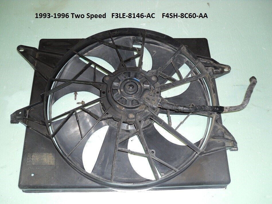

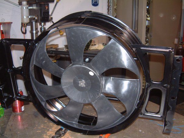

    In my experience 99.999% of cooling problems are air flow related. No need for water-side concerns as long as you have a good stock water pump. On my '36 Willys with a 354 hemi engine there is absolutely zero room for any type of puller fan. Also there is no room for a big radiator. I run a 40s re-cored Plymouth tall radiator with a pusher fan. It cools fine.
    Recently I have used Ford factory 2-speed electric fans from 90s cars (Mark viii, T-Birds) with great results. They move monster amounts of air, more than any aftermarket electric. And they can be placed anywhere behind the radiator. They fit perfectly inside a 1959 Chevy factory shroud too. Guaranteed you will need a winter coat the car will run so cool!!!!

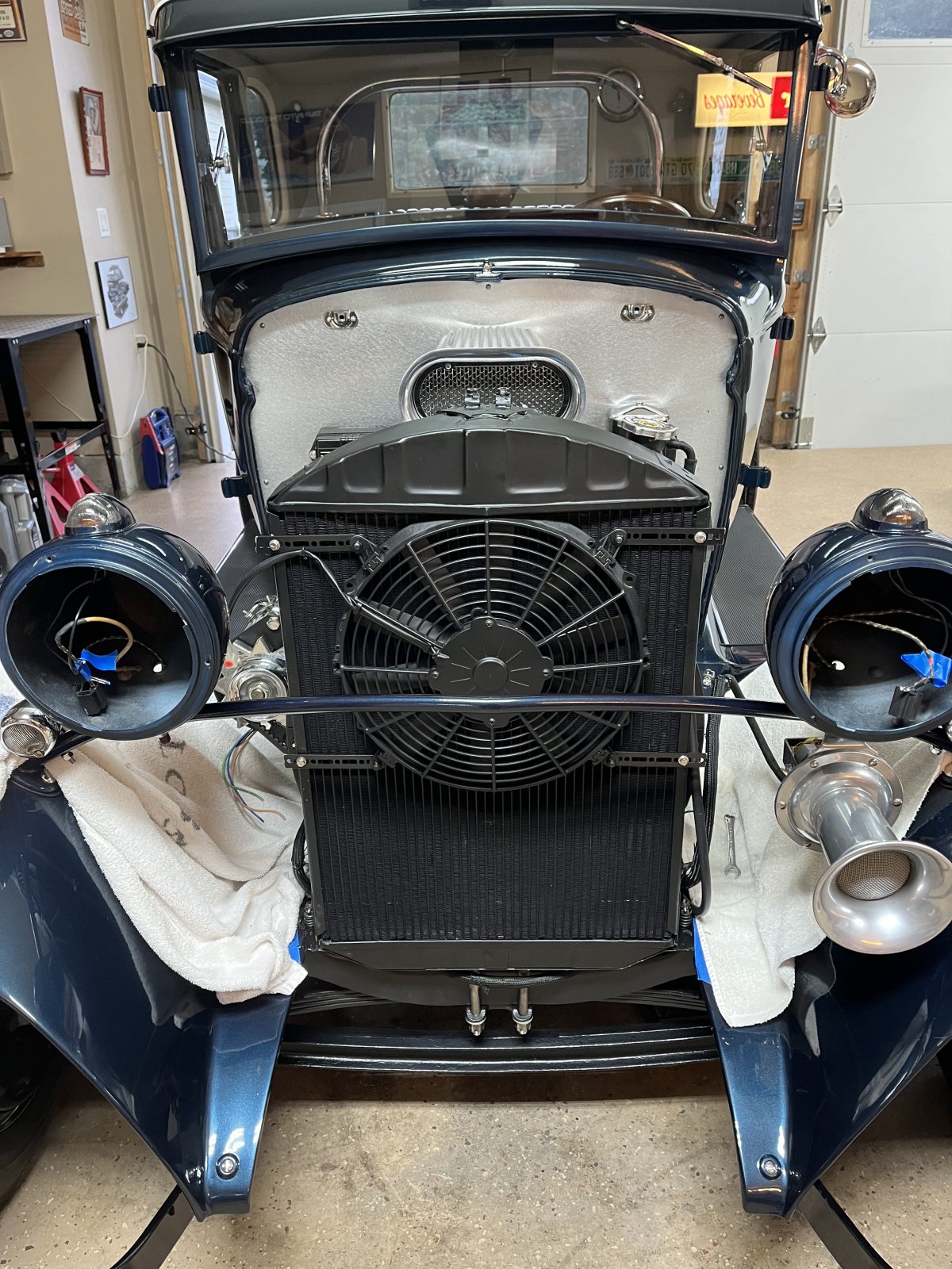

    I learned the main problem is the location of the mechanical fan , it's too low and too far from the radiator. No Mechanical fan would fix this issue. IMG_0053.jpeg IMG_0069.jpeg
    When i rebuilt this car i ***umed the cooling would work fine. This might be the reason it sat in a garage for over 40 years.
    I installed a 12" pusher fan made by Spal, they suggested a pusher style would work better because
    i am using a four row radiator. I noticed with the fan running some of the air was blowing back from the shroud so i removed the shroud. The car did great this weekend so far so good.
    I plan to change the thermostat to a high flow stat.

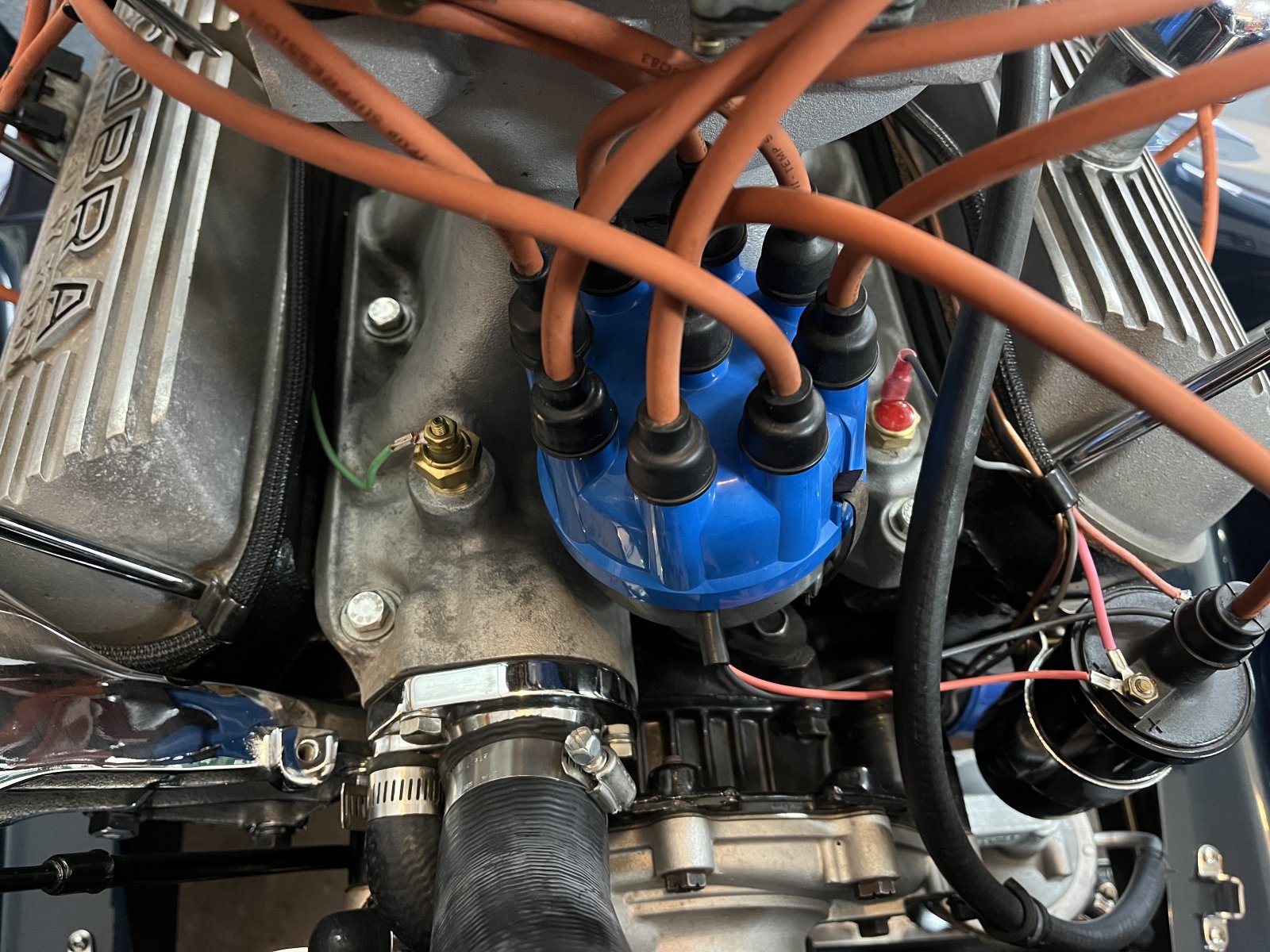

    I installed the sensor for the temperature gauge behind the thermostat and the sending unit for the fan is on the other side of the distributor. I am checking the surface temperature at both sensors with an infrared thermometer and they are always a little different . I don't know if it matters which location either sensor is in. I still have the mechanical fan. IMG_0080.jpeg
