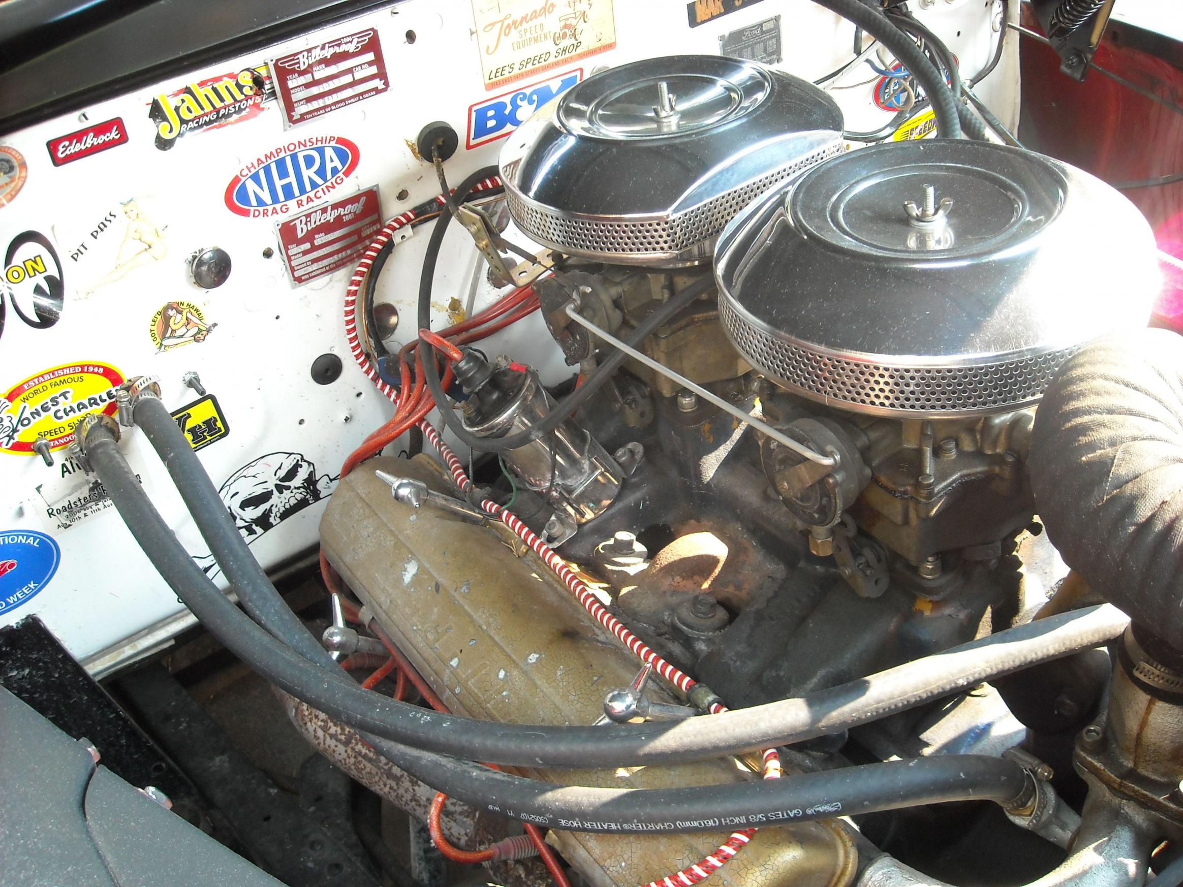

    Help guys before I start changing unnecessary parts.
    The loaded '50 Cad. engine in my '48 Ford dies when making a left turn from a dead stop. Not sure if it is flooding or starving. Don't smell fuel. Don't remember it doing it in a right turn. The only thing I can think of that I changed lately is the electric fuel pump. Not sure if it is a Holley red or blue.
    Throw out your ideas.
    Thanks Gary

    Okay guys this is a HOTROD engine and has a couple of mid '50s Cad. four barrel carbs. I have disconnected most of the auto choke stuff and added a manual cable. When I have a chance I am going to check all electrical connections and then get into the carbs. This is all good **** and I am grateful for all of it. Please keep it coming.
    Gary
