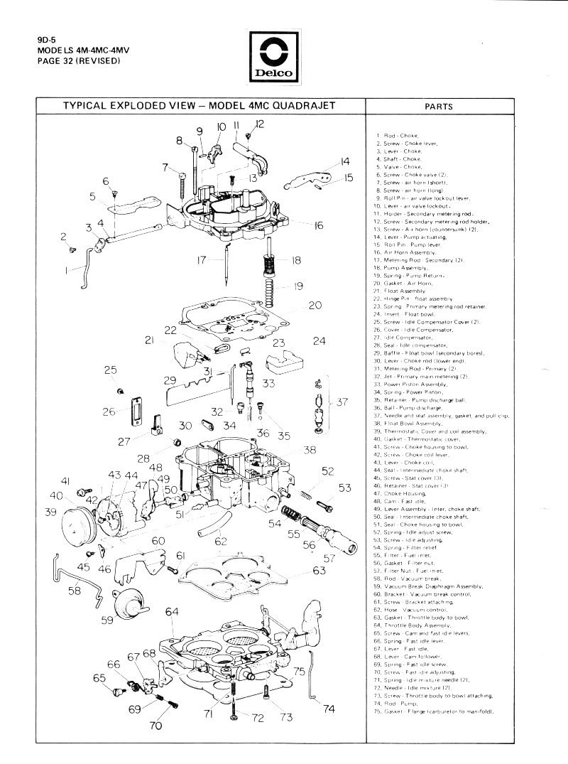

  19. ThePuck
    Joined: Apr 9, 2009
    Posts: 116
    ThePuck
    from Ottawa
    Part # 24 is the fuel baffle.
