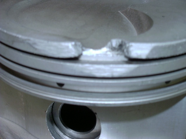

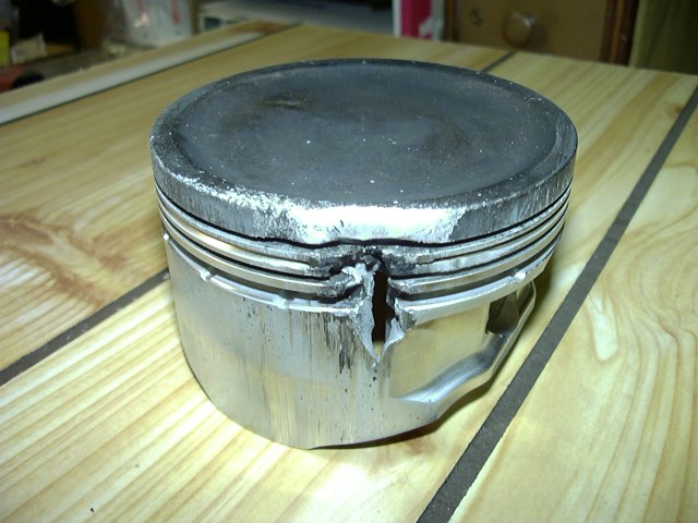

    Just drawing a conclusion from the photos would not buy into the "detonation" theory, just doesn't have the "right" look!
    List all the parts and clearances if you can?
    A 10.5:1 aluminum headed SB will run on 91 with no issues! May even run fine on 89!!! (Due to the heads and the "Ethanol" mix in the N.Y. pump gas)
    If they are the KB "hypers" and the (top) gaps are tight, that one photo of the piston with the top separated at the pin bosses, is exactly what happens and it happens in that rpm band you stated! This was mentioned above!
    Below are shots of some "detonated" pistons!
    Good luck with the "fix"!
    Thanks, Gary in N.Y.

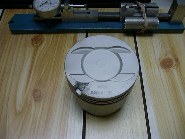

    Everything was fresh, the block was taken to 60 over and the new crank,rods,pistons as a kit. He said there was little downard s****e marks in the very top of the cylinder walls where it is black. It was only like the top 1/8 inch of the bore, but said that was indication of detonation too.
    That number two piston did have a break in a V shaped pattern on the side of the piston like that first picture.

    Can't tell you why but my opinion would be a piston let go first. To many other things to see but cant and looking at a picture its hard to read every thing just right. Plugs are not lean so I cant say its detionation. Any way you look at it you need to study all the other things and never throw a distributon in and only test it to 3000. Sorry you had the loss and I hate to see a destroyed motor especially a fresh built. Good luck on your nrxt one and please pay attention to the little things.

    Maybe it's the picture but that piston pin looks to short?

    • The Hypereutectic pistons do not have ANY reserve strength if you are going to get into detonation. As was said, we have all seen plenty with the bottoms of the pin bosses pulled out and the block get sawed.
    • If it was detonating, the upper rod bearings with show it, as would the "pepper specks" on the spark plug insulators as was mentioned.

    The piston laying in the valley...could you take a good picture of the bottom looking at the pin tower, and another picture from the side at the ringland Intake pocket side...???
    This is what is going to tell the most from the info you have given so far...

  17. Phil I'm not buying the detonation excuse either.
    The tops of the pistons as well as what's left of the plugs look fairly normal, a tad lean, but fine none the less.
    I'm also not buying the ring gap because the cylinder walls just aren't showing it.
    When Oddy's did my first build, Billy put the Kieth Black Hyper pistons in and I had no problems. In fact when I had Oddy's redo the engine, for more power, I sold that rotating ***embly and the tops of the pistons didn't look too much different than yours. If anything my pistons were a little darker on top.
    I'd say that your problem lies with either a defective piston or too tight of piston pin. What ever happend... happened at the piston pin point of the piston.
    Either way your engine builder should step up to the plate and go to bat for you.
    Because it's not detonation!

  23. The rest of the engine really needs to be gone over to try to locate the cause. I'm not seeing detonation, but a failure in the pin boss of the piston. Maybe the pin clearance was wrong - has to be something to cause that piston failure. Hopefully your bilder will step up and work with you to resolve it. Hope you find the issue.

    i'm sure it's not detonation
    if press fit pins/rods could piston been damaged during ***embly???
    piston siezed in bore due to?>breaking piston &cly wall
    core shift in block causing failure/thin cly wall

    if it was detonation that bashed that piston to death there will be some hammer marks on the topsides of the rod bearing too.
    I'm 99.5% sure that detonation did not kill that motor.

    Kind of a guess on my part, but maybe things got way lean, combined with possibly too much advance, things got "way hot way fast" in your 1/8th mile run, stuck a ring/piston and carnage....
    I don't know why, but I look at that and I just think really hot pistons, The carbonization of the pistons near the intake valves might support my position, (fresh fuel/air hitting really, really hot piston tops causing pre-ignition even before compression.)
    I think maybe for things to get that hot that fast, there has to be a lean condition.
