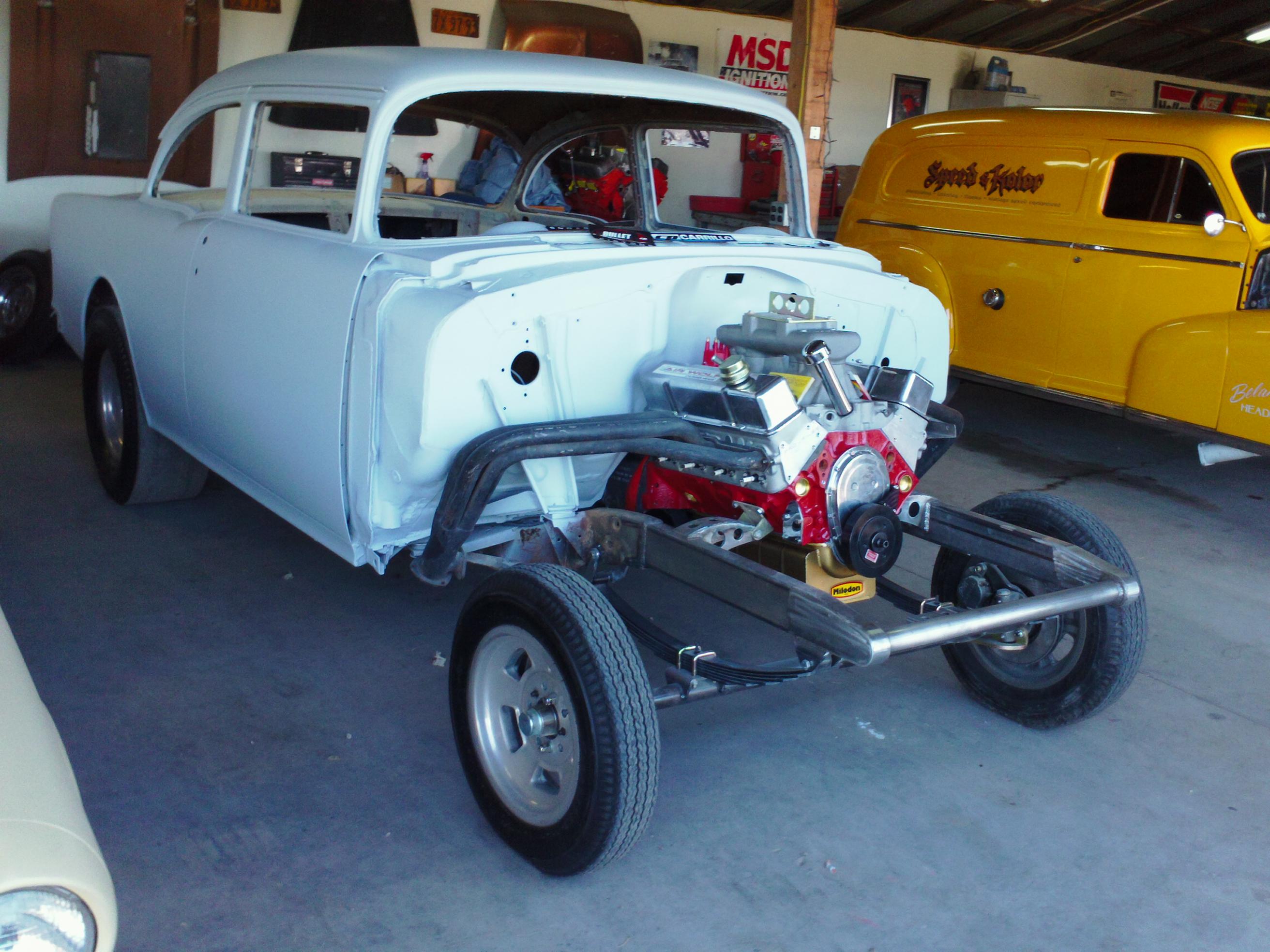

  3. Yep, its a truck block, which is why they ARE better than a production 350. Many aftermarket blocks have siamesed cyl's because it makes a stronger cyl. wall and ties the whole block together better. With a 5.7 rod, the rod ratio is 1.425, a 632 big block is 1.410 and people build them all the time. With a 6.0 rod, you get a 1.600 rod ratio, and a 350 is 1.638. The two bolt blocks are stronger in the main webs because the outer main bolts on a four bolt, go right through the weakest part of the web. Our current '56 engine has a '76 "817" block which many would say is one of the lesser of the casting #'s. At .040 over (4.165) it is .160-.180 thick on the minor thrust side, and .200-.217 thick on the major thrust. Its .150ish in a couple spots at 2,5,7,&10 oclock but its .400+ thick at the siamese, so much for the "817" myth. Many aftermarket alumimum blocks come with only .125-.150 thick sleeves in them, and they move all over the place. Cubic inches are the quickest/cheapest way to increased power/tq, and the bigger bore always lets the heads breath better. As already said one of the main problems is guys build 400's that actually make power in the 6000-6800 range, but regulary turn them 8000 rpm and swear they pull/make power to that rpm.
    The engine we built for my sisters car makes peak power at 5800! We build another last year with a .030 production "509" two bolt, **** econo 4340 forged crank, our new 6.0" Bullet/Carrillo rods, 10.6:1 Bullet piston kit, Isky 246@ .050/.625 lift Hyd. Roller with the fantastic Morel lifters, a very nice Milodon "Box" pan with a full kick out, Gasser Round up 10-5-12 094.jpg Air Wolf 230's that flow 350 cfm, single 850 GoldClaw Holley on a ported Weiand tunnel ram. Made 636HP @ 6600rpm & 580 lb.ft. @5100 rpm, on ****py California 91 octane unleaded "peemium". I know for certain the average guy out there, would put way to much gear against this engine, try to turn it 8000+, and kill it in no time. Here is a pic of that engine.
